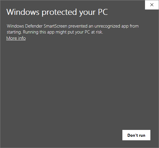

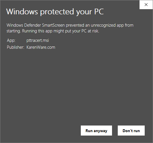

The messages says you do not have Admin (and UAC approval) to install programs.
W10 added a extra level of security in a recent update and blocks any program that has not obtained 'approval' (which is not free ).
Instead of clicking exit (or whatever it really says), there is a (sneaky) 'advanced' link on the Left at the same level. That is where you can whitelist Calibre.
Hint: there is afairly recent MR post somewhere that has the images of the screen that I can't quickly put a link to.

I'd tend to disagree. It doesn't sound like SmartScreen blocking the install which would catch the install before it started. Instead, my guess would be that the installer either did not have administrator rights or the Start Menu folder has ACL issues.
I've attached a couple of images from a SmartScreen installation popup and the click on more info button.

Thanks for posting those screen shots. (I add new stuff so rarely, that it may be months before I would see that screen.
And, Yes, I agree with your diagnosis. Something is wrong with rights or permissions. A locked down, Corporate Computer?
