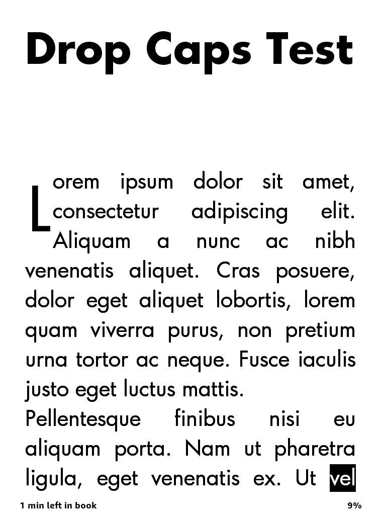

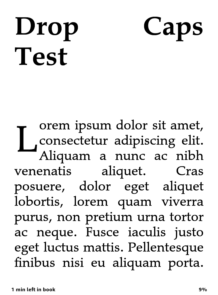

Paperwhite/voyage..
As I expected, due to long years of doing this and the frustration of drops, this is not working particularly well in the Paperwhite family of devices. I'm a bit swamped, today, but I'll get some screenshots, and while I'm at it, I'll test it on the new F10, too.
But, if you've seen Drop attempts on a PPW device before, you've seen this. Nothing, unfortunately, new. :-(

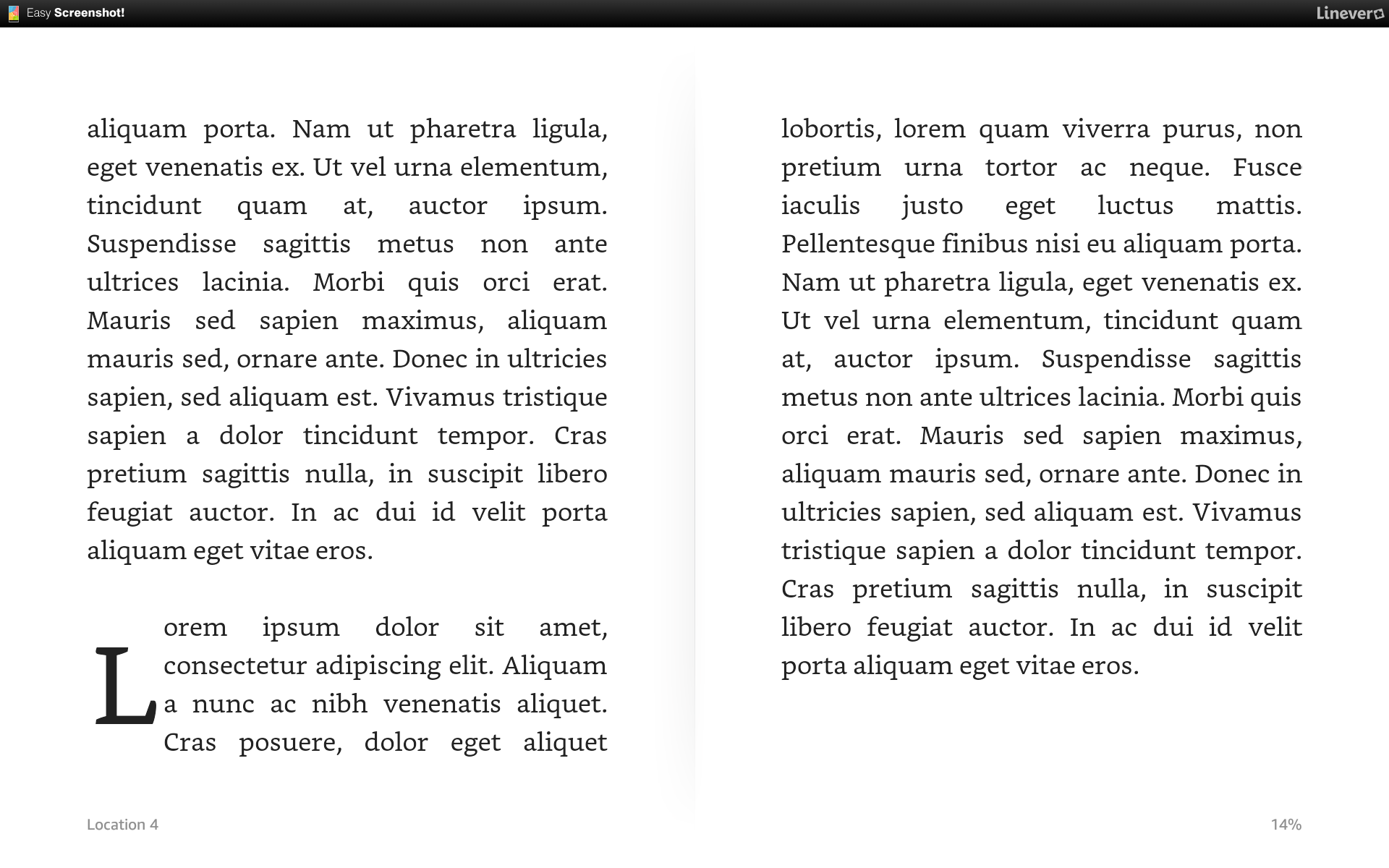

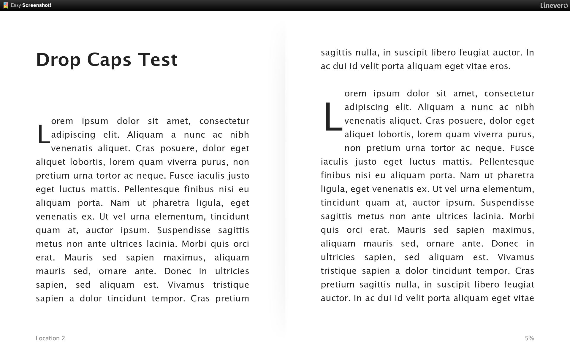

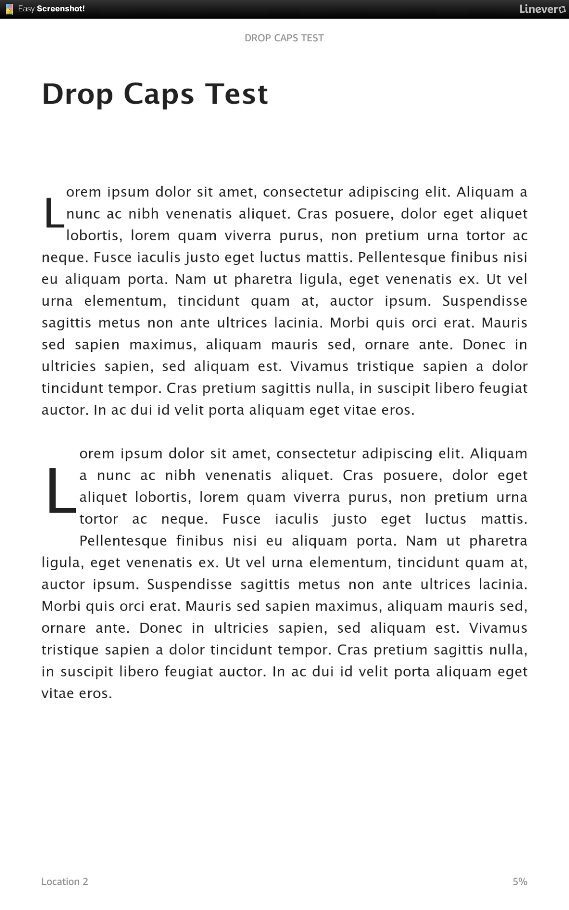

Screenshots of tests...
Hi, guys:
Ok, to recap, I built the MOBI from the provided ePUB, using KP3.xx. I then loaded the resulting MOBI file onto my PPW and my KFire 10", figuring that covered a range of ages and advancement of devices. Attached are the relevant screenshots; the single screen, somewhat normal-sized, is the PPW, with various fonts, etc.; the two-page/screen view and the long portrait view is my Fire 10".
The screenshots speak for themselves. This solution, in my opinion, is not viable for the MOBI environment, at least, not more so than what most of us already do.
Hitch
