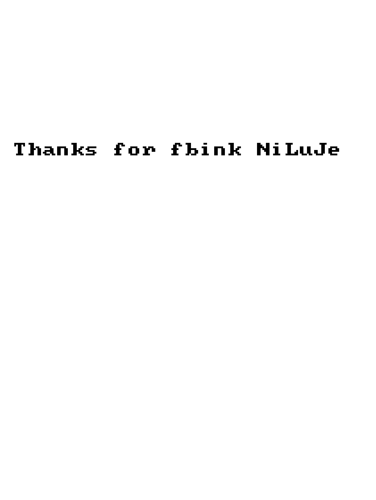

I copied the example text in the fbink thread since I don't know what I'm doing . That did indeed work just fine
[root@kindle root]# fbink -c -p -m -y 10 -S 6 "Thanks for fbink NiLuJe"
[FBInk] Variable fb info: 1264x1680, 8bpp @ rotation: 0
[FBInk] Fontsize set to 48x48.
[FBInk] Line length: 26 cols, Page size: 35 rows.
[FBInk] Fixed fb info: smem_len 4587520, line_length 1280
[FBInk] Enabled Kindle Oasis 2 device quirks
[FBInk] Kernel's HZ value appears to be 100
Printing string 'Thanks for fbink NiLuJe' @ column 0, row 10 (inverted: false, flashing: false, centered: true, left padded: true, clear screen: true, font scaling: x6)
[root@kindle root]#
Where should that strace file be placed on the kindle, because /mnt/us/ directory did not appear to be the answer. Should it be replacing the one in the usbnet directory?

@7hir7een: You can basically put it anywhere, as long as you call that one, and not USBNet's.
I usually put those kind of testing things in root's $HOME, since it's a tmpfs, but in this specific case, replacing USBNet's binary is a good idea, since that one is mostly broken on the KOA2 anyway . And then you can just call "strace" since USBNet's one is in your PATH .
EDIT: Just to be perfectly clear: you did get to see that string printed on your screen, right? ^^. That'd be a good news, since KOReader should mostly do the same thing...
EDIT²: Err, of course, you have to unpack the tarball, first . tar xvzf strace-koa2.tar.gz .

And yes, the text did print on the screen (screenshot attached)
