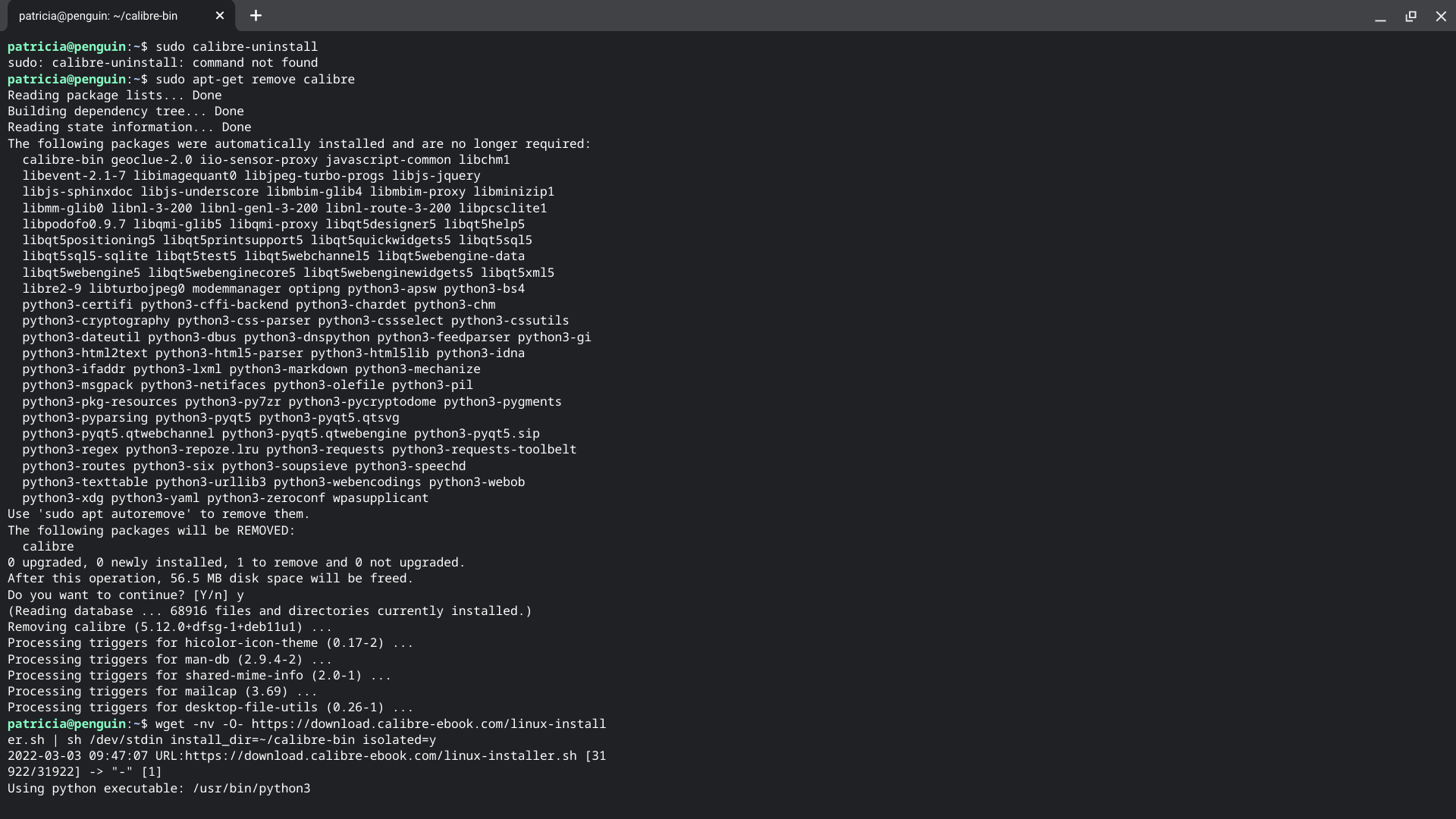

I looked again at the CLI options so I renamed my calibre library, uninstalled 5.12 (debian rep) and installed the isolated variant of calibre (also 5.12)
I had to install calibre from the calibre-bin file as I do not have root from linux terminal (whoami returns patricia)
Calibre partly installed, no icon in the linux tray. I opened with cli command, and pinned it to the tray when it opened.
Closed and reopened with an error.
[Errno 111] Connection refused
Why did the 5.12 download?
Name:	Screenshot 2022-03-03 09.53.53.png

Where is the sudo part of the installer?
In chromeOS linux installs as a VM within a container. However it works, the effect on terminal is that whoami returns my username not root.
I may need to find a way to install linux in dual boot so that complex programs like calibre can work properly. If debian updates its calibre repo that works fine.
I think I understand why 5.12 installed when I tried the isolated install by CLI - there was an instance of calibre remaining after uninstalling the debian version.
