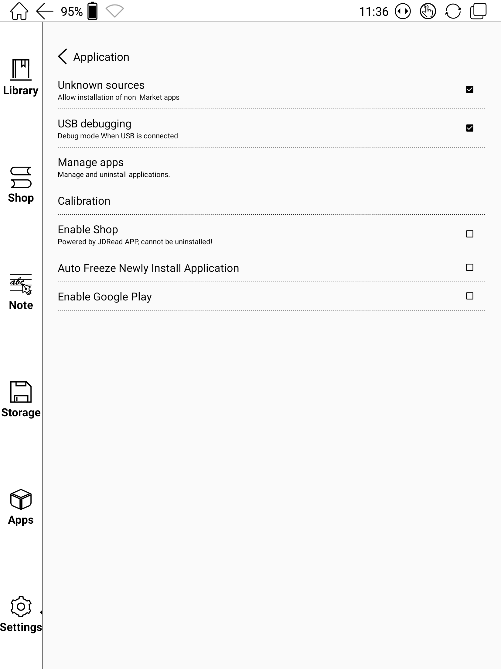

USB debugging on Note Pro is normally under Settings/Application/USB debugging.

Originally Posted by anarcat View Post
That's the part I'm missing: how do I enable debug mode on the device? I couldn't find it in the settings.
My configuration.
