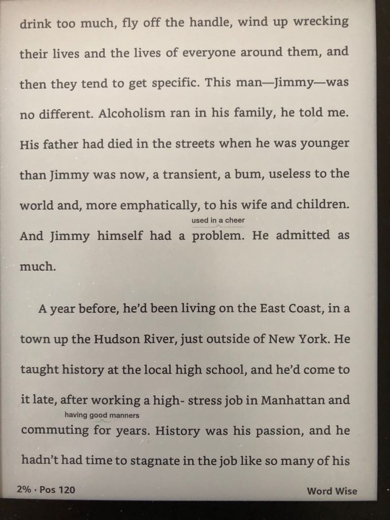

Hi:
I've used your program to generate word wise information, but I've a problem. When I transfer the files to the device, the words are not correct. Could be a problem related with the dictionary. Which one should be used?
See enclosed picture
I've realized that word wise information is using the first Engish dictionary charged in the device independiently of the English dictionary selected for this language. The English dictionary selected is the one used for other word no selected in word wise.

Originally Posted by Shark69 View Post
Hi:
In the code I see the dictionary you use to construct senses.csv is related with devices sold in USA, UK, Canada and Australia.
As my device was sold in Spain, perhaps I haven't installed the needed dictionaty.
Which is this dictionary? How do you create senses.csv file?
Shark69 is offline   Reply With Quote

Problem solved. I was using azw3 files and the scripts only accept mobi files.
Thanks
