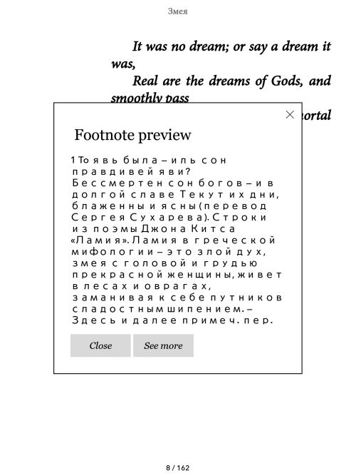

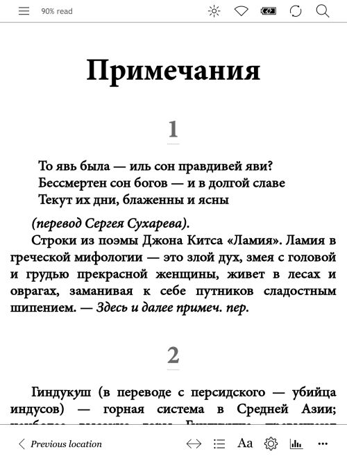

Here are 2 screenshots. First is the pop-up footnote, second is a view of the full footnote via the 'See more' button on the pop-up.
BTW, I know it's normal to lose all the footnote formatting when popped-up but I don't know why the Cyrillic letter-spacing is so wide. Pop-ups in my English books have normal letter-spacing.
It's because of the fonts:
KBJ-TsukuMinPr6N-RB.ttf
KBJ-UDKakugoPr6N-M.ttf
If you remove them, the interval will become normal.
