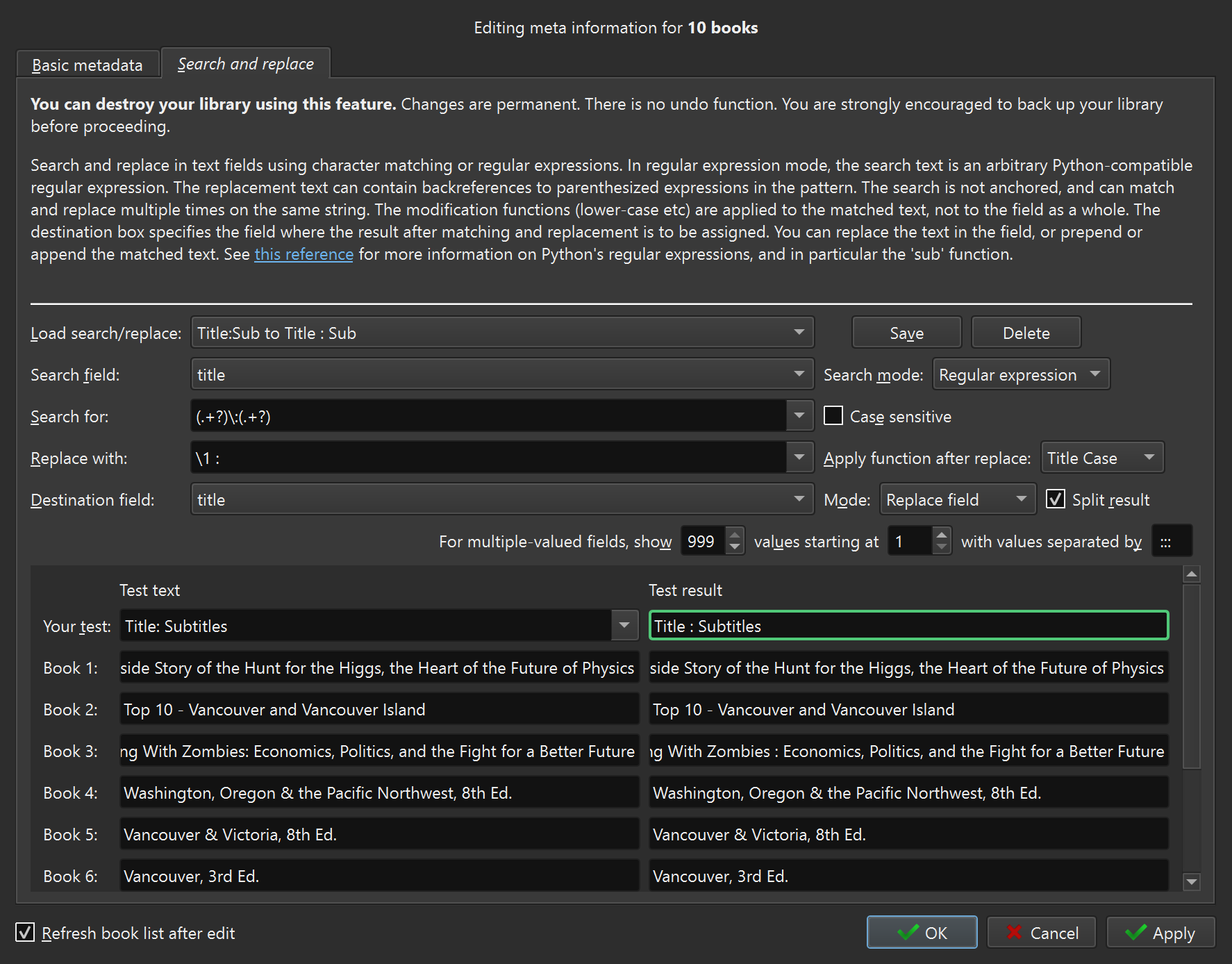

If to want to split and insert., You need a capture for ALL the pieces so yo keep them. (There are more complicated non-capture ways. this works for me)
(.+?)\:(.+?) <<remove existing colon
\1 \2: <<place something at the end
Want to discard part 1? just don't place it back
\2:

The removal of the existing colon, as you suggested, and replacing with what I prefer (space on both sides of the colon) worked.
To spell it out for anyone else interested, see the attached screen capture.
However, any existing
Title : Subtitle will get an additional space before the colon and becomes
Title__: Subtitle
(I use underscore since two spaces will get weeded to one by this editor)
The solution would be to first do a run converting any existing Title_:_Subtitle to Title:_Subtitle and then convert all to the desired outcome.
Many thanks theducks for the efforts !!!

The the following will do what you want:
(.*?)\s*\:\s*(.*?)
And the replace is simply:
\1 : \2
If there are multiple spaces around the colon, it will remove all except one, but,
(.*?)\s*\:\s*(.*?)
\1 : \2
This is very elegant - many thanks for that!
