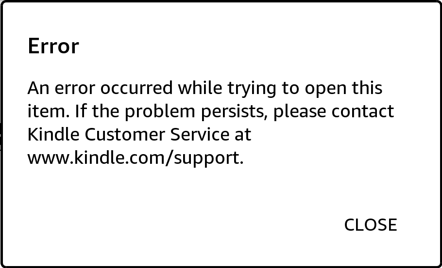

From time to time, KUAL give 2 errors at start:
(nothing new, it's in the FAQ)
and after that, one more:
Giving CLOSE and CANCEL, I saved my KV from restarting and got KUAL to start. After the 2nd error KUAL starts.
Once started, I can start it again later, without any problem, but... in a while, the error(s) show up again.
I've used Purge menu cache, but no help. Sooner or later, the error is UP.
It's a known behave, as I've seen.
