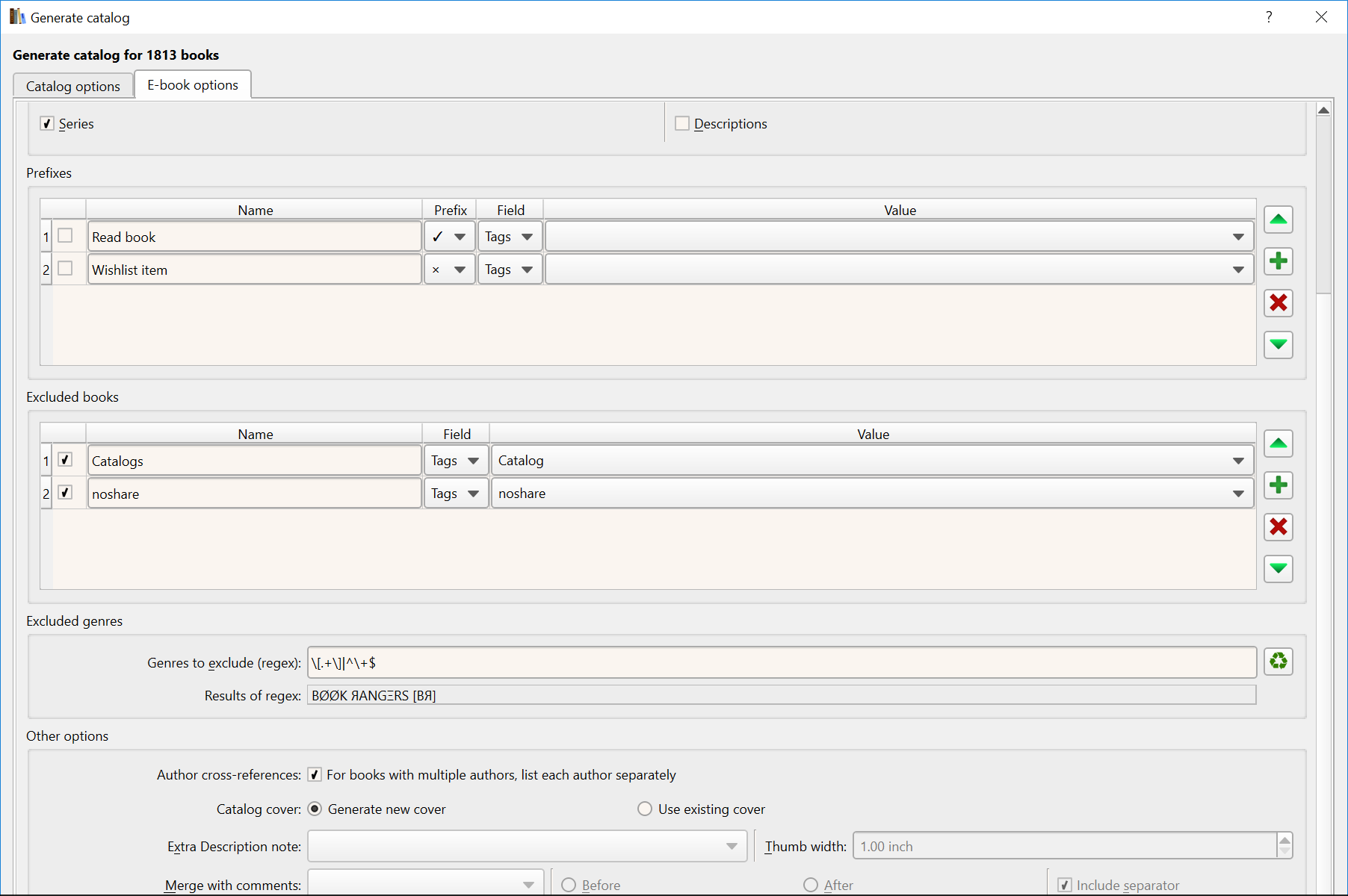

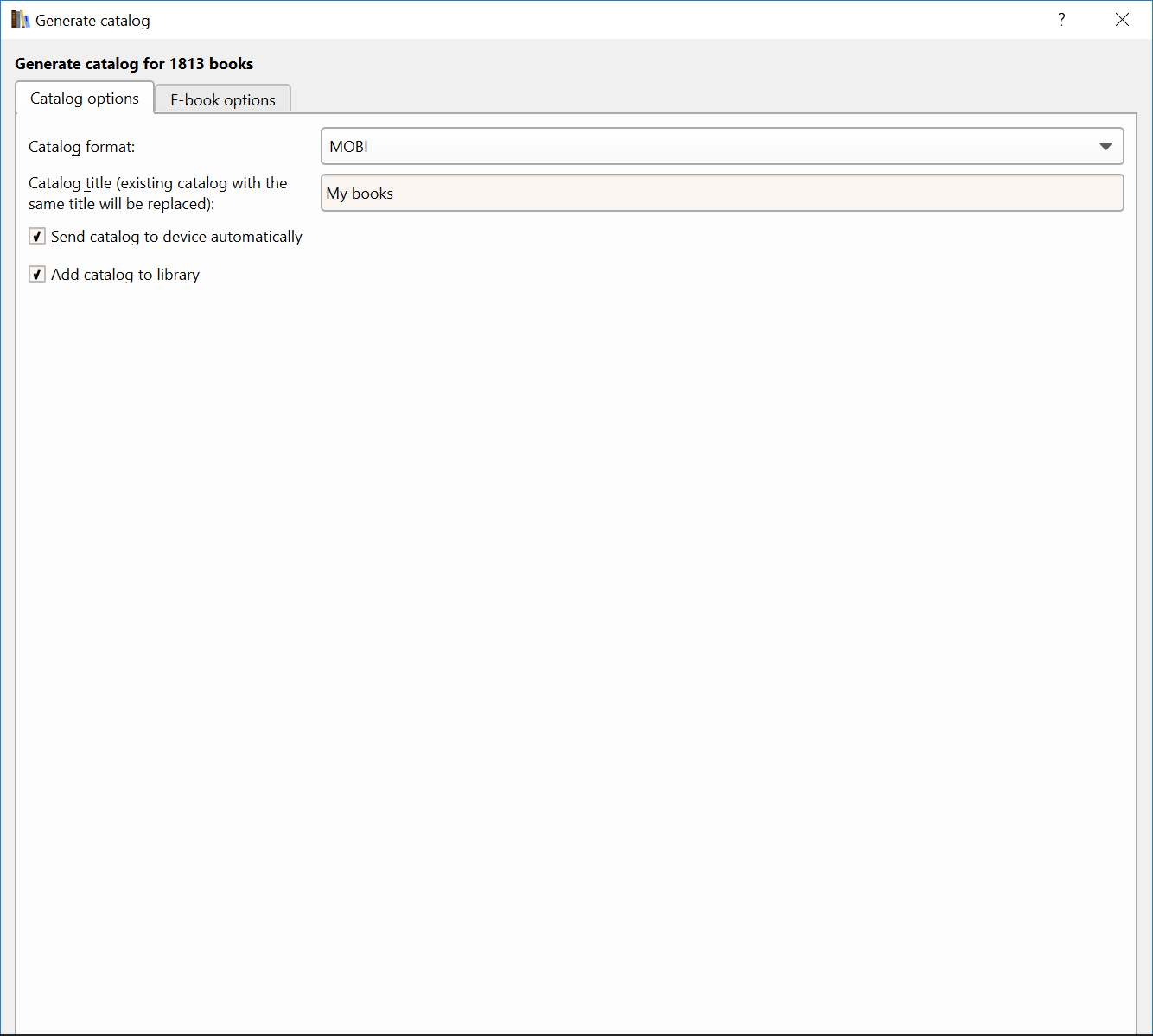

OK, 3.14 installed. Data imported. Same result. I can resize various windows, horizontal and vertical, and move them around. But, for the catalog option window I can only resize the width, within small range, but can't resize the height, or move the window. The E-book options window is the same. I can change the options for format to mobi, and that gives me a scroll bar, but I can't scroll to the bottom to complete and save.
As requested previously, I am attaching screenshots.

Looks like the window has been stretched so it doesn't need a vertical scroll bar, and then the bottom edge of the window has been pushed (via moving the window) beyond the bottom edge of the monitor.
Try pushing the top edge down (i.e to make the window shorter), the scroll should appear, then move the top edge of the window up towards the top edge of monitor.

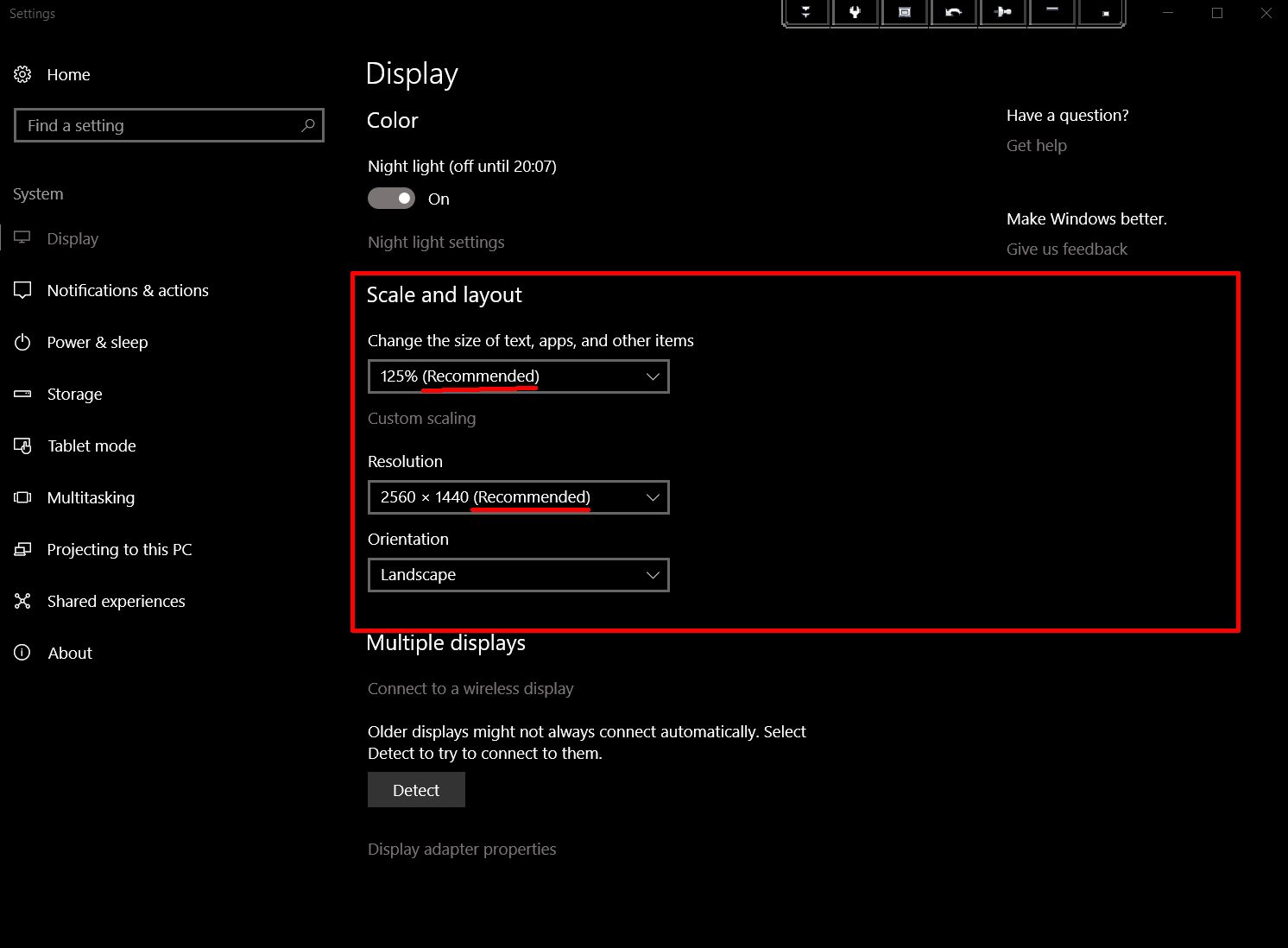

  • If you reduce the size of Preferences->Look and Feel->Interface font to something significantly smaller (like Segoe 9pt) you might be able to resize/move it into a state when you can regain control in your preferred interface font.
  • Did we try stopping calibre, then renaming gui.json to something like gui.json.save, and then restarting calibre -- gui.json is where the screen geometry settings are kept.
  • Are the Windows screen layout settings set to Recommended
