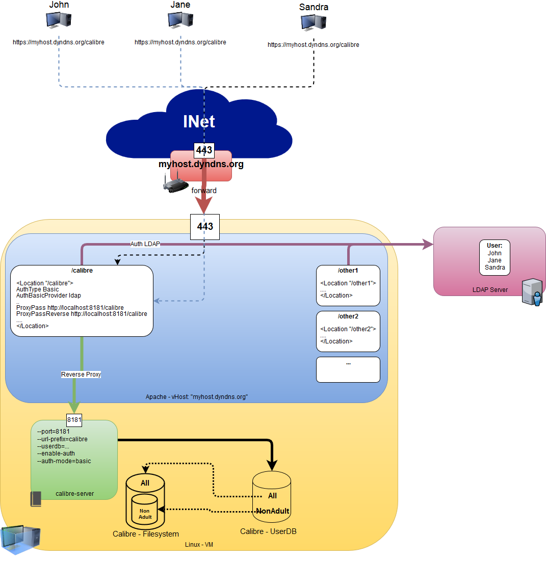

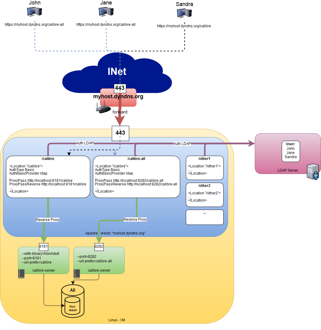

What I'm trying to do is to achieve the same (or similar) behaviour that worked in V2 with the architecture changes you made with V3. So I HAVE to descibre what I have now with V2 as this is exactly what I'm trying to do in V3.
Perhaps some pictures will clear things up. In the attachments in "calibre-V2.png" you find the architecure I implemented with calibre-server V2.
As you can see, I have with V2:
  • An Apache vHost with many Locations (not just calibre), each using BasicAuth ldap
Concerning calibre:
  • 2 different Locations:
    • /calibre, which ends up in a (lets say) "NonAdult" virt.lib.
    • /calibre-all, which ends up in the whole lib.
  • This could be realized because calibre-server can be startet multiple times with different "--url-prefix" / "--port" and "--with-lib".
  • To the Apache Location "/calibre-all" just some users have access (lets say "John" and "Jane", but NOT "Sandra").
  • To the Apache Location "/calibre" (which serves the virt.lib "NonAdult") the users "John", "Jane" and additionally "Sandra" have access.
Now I want the same in V3, nothing more, nothing less.
For the following descriptions look in the attachments at "calibre-V3.png":
As you can see here, just one calibre-server can be started, as u restricted that and thefore the "--virt-lib" option doesn't make sense of course.
What is more: because of the need of "--url-prefix" it isn't possible any longer to have different Apache-Locations ReverseProxying now the only calibre-server as the "Location" directive in Apache has to match the "--url-prefix" Option in calibre, otherwise calibre builds the wrong URLs.
And so I can just have one Apache Location "/calibre" to which all LDAP Users ("John", "Jane" and "Sandra") now have to have access. With V2 this was the point where I could control / restrict access.
But how can access now be restricted for "Sandra" to the "NonAdult" Virt.Lib like before in V2?
In V3 this can just be achieved with enabling the calibre-auth and - in the new userdb - mapping users to virt.libs.
In my example u can see two (technical) users in the calibre-userdb. "All", which is not restriced, and "NonAdult" which is restricted to the virt.lib. "NonAdult". (To be exact: a SearchString filtering out Books with concerning tags)
BUT: This implementation does not work at all because of the two BasiceAuths (Apache + calibre) following each other, which leads me to your next statement:

Will try again to describe in more detail, why this can't work (look at image "calibre-V3.png"):
  1. Browser requests https://myhost.dyndns.org/calibre
  2. Apache wants to have valid LDAP credentials (first basic auth)
  3. User enters valid LDAP credentials (User: "John"), Apache accepts them
  4. ApacheProxy forwards the request to calibre
  5. Calibre wants to have valid calibre-credentials (second basic auth)
  6. User enters calibre credentials (User: "All") (BTW:ugly, entering different credentials two times)
  7. Calibre accepts the credentials
  8. CalibreWebFrontend in the Browser requests more content (images, js, css, XHR...)
  9. Now the important point: Therefore the Browser has again to send AuthHeaders with each following request. But which one? The first (from the ApacheAuth)? Or the second (from the CalibreAuth)? The browser decides the first, the Apache Ones (User: "John")
  10. Calibre gets the AuthHeader with the Apache Credentials (User: "John", NOT User "All")
  11. Calibre send a 401 - Access denied for each following request.
So again my question:
How would u build this scenario in V3 (Basic auth enabled Apache as Proxy and calibre with restricted virtual - libs)?

But therefore, the "--url-prefix" option in calibre had to be removed and calibre had to determine the prefix automatically.
snoopy_1978 is offline   Reply With Quote
Old 06-26-2017, 12:52 PM   #29
snoopy_1978
snoopy_1978 began at the beginning.
Posts: 12
Join Date: Jun 2017
Device: Android
Oh and since the calibre server supports digest authentication with the MD5-SESS algorithm, not just basic, it cannot store hashed passwords.
In this case (even if I would know them) I would NEVER EVER sync productive User/Passwords (which are used as Single-Sign-On in other Services) from an LDAP to the calibre UserDB. If this sqlite database gets stolen somehow... don't want to think further...
