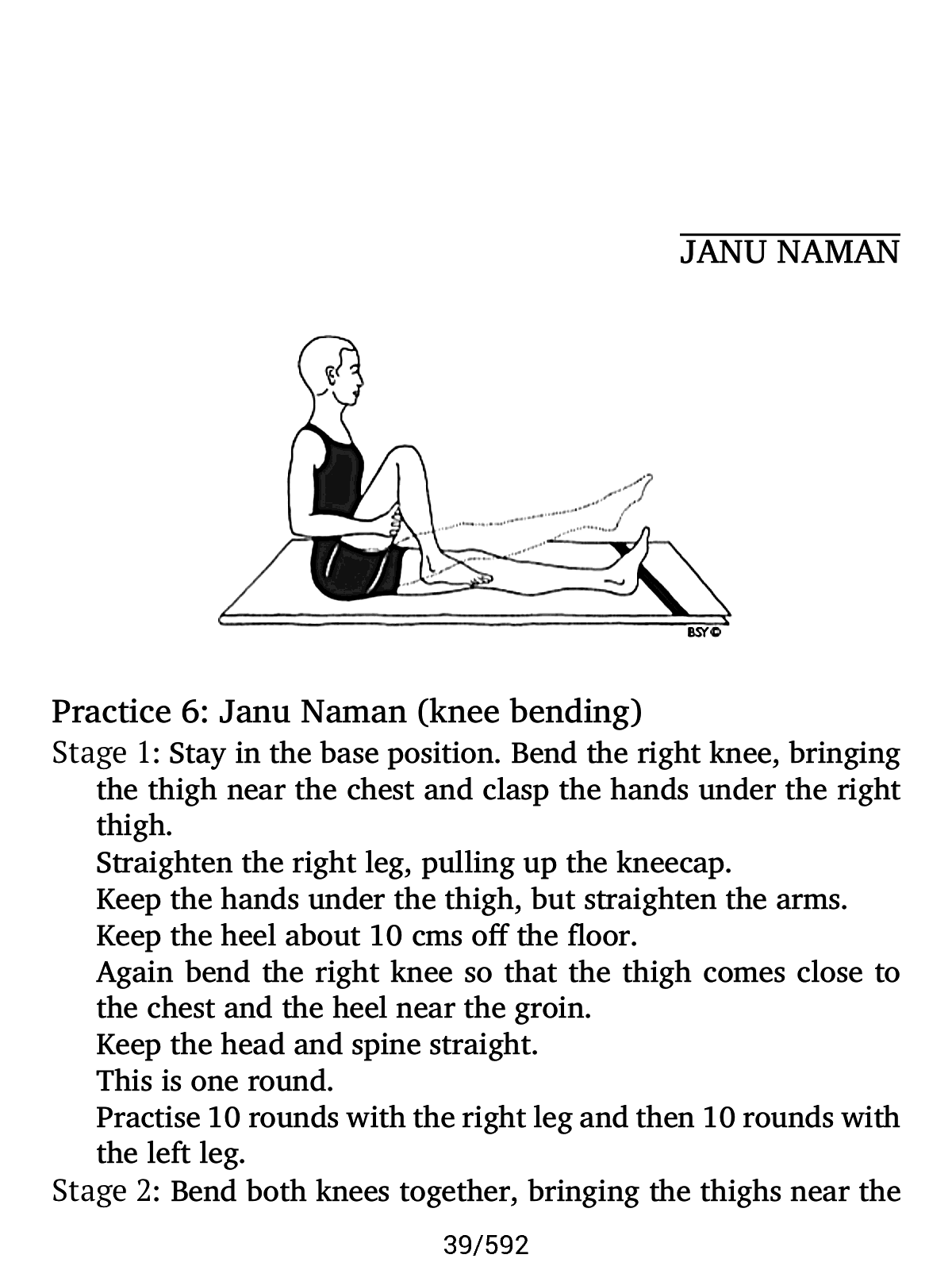

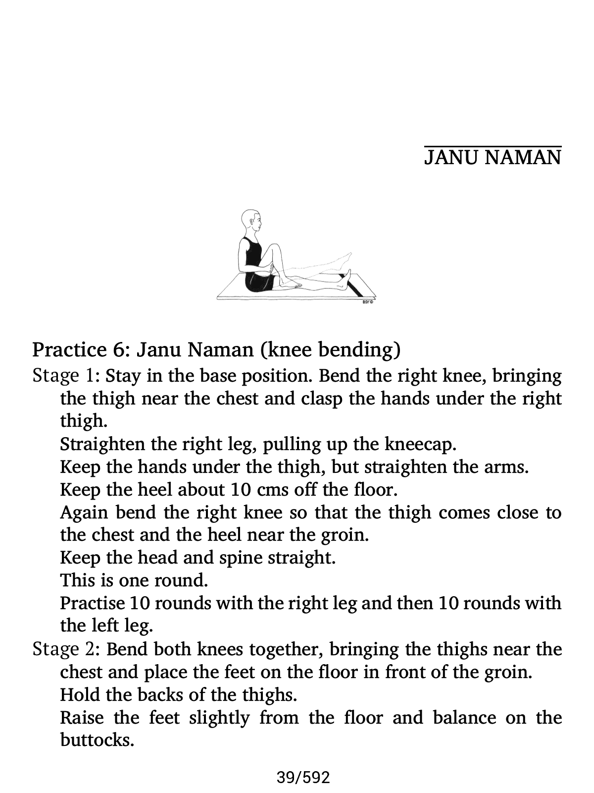

To illustrate original look of the page and when I double the dimension manually I am attaching two files.
ID:	157082   Click image for larger version
