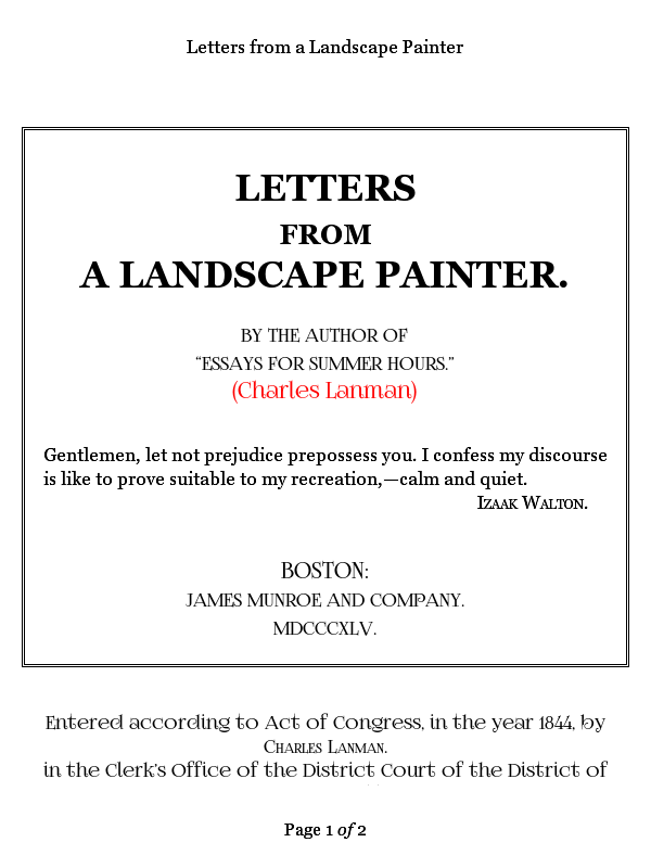

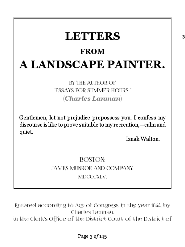

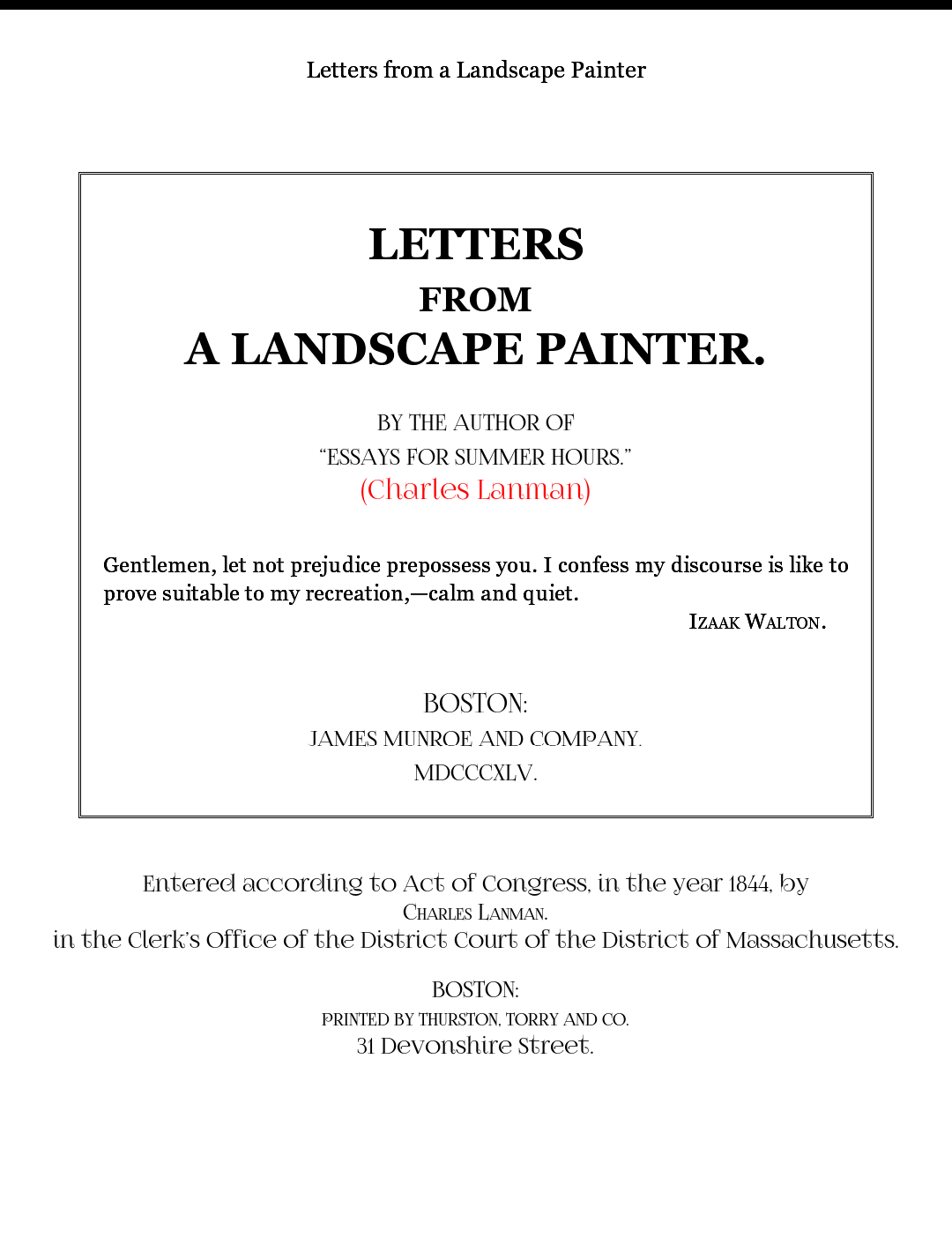

I have had a look at the books you sent the link for and loaded them on my Aura H2O and Touch. The fonts seem to be loading correctly and the styles seem to be working. I have attached screenshots to show this. The screenshots are of the title page. This has a lot of formatting and and several lines using your font. There is one each of the epub and kepub on the Touch, and the kepub on the Aura H2O.
Looking at the screenshots from the Touch, there are differences, but the formatting seems to be there and the font is in use. Flicking through the rest of the book, I can't see any other problems
What is missing, is the italics for your font. These show in the calibre viewer and editor, but not on the device. The only reason I can see for that is that I don't think the font includes italics. I assume the renderer used by calibre has the ability to produce the italics but the device doesn't. Either that, or I have the italic version on my laptop, but I can't see it.
Now, I started doing this with the Aura H2O and went to the Touch after checking what device you had. There shouldn't be any differences, but I had to check. When I first opened it the Touch, your fonts didn't show. But, I had been using Georgia as the selected font. When I changed it to "Publisher Default", it was used. This is what I expected. Are you selecting "Publisher Default" when reading the book?
ID:	154143   Click image for larger version
ID:	154144   Click image for larger version

Of your screenshots, the font appears in the first and third one, in the headings. Does it also appear in the <p> classes, that I had assigned the font to?
Edit: I just see that in the second image, the font appears as well, but only in the subheadings, not at the author's name.

OK, then I suspect it is working as designed. Selecting a specific font on the device overrides all fonts specified in the book.
Strange only that my font also vanishes when I add the book to the "My Digital Editions" folder and read it on the Kobo desktop.
Sorry, but there is a contradiction there. The "My Digital Editions" folder is for ADE. The Kobo desktop doesn't look there. It has it's own directory with books in it. But, as far as I can tell, the Kobo Desktop doesn't let you add books. It seems to only show books downloaded from the Kobo server.
The only styles that specifies the font are "h2", ".center" and ".tbcenter". There are no h2's on that page. The "By the author of" uses a p with ".center" and "BOSTON" is a pa with ".tbcenter". These styles are working on other pages.
The author name is bold tags with an class specifying italics. My guess is that the Adobe RMSDK renderer is using bold italics in a different font because these are not available in the specified font. That's what the second image, Touch-epub-Letters-TitlePage.png, shows. The renderer used for kepubs seems to have decided in favour of the font over italics for the same text.
The other difference between the renderers is what jackie_w mentioned. For kepubs, all fonts in the book are overridden when you select a specific font on the device. For epubs, only some of the fonts are overriden. And as jackie_w mentioned, there is a patch to change this behaviour.
