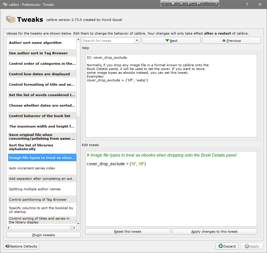

@stumped - and, you'll probably want to keep the original image as it is before altering it with the Generate Cover PI, problem is where to keep it, ideally you'd want it in the book folder so that it doesn't get lost.
One way to do that is to convert it another image format that can be dropped into the book details panel. But there's a Catch-22, when a common image format file (jpeg/jpg, tiff, png, webp, bmp etc) is dropped into the Book Details panel Calibre will treat as a replacement cover. So you either need to convert to a really oddball format like JNG, or exclude a format via Preferences->Tweaks viz:

@stumped - and, you'll probably want to keep the original image as it is before altering it with the Generate Cover PI, problem is where to keep it, ideally you'd want it in the book folder so that it doesn't get lost. ...
The easiest way to keep the original covers for each of the pieces is to keep a copy of the complete unaltered omnibus in the library as an additional book. That way there are no problems with calibre "cleaning house" when some alteration is made to one of the single book entries.

@theducks - but if you add the JNG (or TIF if it's in the exclusion list) properly, i.e. by dropping it into the book details, or the Formats box in MDE, or via Add Books->Add files to selected book records there won't be any extra files. Extra/missing files only come about when one adds, renames, or removes library files and folders outside of calibre.
Calibre will retain any file type in a book folder, providing it is told about it when it's put there, including when a book's title or author is changed, or the book is copied or moved to another library and so on and so forth, etc.
But I know you know all that, I think many folks don't realise that calibre will store and retain anything in a book folder. I keep the bat and cmd files to start the server and browser for each library in a Book titled !Server by !Admin in the library
