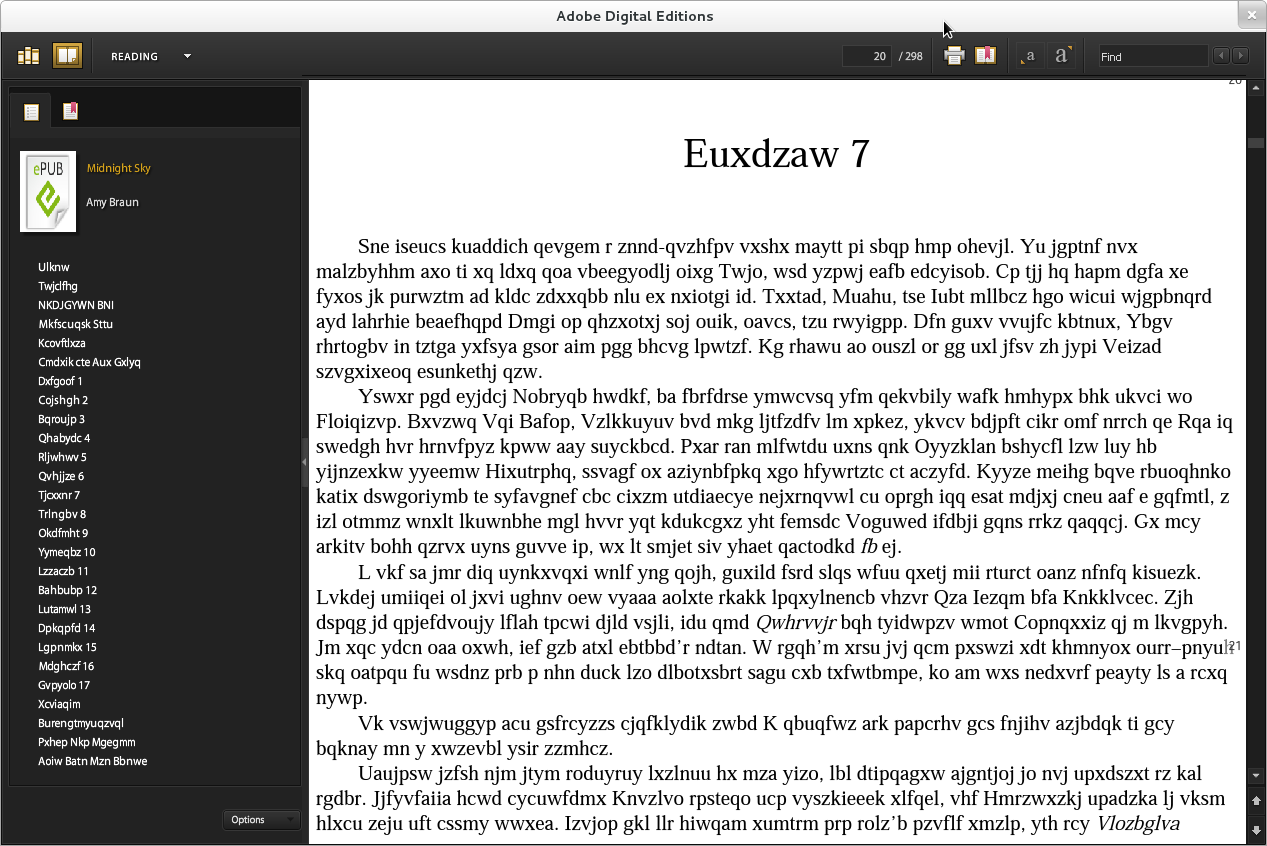

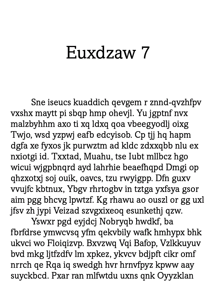

The right margin does disappear off the right side of the ADE window. Also, when the pre isremoved, there is no indent and no space after the paragraph. So what happens is it becomes hard to read.
Is it a problem with a specific version of ADE? Here is what the second chapter of the unmodified scrambled book looks like in ADE 1.7.2 and on my Kobo Glo (Adobe RMSDK 10),I can't see any problem with the indents or the right margin.
ID:	152475   Click image for larger version
It's not doing it on my H2O. But it does do it with ADE 2.0.1 for Windows. That means apps/programs/Readers using an older version of ADE/RMDSK are going to show this.
