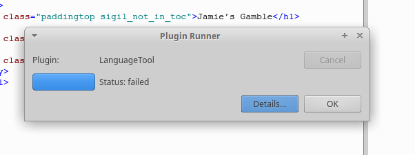

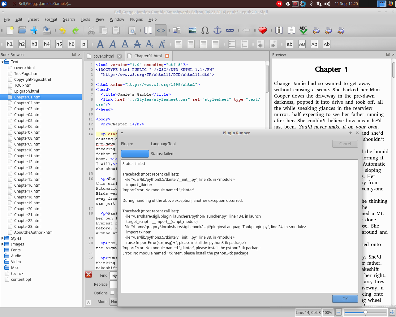

Two questions about Language Tool 0.4
1) Does it work automatically or do I have to run it (like I run FlightCrew and Epubcheck)?
2) When I went to run it I ran into this. (see screenshots) (I run Xubuntu 16.04 Distro)
sudo apt-get install python3-tk
The (Ubuntu-equivalent) python modules that ship with the Windows and Mac versions of Sigil are as follows:
  • python3-tk
  • python3-pyqt5
  • python3-lxml
  • python3-six
  • python3-html5lib
  • python3-regex
  • python3-pillow
  • python3-cssselect
  • python3-cssutils
  • python3-chardet
Plugin devs will assume that everyone has these python modules available. So Linux users who want to utilize Sigil plugins should make sure the above packages are installed when using Linux repository-supplied versions of Sigil.
Several may be installed already, but you can safely run the following command to insure they are all installed/updated:
sudo apt-get install python3-tk python3-pyqt5 python3-lxml python3-six python3-html5lib python3-regex python3-pillow python3-cssselect python3-cssutils python3-chardet

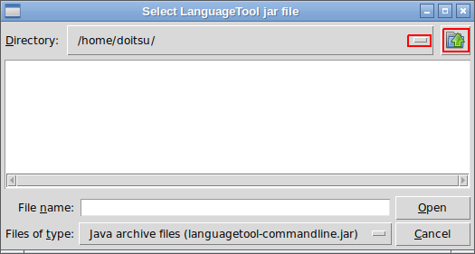

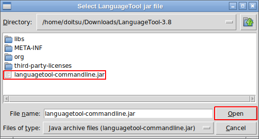

I ran that python command, but when I ran the Language Tool in Sigil I got this window (that I couldn't take a screenshot of) that was titled:
You'll need to download and unzip LanguageTool-3.8.zip.
For example, if you unzip LanguageTool-3.8.zip in the Downloads folder, languagetool-commandline.jar should be located in:
/home/gregory/Downloads/LanguageTool-3.8/languagetool-commandline.jar
(I wouldn't recommend using the Downloads folder, though. I'm just using it as an example.)
When you run the plugin for the first time, you'll need to change the default folder in the file selection dialog box to the folder that you extracted language tool to.
To change the folder either click the button right of the current directory and/or click the up arrow button to display the parent folder.
Once you've selected the correct folder you should see several subfolders and languagetool-commandline.jar. Click languagetool-commandline.jar and Open.

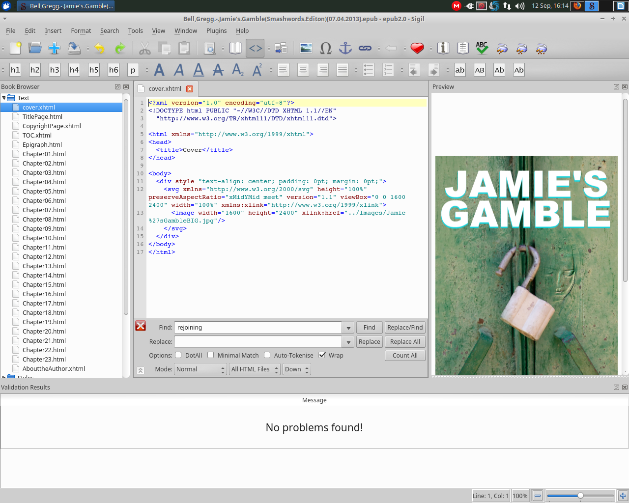

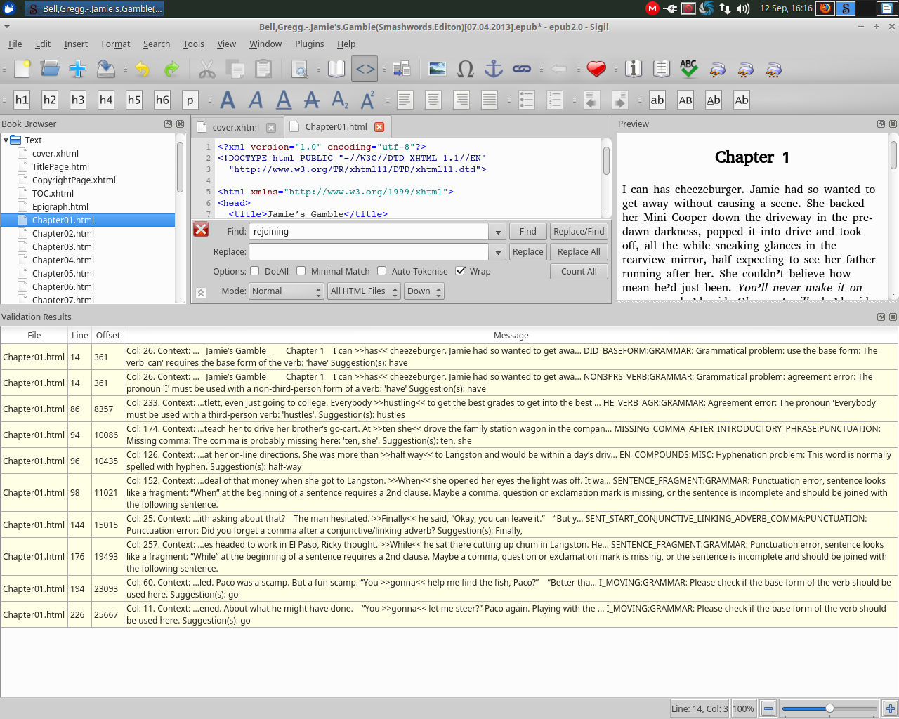

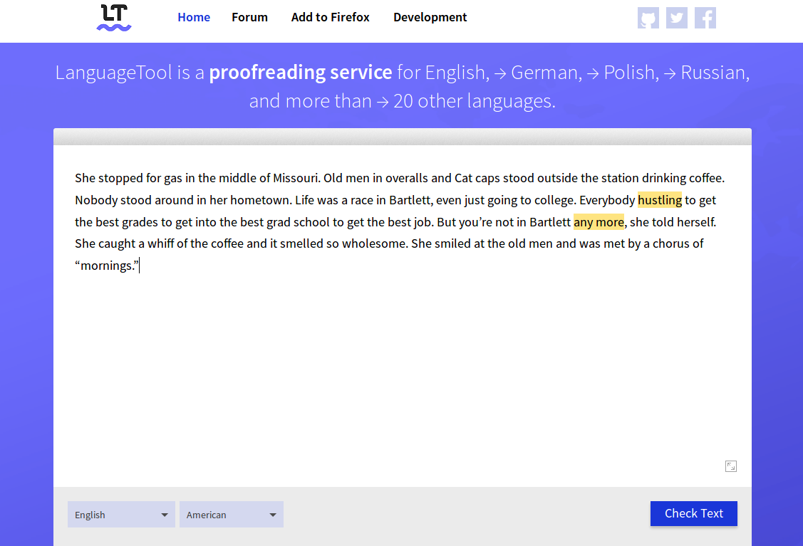

Hey.
16:14:21 screenshot is after I first ran Language Tool plugin
16:16:52 is after I added 'Cheezeburger' test sentence and ran LT again
128 is after running a paragraph with a flagged sentence (in line 86) in online LT

I tested this (doing what's in the above quote) on the same epub I ran the first LT tests on and the results were the same: the first LT run said no errors and then I added the cheeseburger test line and ran it again and it got the same errors as in the 16:16:52 screenshot.
ID:	159001   Click image for larger version
ID:	159002   Click image for larger version

Old 09-13-2017, 12:39 AM   #30
Doitsu
Doitsu's Avatar
Posts: 5,936
Karma: 24259515
Device: Kindle PW2
By default, the plugin will only check the file that is currently selected in the Book Browser dialog box. That's why you got no error message when you clicked cover.xhtml and ran the plugin.
If you want to check all files, either select all .xhtml files in the Book Browser or click the Text folder in the Book Browser before running the plugin. (Clicking the Text folder is the same as selecting no file.)
