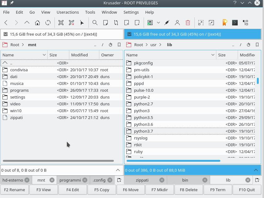

Done all, but not working: I get always the same error message.
duns@duns-neos:/usr/lib/python3/dist-packages$ ls -l|grep lxml
drwxr-xr-x  6 root root   4096 ott 19 21:37 lxml
drwxr-xr-x  2 root root   4096 ott 19 21:23 lxml-4.0.0.egg-info
Added that path in .bashrc, as following:

Maybe I have too many Python on my kubuntu?
It's possible I guess. I certainly don't think python 3.7 is standard on 17.10. You may not have a stable python3 environment at this point.
