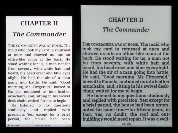

That's really odd. I just checked a book I scanned that I know has the same, no indent on initial paragraph in a chapter, then indented on subsequent paragraphs, and Moon+ displays it exactly the same as my ereader does.
I'm wondering if the type of phone, or Android version on it, causes some differences in how Moon+ behaves? I'm using a Samsung Galaxy S4 with Kitkat (4.4.2), and Moon+ Reader Pro 3.5.0.
