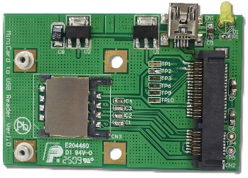

There are such modems/devices like one attached (i'm going to look for something like such on my localisation). I can try this out. But still - what will we get to know when i test it?

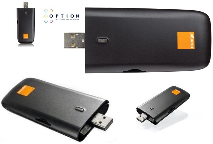

...aaaand found it. it's called Opition GI0201 (image attached) and it might work. still few bucks. should i buy motherboard or... or what
