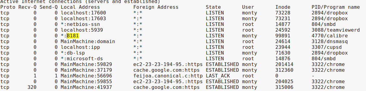

Just one more question...well, two, LoL. I have attached a screenshot of the netstat command, showing all (I think) all ports that are being used and their state.
If my ISP was blocking all ports, why would any of these work? And yes Dropbox as well as a ton of stuff I didn't include in the capture, is working.
Second question: If I use a VPN which is activated either on the Linux PC or in the Asus router, would that prevent any port blocking by the ISP? IE, how can they block something inside the VPN pipe that they (supposedly) cannot see?
Just trying to understand how this stuff works!
Thanks again,
Monty

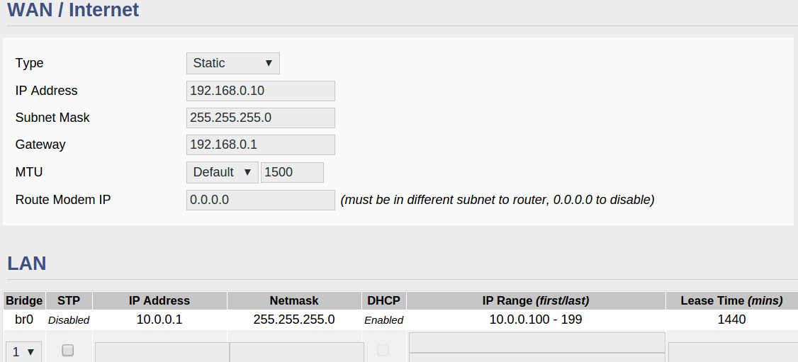

See if http://portforward.com/help/doublero...forwarding.htm helps.
Their address 192.168.1.1 is your 192.168.0.1; their 192.168.1.5 is your 192.168.0.11; their 10.0.0.1 is your 192.168.5.15 and finally their 10.0.0.15 is your 192.168.5.168

"LISTEN" means that an application on the PC is waiting for something to come in on the port. It doesn't mean anything can reach it. "ESTABLISHED" means that something has reached that port.
I'm not sure on the rest. But, some of them work by the local application initiating the connection. They can hold it open or check periodically. They might also negotiate another port to use. The ISP is usually blocking incoming ports, not outgoing, so applications that work like this will be OK.
It's also common for ISPs to block some ports, but not others. Blocking port 25 is common to help prevent spam. My ISP blocks 25 outgoing, 135, 137, 138, 139, 445 both ways and 80, 443, 22, 23, 8080, 3128 incoming. But, I can also turn that off. Another policy I have seen is to block all low numbered ports, but allow high numbers.
Something you can try is to telnet to the ports. Or run a traceroute to the port from outside. Using telnet is handy as is the simplest way of contacting the port. The traceroute can help see where the block is. Unless you know the network well, it will still be a guess, but the domain names of the devices can give a good idea of where the block happens.
And of course, are you sure the where ever you are testing from isn't blocking the port? I have access to several networks at work. They are all restricted, but one of them is almost completely closed to the outside world.
Yes, that is the site I have been using (I pasted the site in a previous post). And in my initial try, I set R1 up just as they have it, but set R2 up with my normal local LAN IP addresses of 192.168.5.11 (Router). Since then, I wondered if there was some conflict due to the same primary domain of 192.168.
So I went all out and changed it to their example, ie using 10.0.0.10 as my local LAN router address. The assignments are now:
Internet > R1 (192.168.0.1) > R2 (192.168.0.10) WAN IP > R2 (10.0.0.1) LAN IP > 10.0.0.100-.199 (LAN Devices)
In R1 the port forward 8181 is now set to IP 192.168.0.10 (R2 WAN/External IP)
I actually tried to put in 10.0.0.1 as the Port Forward IP, but R1 refused that, as it should have because R1 should have no knowledge of anything downstream of R2, the 10.x.x.x ranges.
And, it still does not work. R1 also has a DMZ and I have set it to 192.168.0.10, no change.
R2 has DMZ mode as well, and I set that to 10.0.0.168, which is the Linux PC LAN IP address. No change.
Thanks for the comments!

I have attached a screenshot of R1 WAN/LAN setup I forgot to attach for above reply to PeterT.
