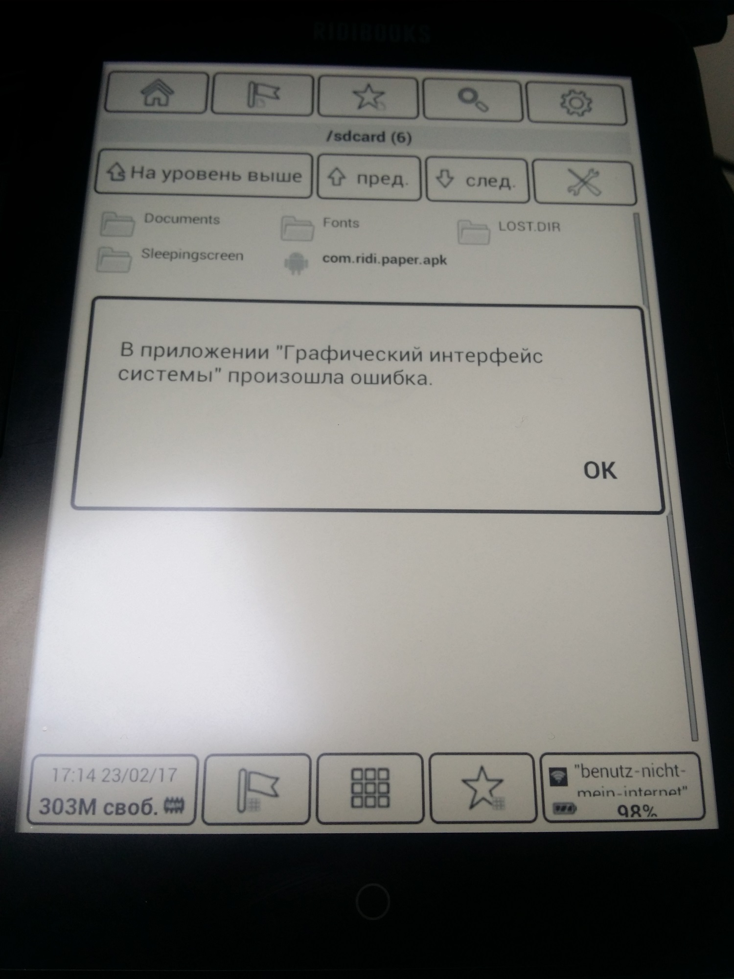

Always get the same error message.
Originally Posted by newap96 View Post
@newap96
I have the Ridibooks paper and tried to unlock android with your instruction! I cannot speak russian, so I had to use google translater.
I was able to upload the system.img to the ebook reader. After restart I had a russian Android ebook reader. But from the start there was an error message, that will always pop up immediately again.
Therefore, I cannot use the device
According to google translator, the message means that the device is not correct and there is a problem with the application "graphic interface".
Do I have to upload another img file,too?
Do you have an idea for my proplem?
Thx!!!!!!
That's how the error Looks like

Originally Posted by alex.ebook View Post
Do you mean that I should try the T63 Magicbook firmware? I have unpack the system.img from this device and upload it to my device. However I just get an Bootloop. Should I instead install the whole firmware = update.zip?
I would use it from this link:
https://www.mobileread.com/forums/sh...d.php?t=265289
FINALLY!!!!
I got it to work ... UI and App is now in German
Most system.img did not wanted to work. The trick is to use the RK3xxx tool to extract the system.img and than to repack it "build" with the following size: 512MB ... now most system.img are working on my ridibook. I am using now the system.img from the Energy Sistem Energy Ebook Reader Pro HD.
I hope I can help other people with this advise.
