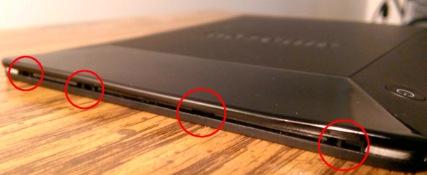

I wanted to provide some Voyage-specific feedback to hopefully help anyone using a Voyage as a few things were different.

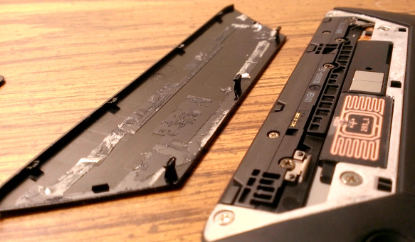

Here you can see the four attachment points on the top bezel, prying these up is the first step.
Name:	top bezel pop locations.png
Remember if you don't have opening tools a screwdriver can do a number on the plastic -- try getting a few cheap guitar picks from a local music store as they're thin, but strong.
This shiny top plastic part is pretty thin and could probably be broken easily. There's a bit of glue to deal with on this part as well and if you pried from the top only you could be in danger of breaking or bending the plastic as most of the glue is at the bottom of the piece. If you have something you can stick in there to pry it from the middle and then the back that would be best. Here's a picture of the top bezel removed, which I think shows the glue you have to deal with and where it would be located pretty well. There's a bit on the grey metal as well.
Name:	top bezel glue.png
That was actually the hardest part of disassembly. You have to remove the 4 screws on the grey metal part (keep in mind the two toward the bottom end of the kindle are different than the two on top) then slide the whole back down toward the bottom of the kindle. It will come off without any tools if you just work it.
That's it for disassembly.

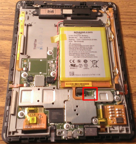

The serial port is fairly easy to locate. I've marked it below.
Name:	kv serial port location.jpg

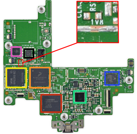

The hard part was locating the reference voltage joint. I couldn't find anything on the forums and was actually going to post and ask when I noticed the iFixit image of the KV mainboard, specifically this:
Name:	1v8 location.png
Will post more when I'm able -- though you can probably guess most of the rest.

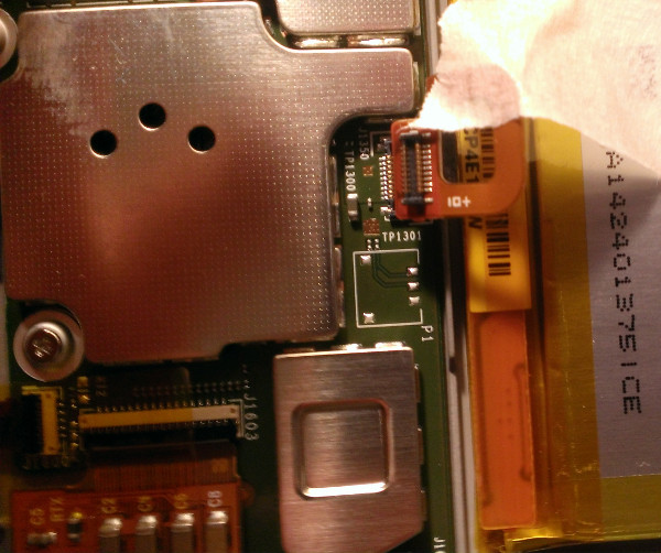

So after I found the 1v8 (verified that it was 1.81v with a multimeter) the rest of the hardware side was pretty straightforward, except for one little interesting mishap. See the small copper pad labeled J1350 in this picture? (The tape is holding the power connector from the battery back.)

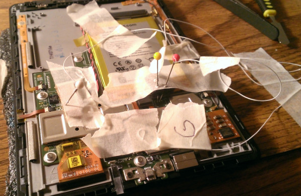

I was trying to take this connector off with my tweezers, but when I touched the J1350 pad I saw a small but very visible spark. Fearing that I'd bricked my favorite little gadget I immediately tried to power it on. The screen was blank for a few seconds then started booting as though I'd switched it completely off. Curious, I stuck my multimeter on it (grounded on one of the plates this time of course) and got a reading of ~4.06v. Also interestingly, when I got done taking the reading and turned the device back on, it restarted itself again. Any idea what this is or what I was doing?
Anyway, back to the productive stuff. Here's the great Cthulhu, taped down as these connections are pretty fragile since they're just wire looped into the holes on the usb board. I put tape on the wires to keep track of which is which -- something I wouldn't do in retrospect as there are only 4 of them and the tape just got in the way.

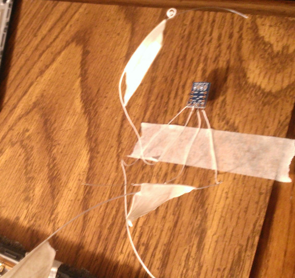

Next I looped the grounding so the exposed section was in a circle and taped it to one of the shielding plates, and twisted the rest of the wires to sewing pins. I tried using cardboard at first to place the pins in but wouldn't recommend it as it was far more finicky than foam. Also you might need to put some pressure on the bottom of whatever material you use and push the pin through a little extra while doing so, since when you push the pin the material will flex and will then pull away from the connection points when you release pressure.
Here's the final setup. White is voltage, yellow is connected to tx on the kindle and rx on the MicroFTX, red is rx - Kindle / tx - board. You can see the big "G" where the grounding wire was looped and attached. I got a really good connection on the voltage pin so I taped it down so as not to jiggle it at all.
Next was all software. Note that I had to reboot the computer to get the COM3 port to show.
Since I was using the pin method the kindle itself was face-down the whole time so I didn't get to see the screen while running through PuTTY. When I rebooted (boy was it great to see the output on the screen though!) it seemed to do just fine, with me interrupting boot then doing bootm 0xE41000. The boot then seemed to stop with the line "sock_init 1888". Note that I never got the diags menu that you show. It just sat at that line for a while. So I tried typing commands and none of them seemed to work so I tried "exit" and got the following:

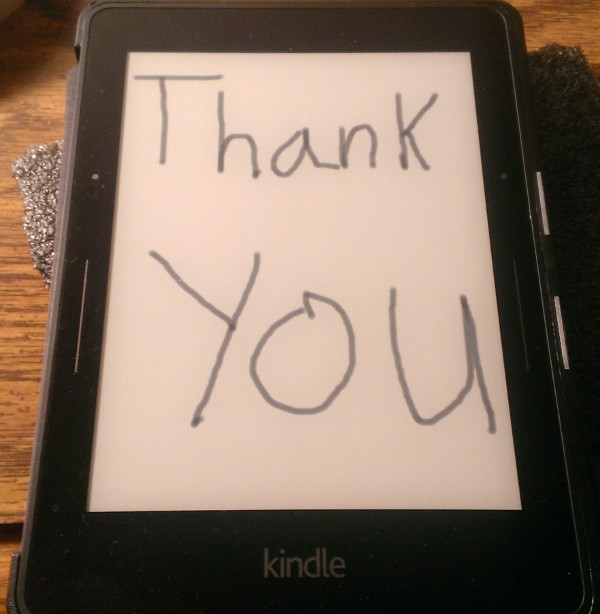

Oh, and to you and everyone else who has done such a great job working on this stuff, including you, DennisH, knc1, NiLuJe, and everyone else who has done so much to help with the public knowledge of our devices, I just wanted to say:
(custom screensaver from the screensaver hack)
