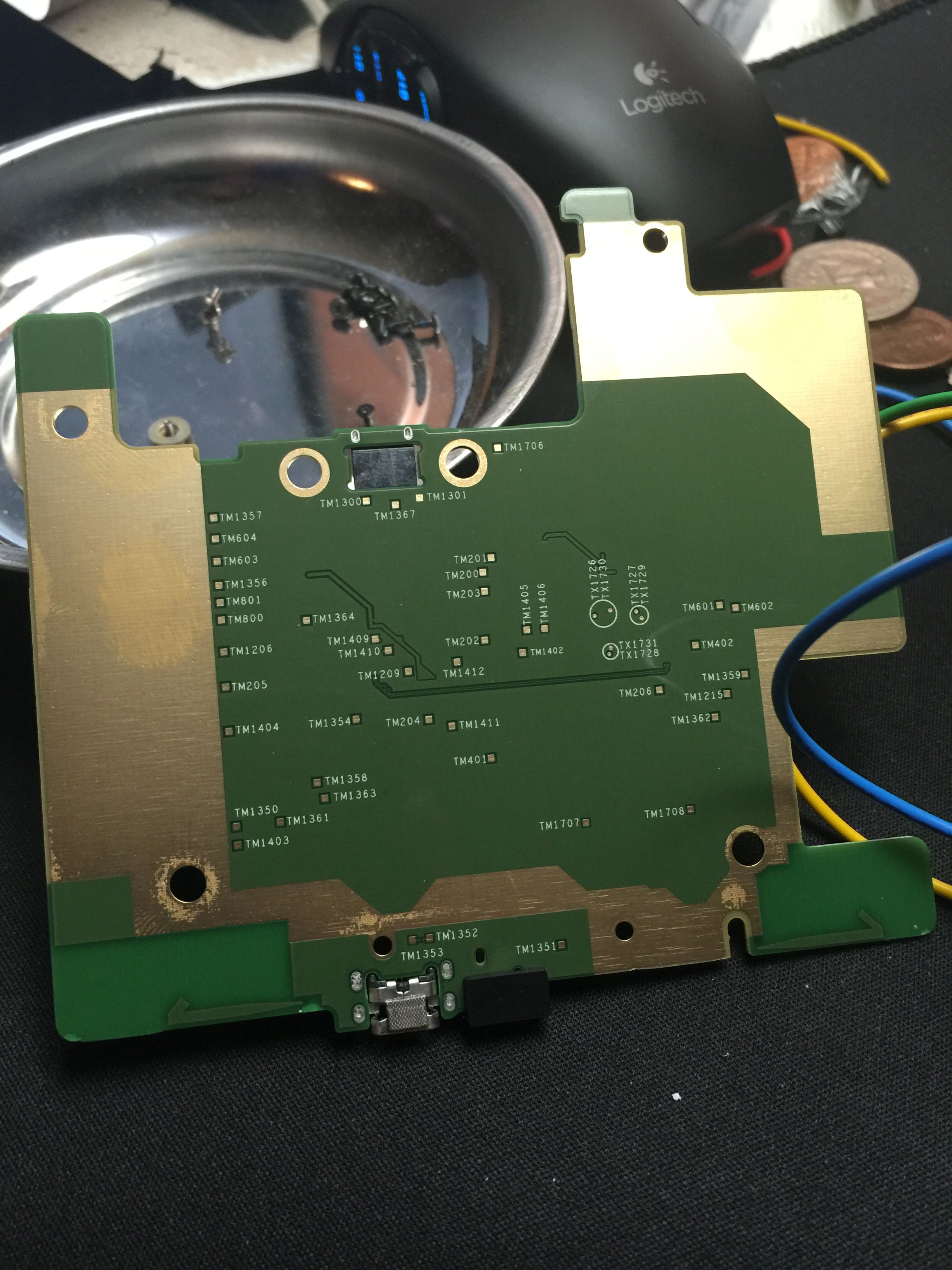

The SoC has five (or six) UARTS on it, the location of the other 4 (or 5) have not been identified either.
Being impatient I have also ripped the pads off of the P800 TX and RX. Finding no trace to follow I have taken the main board off of the plate.
This is the back of the PCB of the PW3:
Oversize image; see thumbnail. - mod
It looks like TM800 and TM801 are alternative solder pads. They are located directly below the original P800 solder pads. I am going to have to pick up some magnet wire to solder it well this time. There many pads on the back of this PCB...

Remember, its a 4 (or more) layer board.
What you see on the back does not have to have anything at all to do with what you see on the front.

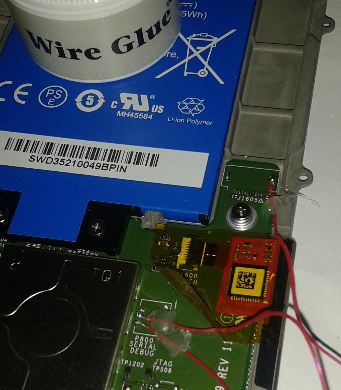

I tried the suggested option to use cardboard and pins, but it did not work reliable. So now I have another simple and soldering free option.
1) I use two short thin single core wire-wrap wires to connect RX and TX (about 4-6 inch long).
2) I strip them about 1/10th of an inch, maybe even less
3) I glue these in place with a hot glue pistol, just (barely) touching the contacts
4) I use conductive glue to make the actual connection (http://www.ebay.com/itm/WIRE-GLUE-El...-/290695765305)
DO NOT USE TOO MUCH GLUE
5) I connect the ground terminal on a easy accessible location on the board
6) I use a 1.5V AAA battery for powering the converter: the less wires you connect to the Kindle, the better
Hope this helps. I forgot to take pictures, next time I will make a photograph.
Peter
palbeda is offline   Reply With Quote

OK, Some more instructions as I tried it again (with succes!!) and made some pictures.
What I did is before connecting the wire, put some solder there so the wire is pre-tinned.
Then, apply a very small bit of conductive glue on the bottom part of one end of the wire using a match. I decided NOT to dip the wire end in the glue, as I feared the glue would run between the two contacts (RX and TX) if too much glue is applied.
Then I carefully put one wire before the other in place and then mechanically fix the wire by wire with a drop of hot plastic glue. The conductive glue is mechanically not very strong, but once the wire is fixed with plastic glue, the small bit of glue makes a perfect connection, without applying any heat or mechanical stress to the extreemly small and fragile RX and TX contacts.
Maybe this sounds complicated, in fact it is not only easy and fool proof, it is a lot safer as soldering as the contacts on the printed circuit board are VERY thin and easily let go if you apply a small bit of strain to the soldered wire or if you use a bit too much heat.
The result is a very good connection which is hard to tell apart from one that is soldered with hardly any risk.
