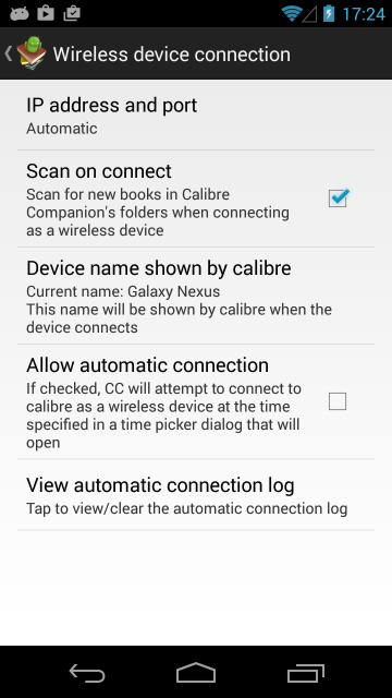

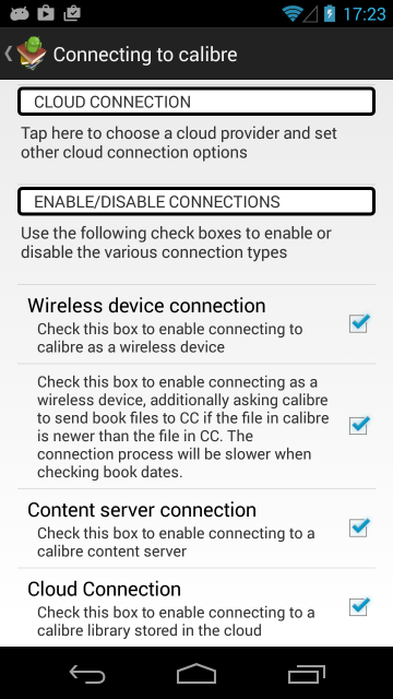

Originally Posted by kaufman View Post
Works great. One comment. In the settings screen, I think it would be clearer if you indented the two wireless connections a bit. I know what that do, and when I first saw the screen, I thought selecting the second one might overwrite the first one.
How about this?
I changed the indent for all the check boxes on this screen because I thought it looked weird if 2 were indented but the other 2 were not. However, note that the extra indent appears only in this preference screen. I am not changing check boxes in other places, as shown by the second image.

How about this?
Its better, but I still feel like it might not be clear to a new user that they can have both turned on. Obviously, they can just try, but perhaps there is a wording/formatting to avoid confusion (and possibly support emails).
How about something like:
Wireless Device Connection
Note: You can choose to re-sync updated books on a wireless connection. This is slower because all book dates have to be compared on connection to Calibre.
Check this box to enable wireless sync without automatically sending updated books []
Check this box to enable wireless sync with automatic sending of updated books []
kaufman is offline   Reply With Quote
