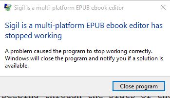

I'm hoping it's something specific to certain epubs (and quick and easy to fix). I've manipulated a handful of ePubs' ToCs (both html and ncx) on Windows 7 and can't get it to barf.
But when I try to create ToCs from headers in Vista (using the entry on the tool bar), Sigil immediately crashes. It's repeatable. I'll let you know about Windows7 once I install 8.9 there.

I have tried using the Generate TOC using the button on the tool bar with 10 different epub test cases and in all cases it worked just like it was supposed to. But this is on Mac OS X. So would you please post a specific test case you know will create the crash on Windows. I will fire up my Windows VM and try to see if I can get the same epub to crash.
Thanks,
KevinH
ps. I fired up my Windows 7 32 bit VM and downloaded Sigil-0.8.900 for Windows and installed it and ran it over the same 10 books using the Generate TOC icon and never had an issue. So we will really need a test case to track this one down.

Same here. I'm able to generate the ToC from Headers on Windows 7 with no crash. If it's repeatable, I think it's time someone just gave us one of these epubs it's happening with. Might save save some time. I'll also put 0.8.900 on my Vista machine and see what happens.

The attached epub crashes Sigil on both my Vista & Windows 7 PCs when I try to create toc entries from headers. Editing the toc file works fine.

The good news is ... I can get Sigil to crash when generating an NCX from headers on Windows Vista. Just about any epub will do it for me. The bad news is ... I have no easy way of doing any real debugging on this tired old heap it's happening on.
