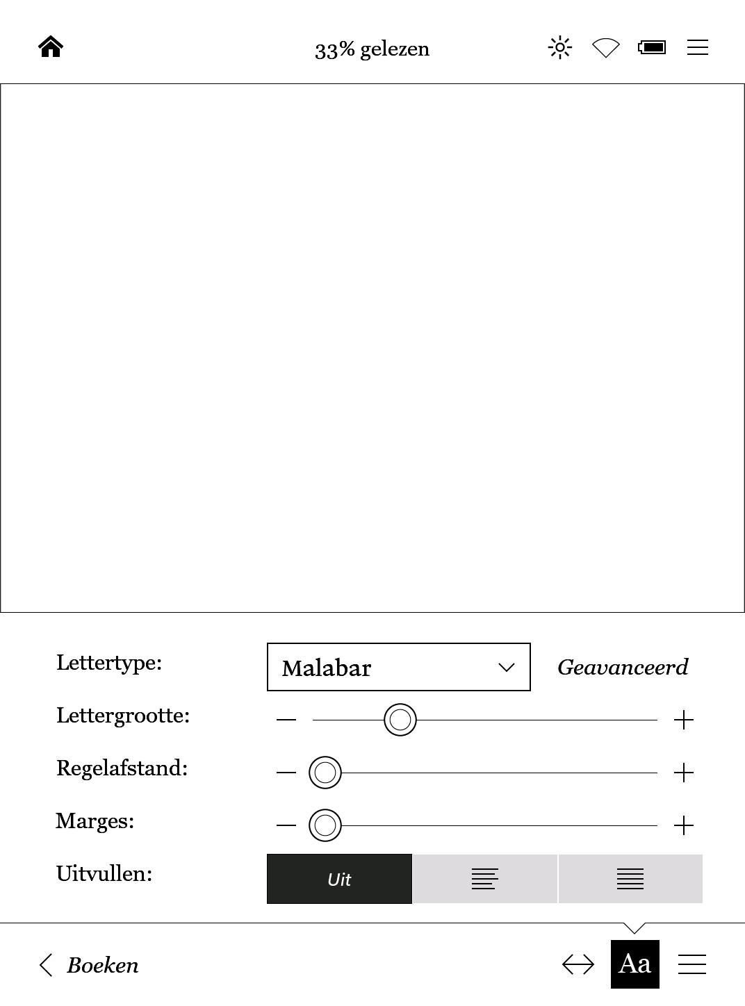

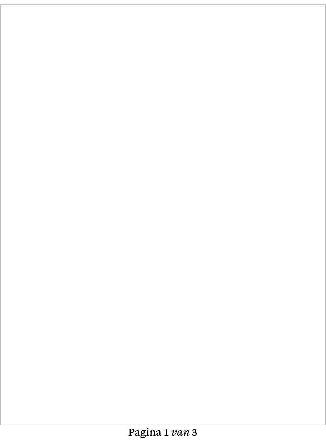

Old 09-26-2015, 07:40 AM   #24
Nick_1964
Bookworm
Nick_1964 ought to be getting tired of karma fortunes by now.Nick_1964 ought to be getting tired of karma fortunes by now.Nick_1964 ought to be getting tired of karma fortunes by now.Nick_1964 ought to be getting tired of karma fortunes by now.Nick_1964 ought to be getting tired of karma fortunes by now.Nick_1964 ought to be getting tired of karma fortunes by now.Nick_1964 ought to be getting tired of karma fortunes by now.Nick_1964 ought to be getting tired of karma fortunes by now.Nick_1964 ought to be getting tired of karma fortunes by now.Nick_1964 ought to be getting tired of karma fortunes by now.Nick_1964 ought to be getting tired of karma fortunes by now.
Nick_1964's Avatar
Posts: 975
Karma: 768585
Join Date: Aug 2010
Location: Netherlands
Device: Sony prs-650, Kobo Glo HD (2x), Kobo Glo
This is on my Glo HD.
This is the page on glo HD
These where the settings during display.
I used: patch_name = `Custom reading footer style` with your default settings and adapted one value to make the "page xx of xx" txt a bit larger:
# Replacement caption font size value for GloHD:
replace_string = 00C5, `font-size: 30px;`, `font-size: 33px;`I am still on 3.17.3 if you want me to change to 3.18 let me know.
It looks to me that my top margin is smaller but don't know how to "measure" how much pixels it is..
Nick_1964 is offline   Reply With Quote

Thanks Nick, the top margin in that screenshot is 15px, same pixel size as the Glo, but only 1.4% of screen width compared to 2% on the Glo.

I understand.. for the Glo HD it would only be possible for 1% with leaves 0,4.. with 2% it would be missing 0,6.. and I don't know how this counts for the Aura HD,which have another resolution.. but maybe you can calculate the values knowing now how much is left on a Glo HD ?? (or you make it a Glo only patch...)
