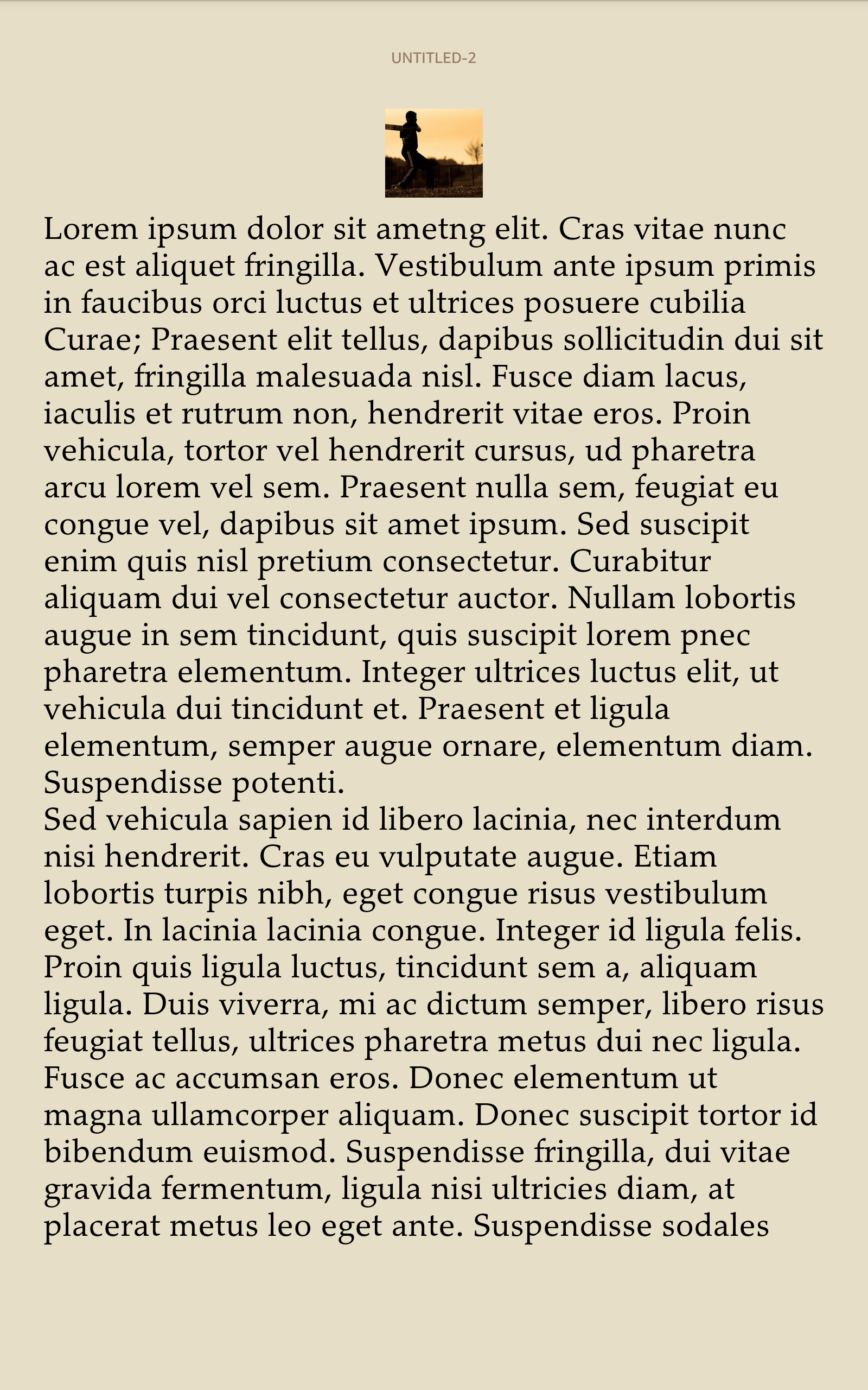

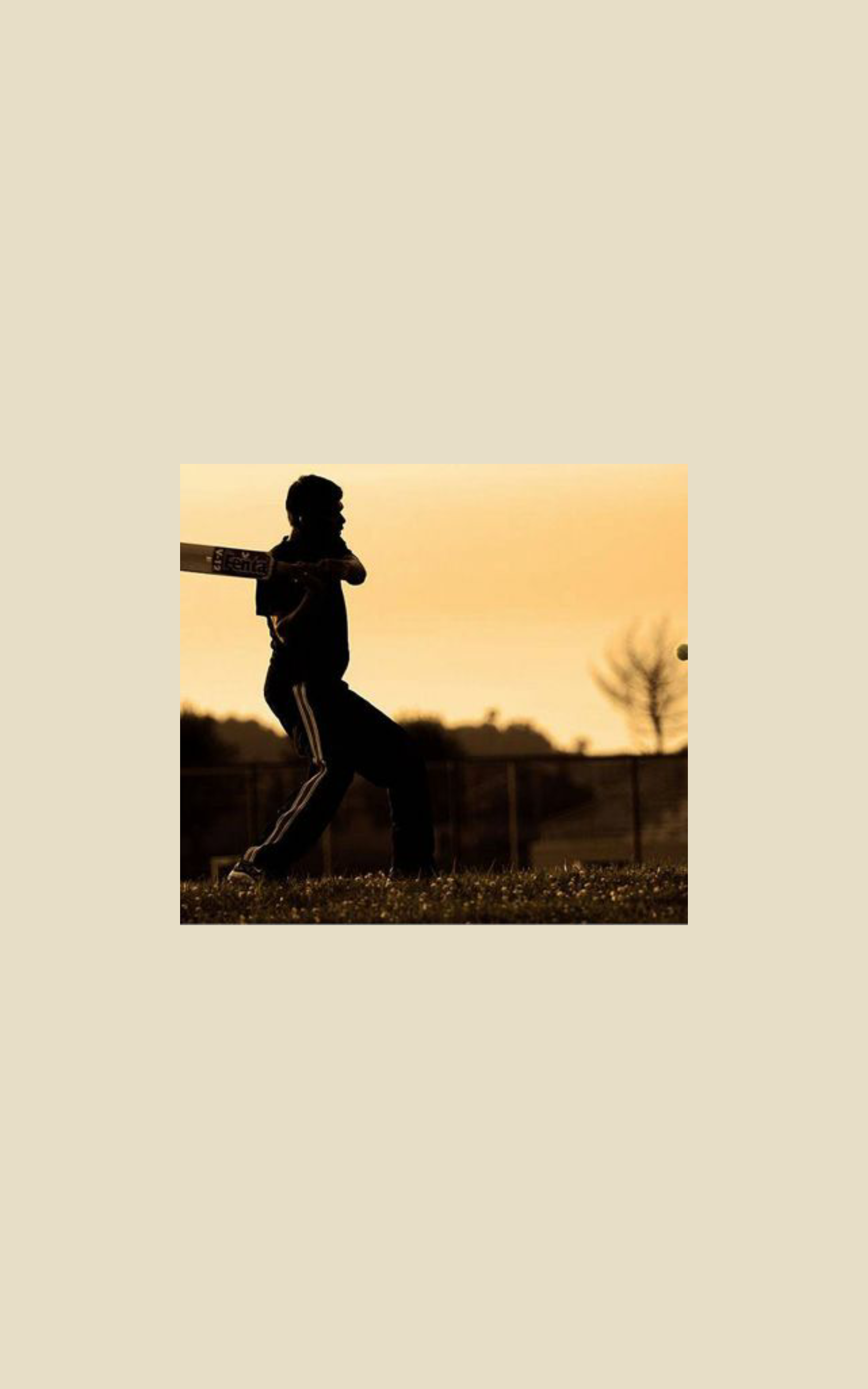

Originally Posted by IanLunn View Post
I have attached the MOBI if anyone would be kind enough to test and let me know if image zooming works as expected.
I know you're mainly worried about the Voyage, but the results on a Fire HDX (running current 4.5.4 OS) are that it works fine. I get a small thumbnail size image at the top of the test "page" and double tapping gives a bigger image (see attached).
