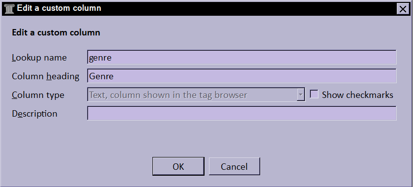

It works fine for me. Are you sure that #genre is the type you said? For example, it won't work if it is a column built from other columns.
Fixed.
I figured that if the user wanted to save it then perhaps s/he was going to come back later. I didn't want to create a situation where one *must* finish in order to go have dinner.
Could you send me the metadata_db_prefs_backup.json from your library? That will tell me the exact column configuration.
Here's a screenprint of the column while I look for metadata_db_prefs_backup.json
Edit: metadata_db_prefs_backup.json sent

@Purple Lady: could you be using more than one library? I ask because in the screen capture you showed in post 14 there isn't any Genre data. Or is this a book in the database that doesn't have any Genre information attached?

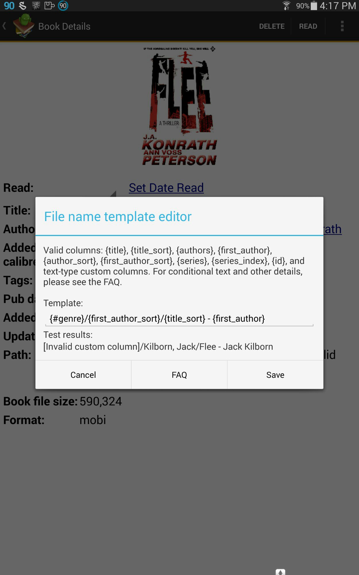

@Purple Lady: I can confirm that there is is (was) a problem with custom columns used in templates where the custom column was empty. The release alpha version assumes that a missing value is an invalid value. The next release will check if the column is defined but otherwise empty and if so will return an empty value.

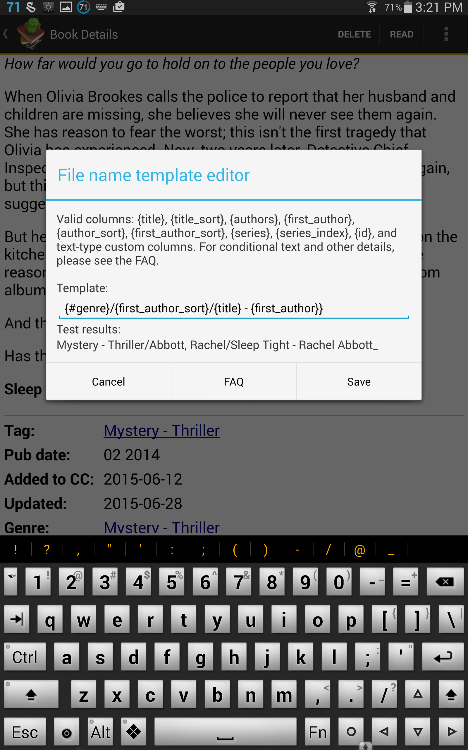

I'm getting an underscore at the end of my filename.
Edit: See next post for better screenshot
Old 06-28-2015, 03:26 PM   #21
Purple Lady
Purple Lady's Avatar
Posts: 5,698
Karma: 16542228
Location: Pennsylvania
I don't see it in my attachment above, so I'll try again.

It is happening because you have an extra closing } at the end of the template.
Thanks. I should have noticed that.

This problem came back again. I noticed it in 4.0.0i and it's still there when I updated to 4.0.0j.
