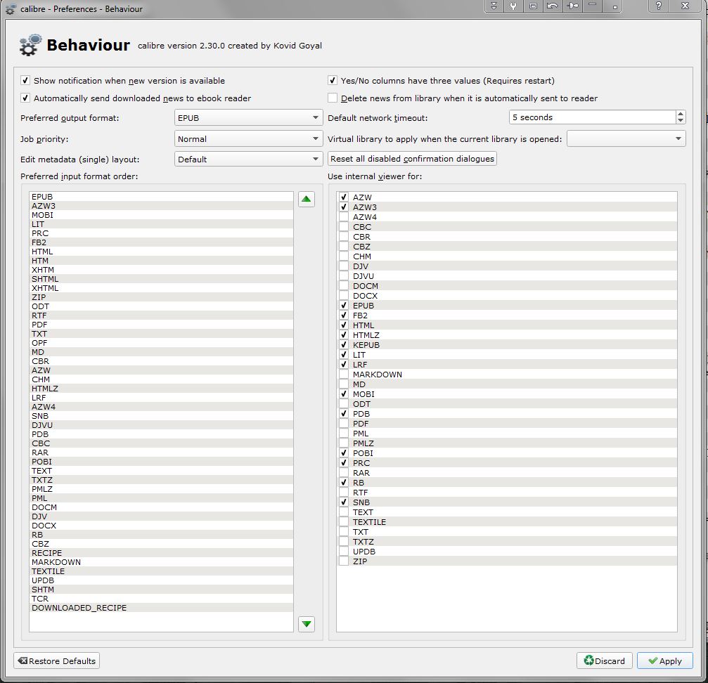

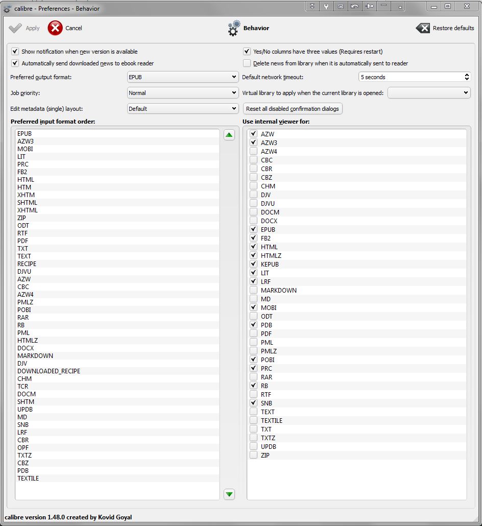

@theducks - I was referring to the Default settings - this is what I have in a fresh, unadulterated, 32bit 1.48 install (and if I reset) and what I see in 2.30 if I do a reset - as you can see the defaults have not changed over that period at least.
ID:	139329 Click image for larger version
My memory (admittedly, not as long as yours) is that AZW3 has always been checked. But that said, I doubt it has any bearing on OPs problem.

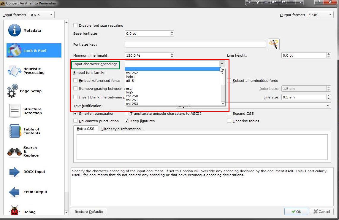

The HTML file in question is Latin1 plus Latin1 Supplement http://www.w3schools.com/charsets/re...supplement.asp, which is cp1252 less the characters in the 120 to 159 range. The displayed text of this HTML file, however, contains characters in that range, as well as two-byte utf-8 characters.
I had assumed that the "input character encoding" referred to the characters in the HTML file, not the characters displayed by the viewer or browser when interpreting that file. I thus tried both cp1252 and Latin1, neither of which produced correct output (in epub, mobi, or azw3 format). However setting the input to utf-8 does work. It would seem that a definition of this (to me) idiosyncratic use of "input character" be provided.

For HTML you want to leave input character encoding blank and put the correct encoding in the settings for the HTML2ZIP plugin. Or leave both blank and declare the html encoding correctly inthe html file itself using a <meta charset> tag.
If you wish to specify an encoding in both places, you specify the HTML file encoding in the HTML2ZIP plugin settings and utf-8 as the input character encoding.
The HTML2ZIP plugin reads in the HTML file using the encoding specified in its settings. It always results in an HTML file inside the zip file in utf-8.
So, one last time:
1) HTML2ZIP setting: cp1252
2) Input character encoding: blank
Old 06-18-2015, 03:57 PM   #27
