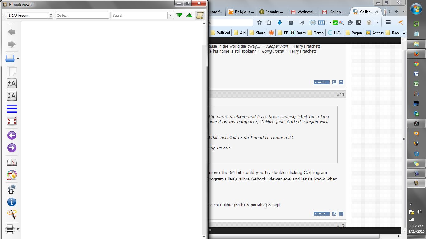

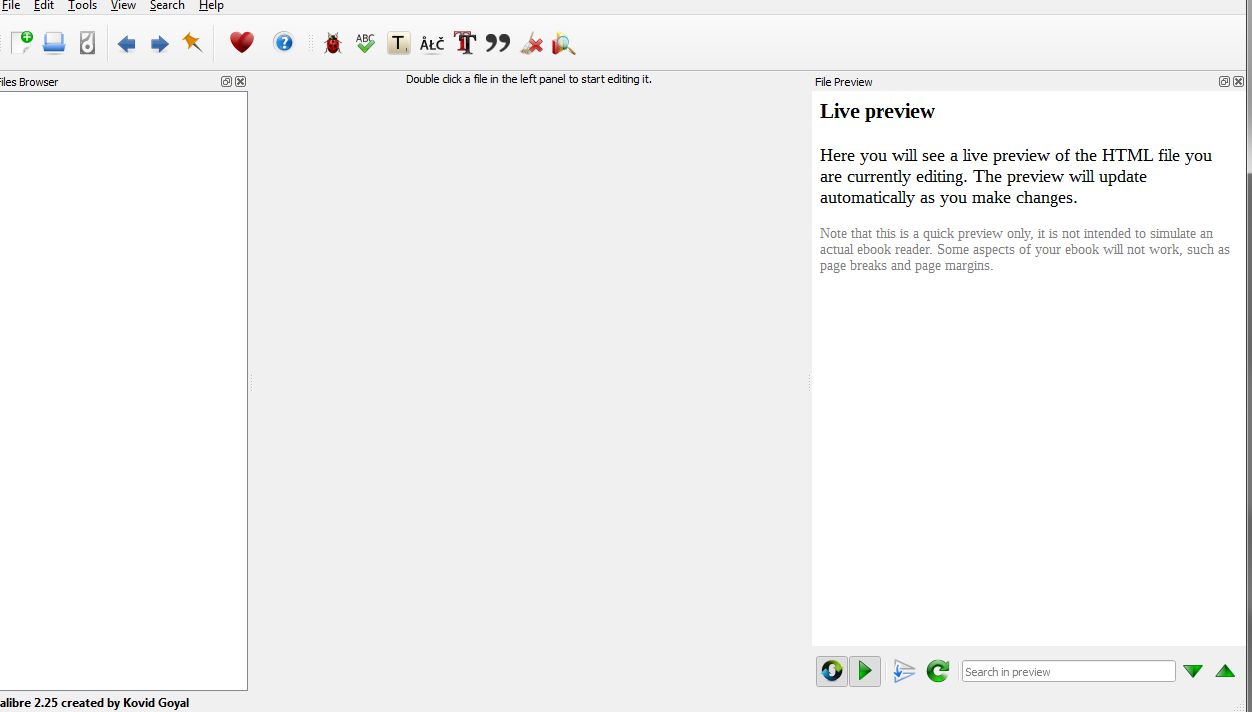

The attached screen shots are from Program Files, not Program Files (x86) which also has a Calibre folder. Let me know if I used the wrong one.

BetterRed...I posted the screen shots you requested, but forgot to put your name on the post.

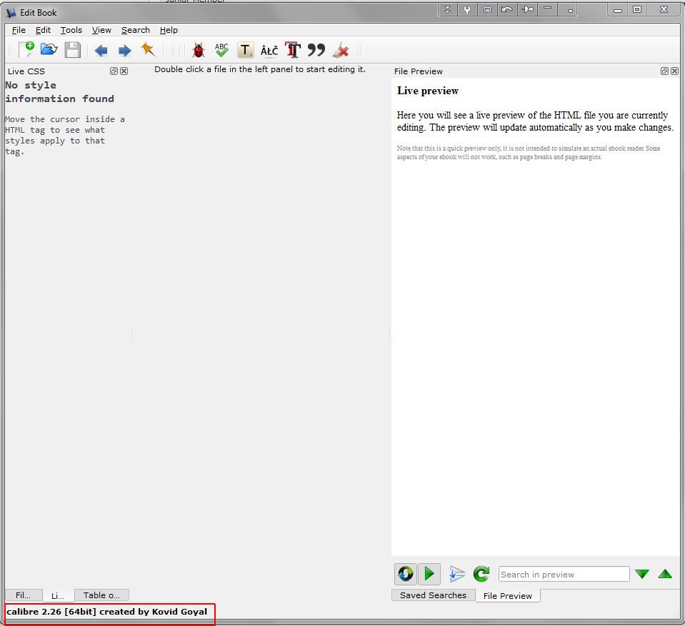

@Tatezi - thanks a lot, interesting. What that tells us is that the ebook-edit program does not appear to be the 64bit version, even though its in the Program Files folder. If it was the 64bit version it should say so, at bottom left:-

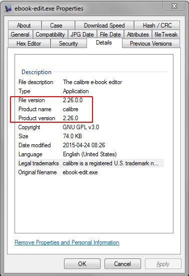

But, the '[64 bit]' you see in the version number above does not come from the .exe file itself, so we can't be sure :-
