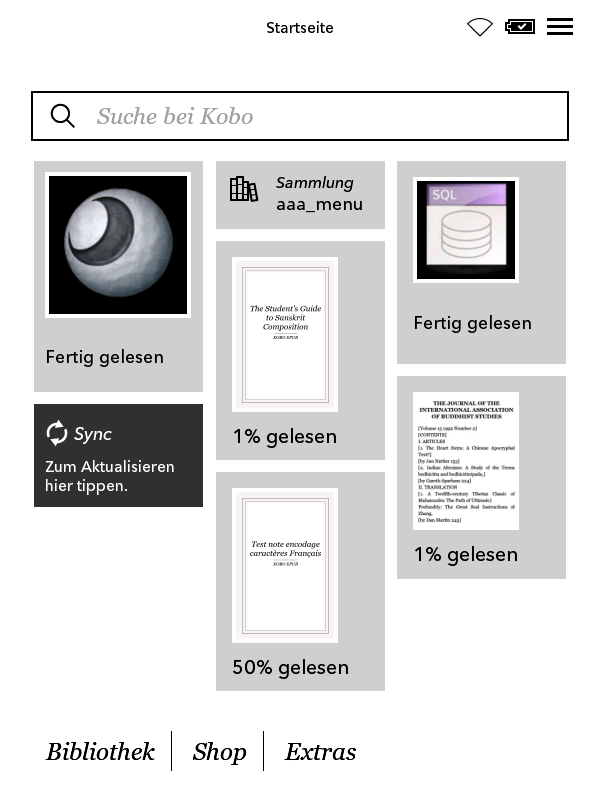

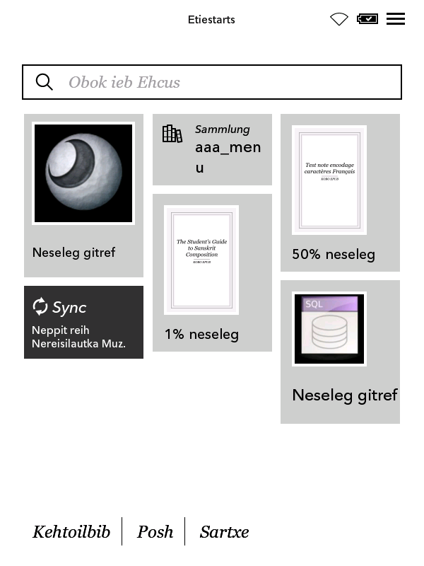

I did a mini test myself. I simply reversed some strings of the German interface (for instance Extras > Sartxe). I attach the image and the patch file as an example.
ID:	137003   Click image for larger version

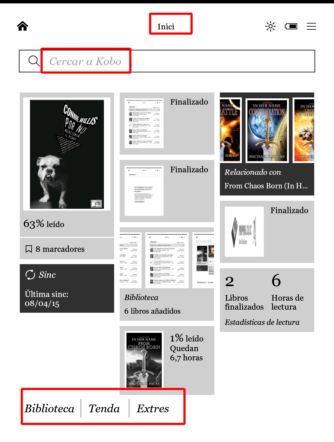

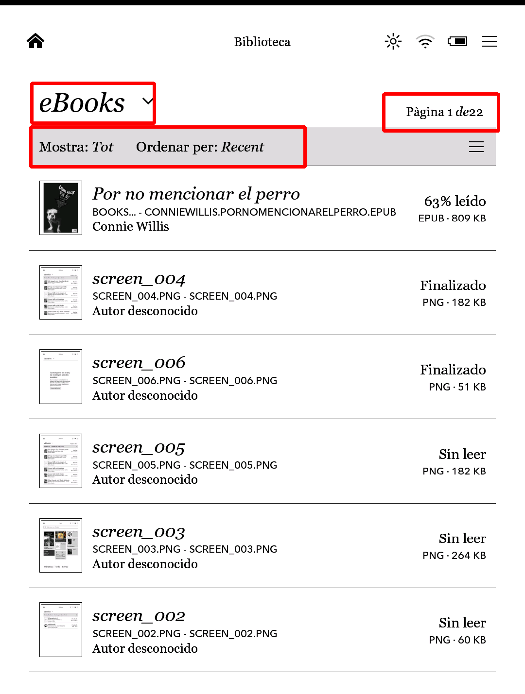

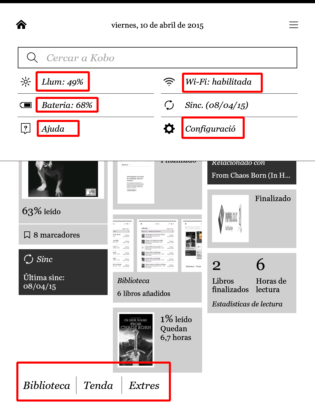

I think the test has worked! :-)
What is the next step?
This is a real problem. In none of the supported languages has the word for books more than six characters.
if you can not add more characters, I'll write "eBooks".
ID:	137068   Click image for larger version
ID:	137069   Click image for larger version
