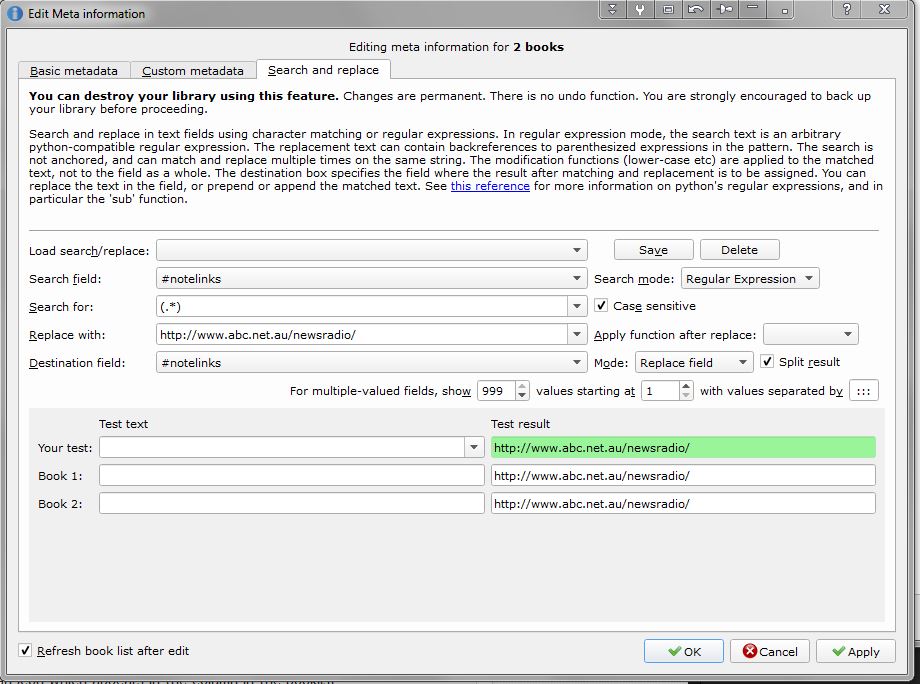

@haino - Grab the HTML Text from the HTML tab in the Editor like so
then do this, it should work

I am unsure why I thought the search field could be anything, suffice it to say it must match something somewhere. Search for

Then enter content in the search field, since we are appending it is irrelevant what you search for unless you want to use it in the replacement.
Search for:
Replace with:
whatever you want.[/QUOTE]
Thanks for all the help. That worked
I am very pleased
Thanks again
