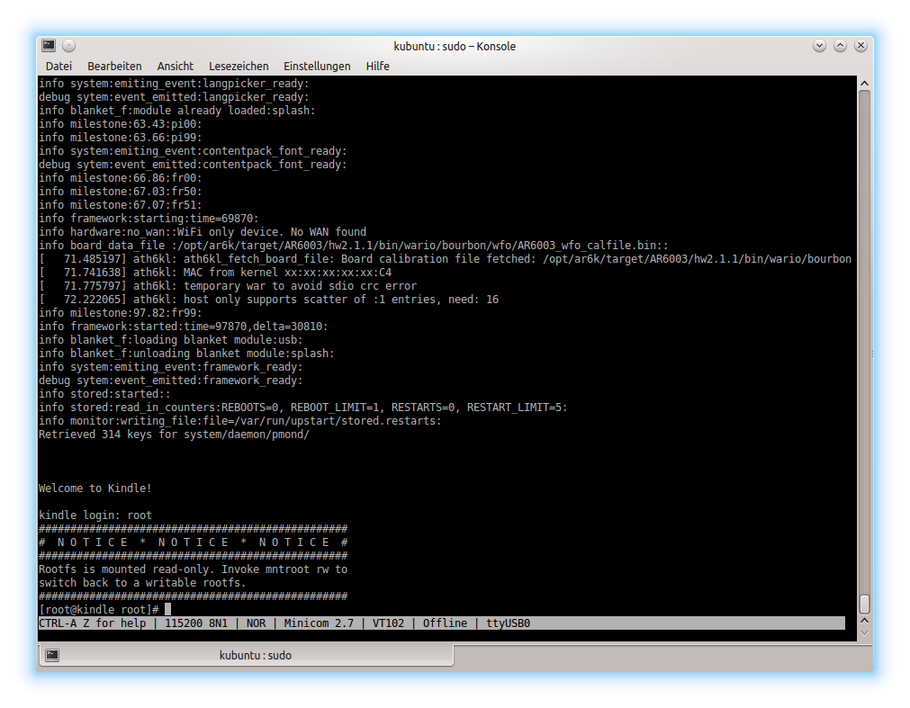

ok, thanks
i got it so far.
I have root-access in main with no password!

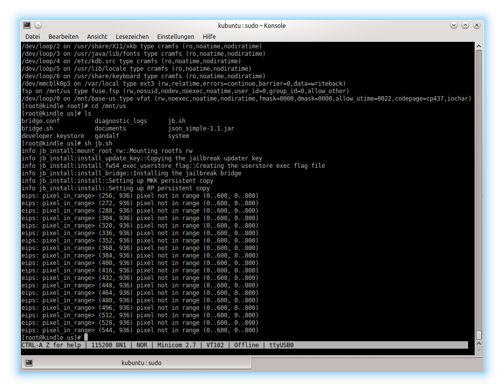

I have root-access and I executed jb.sh successfully (according to the terminal)
but - NOTHING CHANGED
after rebooting I get no 'jailbreak' - logo and
I am not able to install KUAL(v2.5) and MRPI ...
the command 'mountpoint' is not supported
here is cat /proc/partitions
[root@kindle root]# cat /proc/partitions
major minor  #blocks  name
   7        0    3192824 loop0
   7        2        564 loop2
   7        3      72272 loop3
   7        4         36 loop4
   7        5       2084 loop5
   7        6      14876 loop6
 179        0    3866624 mmcblk0
 179        1     460800 mmcblk0p1
 179        2      65536 mmcblk0p2
 179        3      65536 mmcblk0p3
 179        4    3192832 mmcblk0p4
 179       16       2048 mmcblk0boot1
 179        8       2048 mmcblk0boot0
[root@kindle root]#
and very helpful for an overview is df -k
[root@kindle root]# df -k
Filesystem           1K-blocks      Used Available Use% Mounted on
/dev/root               447909    289956    135453  68% /
tmpfs                   127728       100    127628   0% /dev
tmpfs                   127728         0    127728   0% /dev/shm
tmpfs                    32768       392     32376   1% /var
/dev/loop/2               2536      2536         0 100% /usr/share/X11/xkb
/dev/loop/3             105604    105604         0 100% /usr/java/lib/fonts
/dev/loop/4               1412      1412         0 100% /etc/kdb.src
/dev/loop/5               9324      9324         0 100% /usr/lib/locale
/dev/loop/6              22720     22720         0 100% /usr/share/keyboard
/dev/mmcblk0p3           63461     17444     42741  29% /var/local
/dev/loop/0            3188640     76192   3112448   2% /mnt/base-us
fsp                    3188640     76192   3112448   2% /mnt/us
[root@kindle root]#
