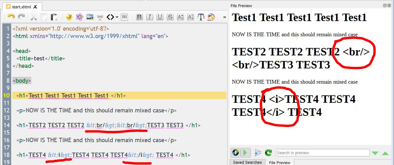

1. So the simplest case (first H1) works correctly
2. I don't understand why the same logic isn't applied to the second and third so that all text between the Hx's is made title case, as well as why the replacement of < and > with entities which end up being treated like normal text

I was confused by the apparent different treatment of the TitleCase function between the first (simplest) sentence "Where It Worked Just Fine" and the second and third where IT LEFT EVERYTHING IN UPPER CASE
@jbacelar -- The Find Kovid gave me seems to work fine. It would select all this H1 text, including the <h1> and </h1> ...
<h1>TEST2 TEST2 TEST2 <br/><br/>TEST3 TEST3 </h1>
After the Replace
<h1>TEST2 TEST2 TEST2 &lt;br/&gt;&lt;br/&gt;TEST3 TEST3 </h1>
What was confusing me was that the text was not in title case. I understand the replaced entities now
I believe that Kovid's new built-in function is the only way to handle these types of cases

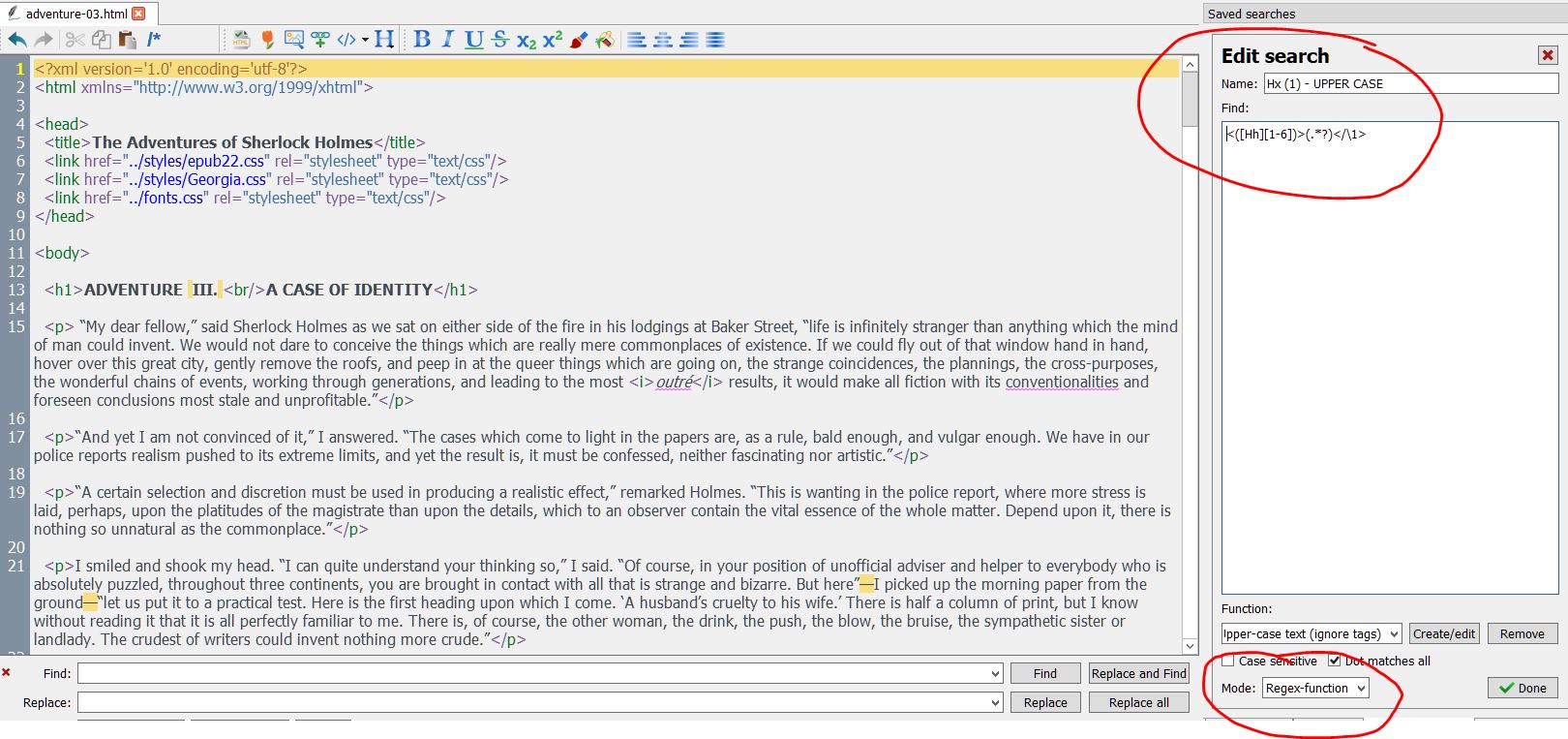

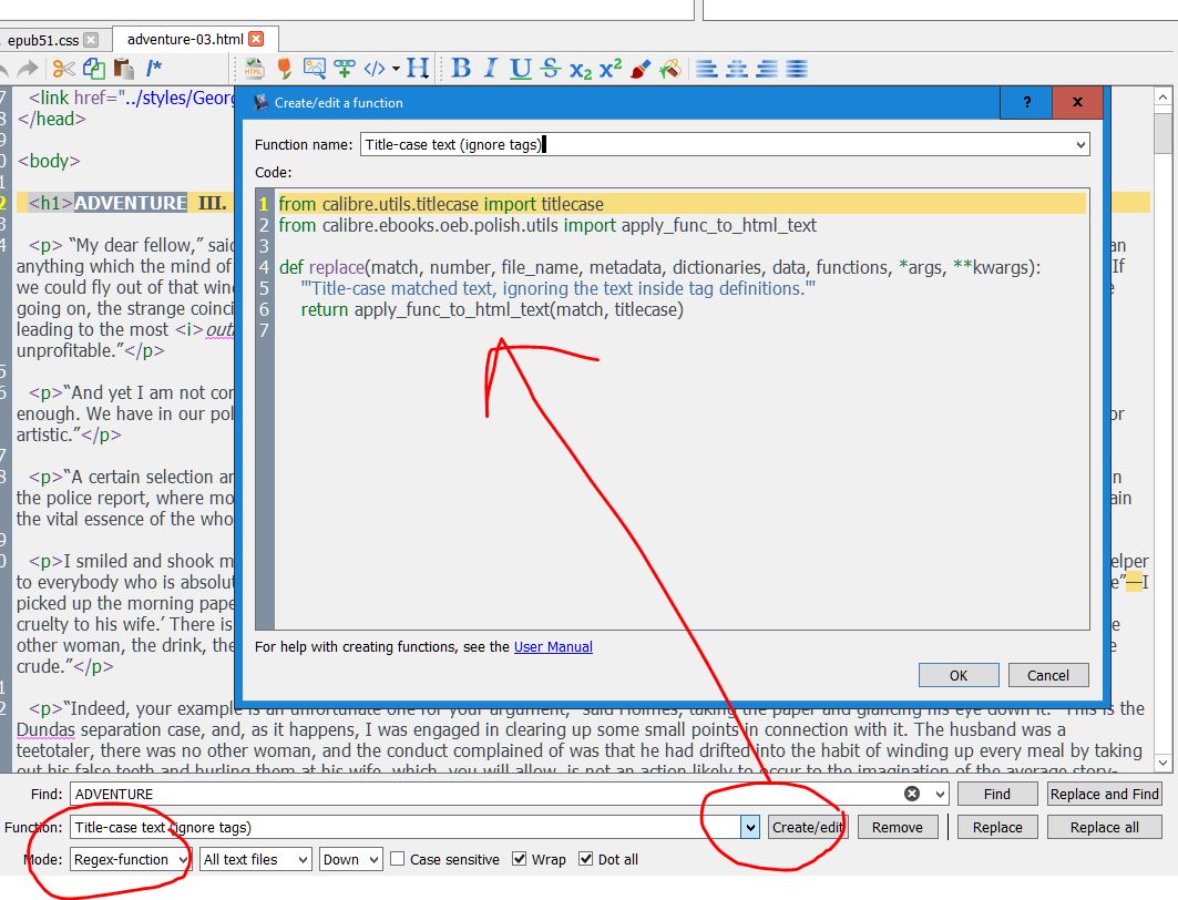

I actually run two steps: one to upper case headings, and then a second to title case them
These are my saved searches and this is the function listing for 'Title case text - Ignore tags'
from calibre.utils.titlecase import titlecase
from calibre.ebooks.oeb.polish.utils import apply_func_to_html_text
def replace(match, number, file_name, metadata, dictionaries, data, functions, *args, **kwargs):
    '''Title-case matched text, ignoring the text inside tag definitions.'''
    return apply_func_to_html_text(match, titlecase)

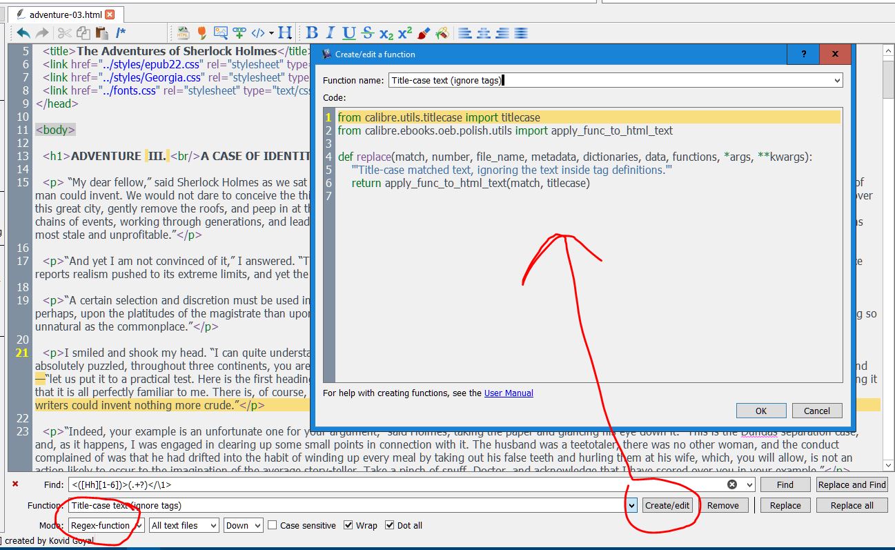

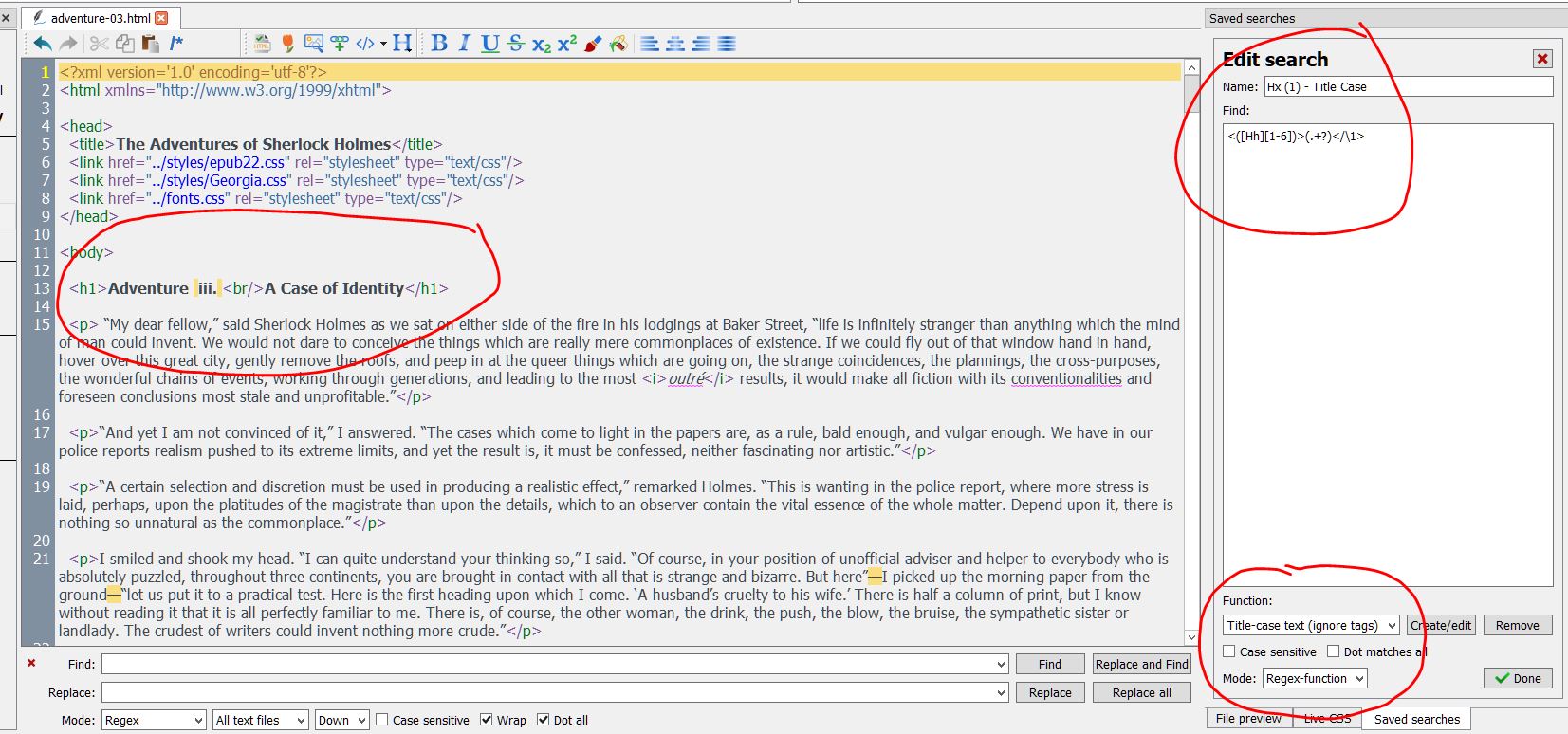

Yes, it was one of the built in ones that Calibre supplies
Automatically fixing the case of headings in the document
Here, we will leverage one of the builtin functions in the editor to automatically change the case of all text inside heading tags to title case:
Find expression: <([Hh][1-6])[^>]*>.+?</\1>
For the function, simply choose the Title-case text (ignore tags) builtin function. The will change titles that look like: <h1>some TITLE</h1> to <h1>Some Title</h1>. It will work even if there are other HTML tags inside the heading tags.

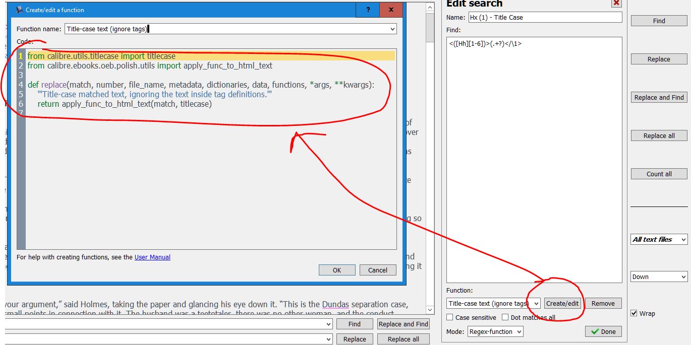

Don't know why. If I look at the 'code' for the function, I see the attached

What you have above looks like the default code if you open the function editor without a name in the "Function" field in the find box. And if you then use the "Function name" dropbox to select another function, it doesn't update the displayed code. I don't know if that is deliberate or not. I can see it working either way. If you select the function name in the find box, and then open the function editor, you get the code for that function.
