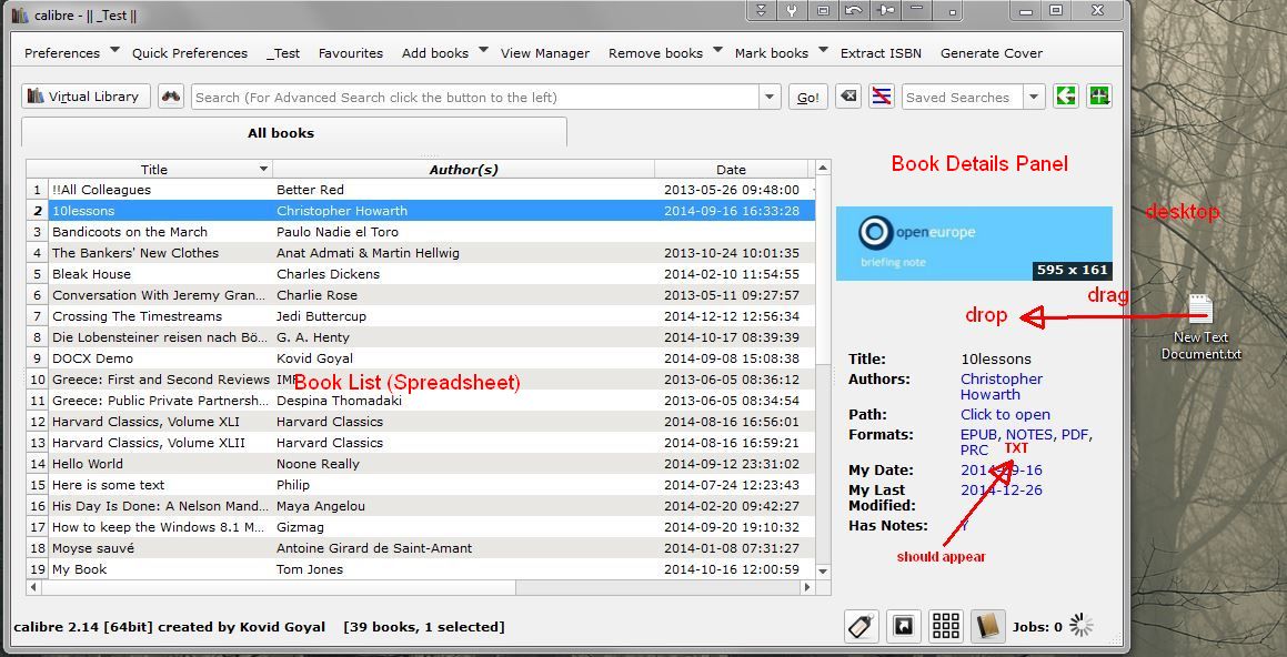

Okay… Next I created a simple Windows text file, opened up the sixty-four bit version of Calibre, and dropped the file onto a book. The program immediately froze and the usual window came up.

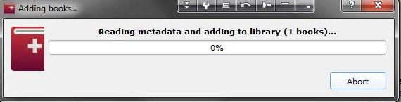

What usual window, I think of a 'frozen' program as one whose window goes milky with Not Responding in the Window title bar. Did you drag drop to the Book Details or Book List? The following image indicates what I hoped you'd do.

If you create the Text file on the desktop and drag/drop from there that will (hopefully) take Total Commander out of the equation. Do it in 32bit so that you have a benchmark - there shouldn't be any windows popping up.
BTW you can delete a format for a book by right clicking it in Book Details and selecting Delete XXXX format.
Interestingly enough, the files appeared on my desktop, which was theoretically immediately underneath the Calibre 64-bit window. They were moved from their original location, to the underlying desktop.
That is truly, truly bizarre - but potentially important. I'll assume that you drag/dropped the TXT file into the Book List, by 'usual window' do you mean this one ?

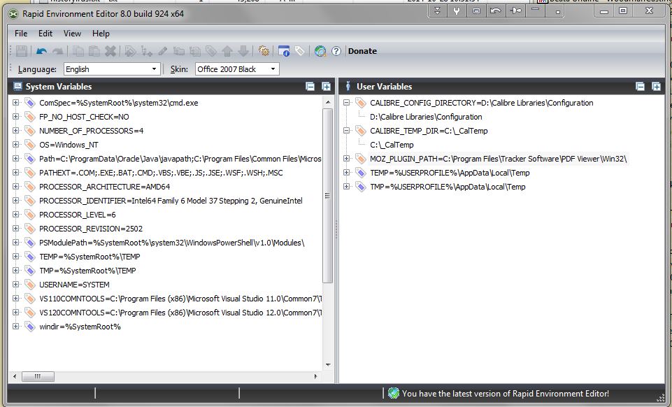

Now going to try creating the temporary directory and then create the environmental variable. Will report back when I have done this. Okay… I followed the directions for creating system variables in Windows. I created a variable with the name of CALIBRE_TEMP_DIR
<snip>
In any event, the 64-bit program locked up per usual. I will await further instructions on this.
That all seems fine to me.
Calibre looks for the CALIBRE_TEMP_DIR environment variable and uses it if its set, otherwise it uses the standard Windows Temp location. IIRC some of the previous 'inexplicable' problems that have been solved by using 32bit rather than 64 bit, were manifesting as permission problems on the Temp folder - which is also bizarre. Here's what I have
When you run calibre you should see a folder in the CalTemp folder with a randomly weird name (e.g. calibre_ya8u_p) - it may or may not have content, and it should get deleted when calibre exits normally. It probably won't get deleted when calibre crashes. Might be an idea to move it somewhere 'safe' in case we want to have a look at it, it might have some clues.

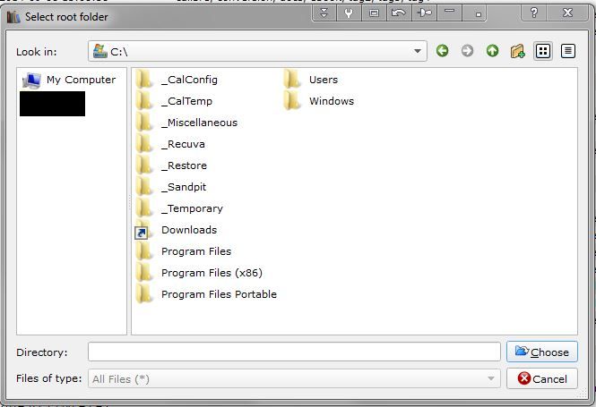

Did you try doing this
....go into the library folder and create an author folder (eg ZZZ Author) if that works create folder in there (eg ZZZ Book), if that works copy a couple of files into the ZZZ Book folder. That's essentially what happens when you add a new book for a new author - if it works then ??? then how come calibre has a problem. If it doesn't work then at least we'll know its not a specific problem with calibre. Don't forget to delete XXX Author etc.

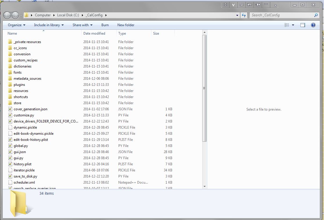

cybmole mentioned another possibility- the configuration data (appdata) - this is worth checking out.
But cybmole suggests you remove config data with the Revo Uninstaller, the problem with doing that is that the 32bit and the 64bit versions of calibre share the same configuration data, Revo will trash it. You have no problems with 32bit, but without the current configuration data it would be potentially 'crippled'. Hence I suggest you do the following.
You can get to the configuration data via Preferences->Miscellaneous->Open calibre configuration directory it should open in Windows Explorer, leave the window open and exit calibre**.
Then in that Explorer window, go up a level (select first item and hit backspace). You should be at somewhere like 'C:\Users\James\AppData\Roaming', with the folder 'calibre' selected, rename it to 'calibre_save'.
Now start calibre 64 bit, it will take you through the Welcome Wizard, which creates a fresh 'C:\Users\James\AppData\Roaming\calibre' folder with default contents. If your library is not in the default location with the default name (I think that's something like "C:\Users\James\Documents\Calibre Library") then you won't see it, but no matter, you can do a test with the default library the Wizard created - just try adding a book to it in your normal way.
If it doesn't crash, then something in the configuration data (in calibre_save) is causing the 64 bit version to crash but not the 32 bit - which is very strange.
If 64 bit crashes then we have eliminated the config data as a possible cause.
Delete the 'C:\Users\James\AppData\Roaming\calibre' the Wizard created, and rename the 'calibre_save' folder back to 'calibre' - that will re-establish the existing configuration which the 32bit version can use.

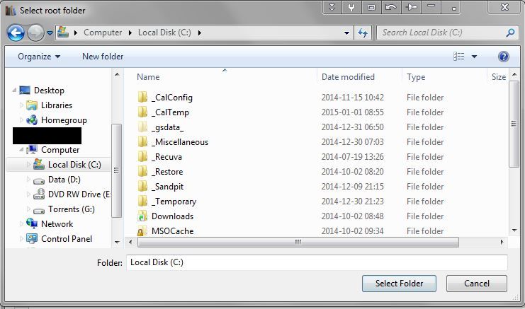

Anyway… When I use Windows Explorer in order to drop the text file into the 64-bit program, it locks up. The 32-bit version seems to work flawlessly.
This is a screenshot from item number four - on my computer using the standard Windows environmental editor which admittedly is a bit weak.
But I think you can see the necessary information.
Also, I do get directories created in that CALIBRE_TEMP directory when the 64-bit and/or the 32-bit version start. I have not looked at them in detail.
I checked the couple of times after the directory and variable were created. There's always stuff in there. Provided that you have run either versions of Calibre.
And by the way this stuff does not disappear when you close the programs. Let me amend that.
The directories don't disappear but I'm not certain there is always material left in the directories, when the programs are closed.
Okay… Next is item number five. The short answer is yes I can create folders, and books. I'm going to post a screenshot from total commander
The window on the left shows the sorted author directories [sorted by name] and the bottom one you will note is zzz Author make-believe folder.
The right window shows you the actual text file that I created which is called Make-Believe Book.txt
and finally… The insert window is the Lister which shows the contents - only one sentence fragment that actually is the entire text file.
As far as the configuration data suggestion goes, we did this. You suggested that I zip up the entire configuration data directory which was located in user/my name/AppData/roaming/documents/Calibre etc. I did zip up that file and copied the zip file to a separate hard drive. I deleted the directory in its entirety. Then I reinstalled Calibre 32-bit version, went through the wizard, and it worked normally. Not knowing any better, I uninstalled the 32-bit version, re-deleted the orphan configuration data directory, and then reinstalled the 64-bit version of Calibre. I did go through the wizard again as you noted I would. However the 64-bit version still locked up. So I thought that eliminated the configuration data directory as being the problem. By the way I chose - in both cases the 32-bit and the 64-bit re-install - a new vacant directory to be the library - that had zero books in it.

It did start normally, but it simply froze up when I clicked on add a book and then told it to add a book expecting that there would be one book in each directory etc.
And finally, preferences/miscellaneous/open config in the 64-bit works normally. Here is the screenshot:
It's the 64-bit version – with the preferences window opened up, and you can see the Windows Explorer indicating the location of the config information files.

i am wondering if the lock up is at the point where calibre needs to display a pop-up window to say "adding books", and maybe it's the action of creating the window that is at the heart of this, not the underlying file/folder activity.
which would point at some issue with video drivers ?

Next up was the variable that you recommended I set to a value of 1.
CALIBRE_NO_NATIVE_FILEDIALOGS
I set this variable to a value of 1.
The 64-bit program still froze in the same way when I attempted to add books.
The 32-bit version worked normally.
By the way – I assumed that it was not necessary to restart Windows in order to get the environmental variable operational. In other words as soon as you complete the edit it's done. That may not be the case. Please let me know if I need to restart Windows after changing and environmental variable. This is beyond my expertise.

When you set the environment variable and start calibre, how exactly are you doing it?
Setting the variable from a command prompt, and then starting calibre from the Desktop won't work; the environment variable set is local to that command prompt (and to any programs started from that command prompt).
You need to launch calibre by typing calibre into the command prompt where you have just set the environment variable.
Old 12-31-2014, 04:45 PM   #28
Posts: 22,833
Karma: 34252730
I suspect the OP is using Control Panel->System->Advanced->Environment Variables which sets them in the registry so they persist, from an earlier post by James
Originally Posted by jamesgl
"on my computer using the standard Windows environmental editor which admittedly is a bit weak. "
James if you are doing it at the command line, and you want to make the setting persist then use this command SetX - Set environment variables
Can you confirm that when CALIBRE_NO_NATIVE_FILEDIALOGS is set to 1 that in the 32bit (and the 64 bit) the file dialogues look like this:
rather than this:
