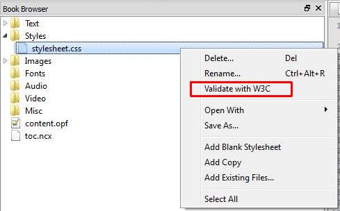

Old 12-13-2014, 06:59 PM   #23
Posts: 22,085
Karma: 30277960
Originally Posted by rosshalde View Post
The only time a .css file opens in a default program (safari) is if I am dealing with a css outside of Sigil...clicking directly on the css in some folder directory.
In Sigil, if I click the css, it just opens a tab in Sigil to display it, but absolutely nothing (that I can see) happens when I try to use the CSS validation tool.
I will wait to hear from a Mac user to see what they are doing differently (besides getting a PC)
Right click the stylesheet, select Validate with W3C.
NG Macs have a two button mouse - don't they?
Name:	Screenshot - 2014-12-14 , 09_54_38.jpg
This brings up a good point. There are two ways to validate css: from the context menu of css files in the Book Browser, and from the Tools menu in Sigil's main menu.
@rosshalde:
Do both methods appear to do nothing?
