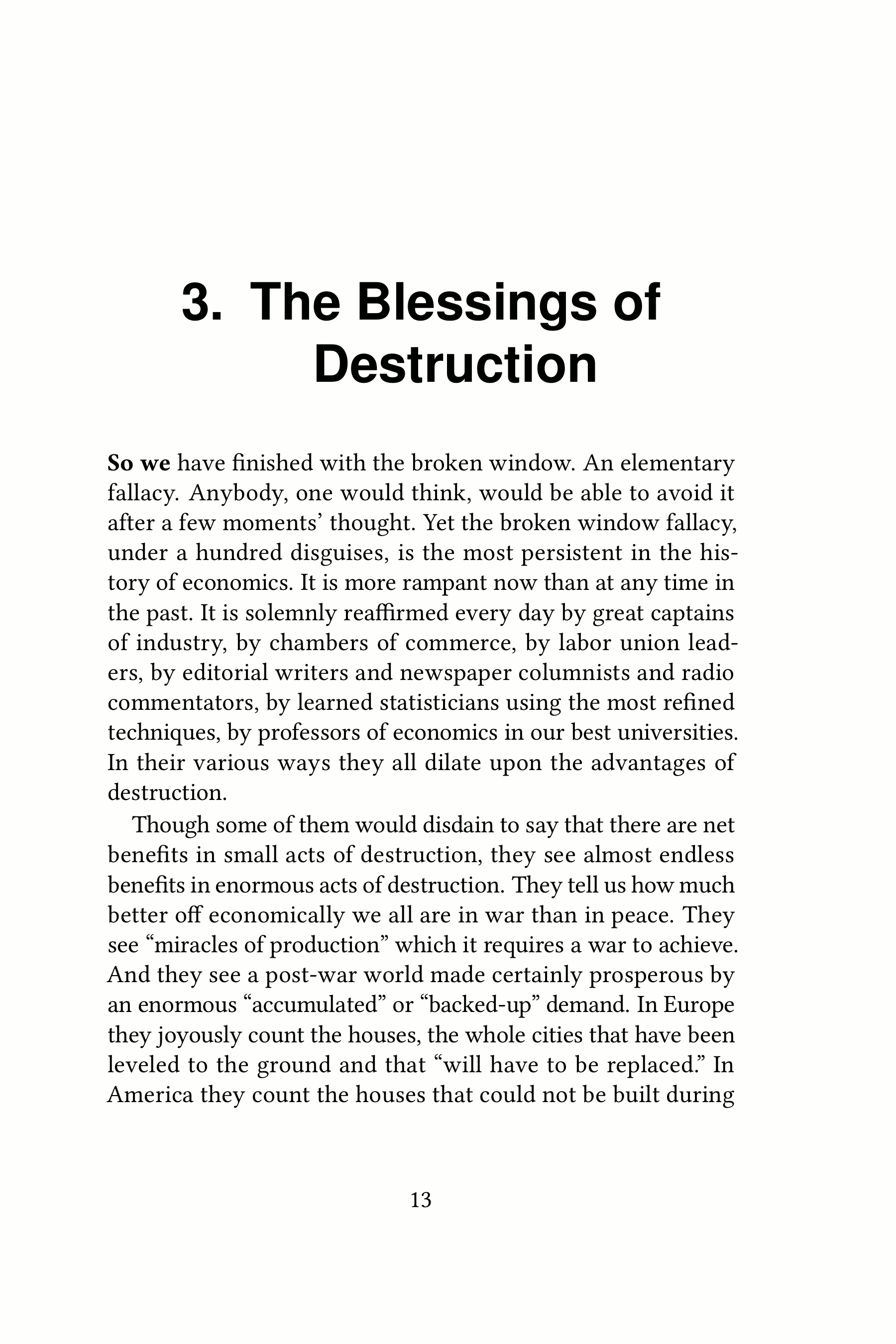

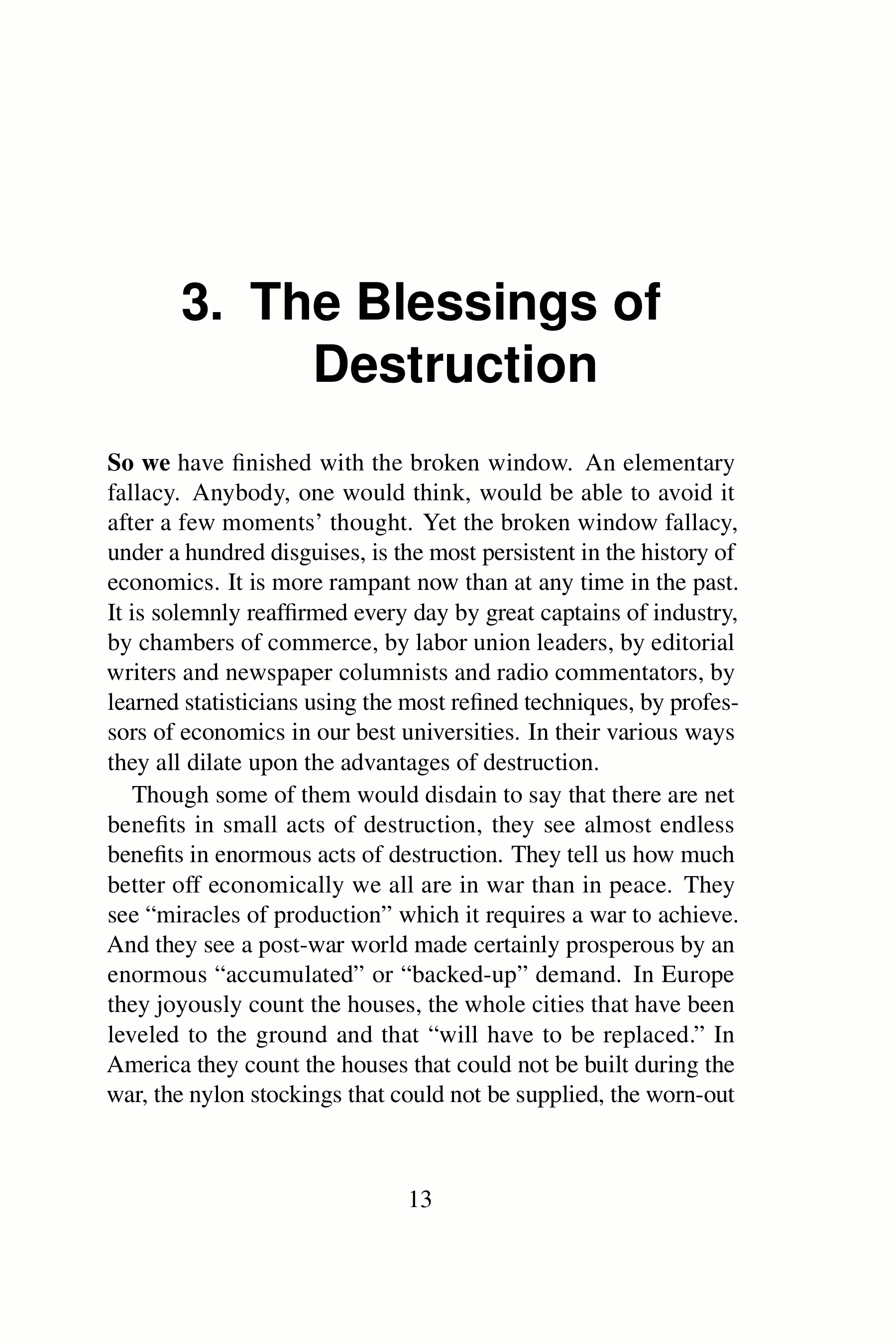

Font Change (Linux Libertine -> Times New Roman):
ID:	131052 Click image for larger version
Note: These look nearly identical, but slight differences in kerning (Times New Roman is a little tighter).
As you can see in the Libertine version, "his-tory" is hyphenated between lines. That is 7 characters. This sort of situation would have been DENIED if you go "8 characters or more".
Side Note: No no, don't come back making a post saying "then I will enable hyphenation on all the words with 7 OR MORE CHARACTERS instead!"

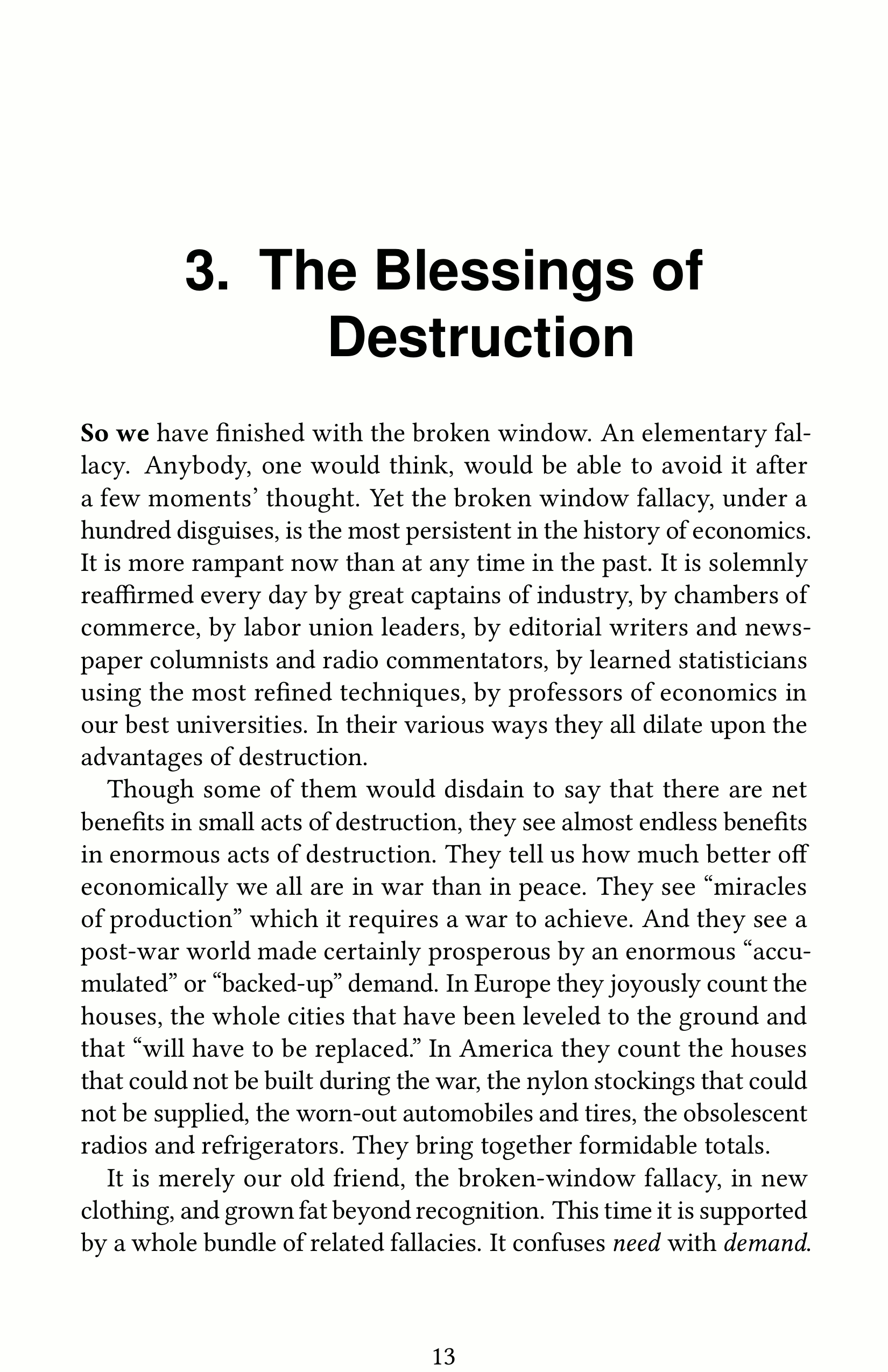

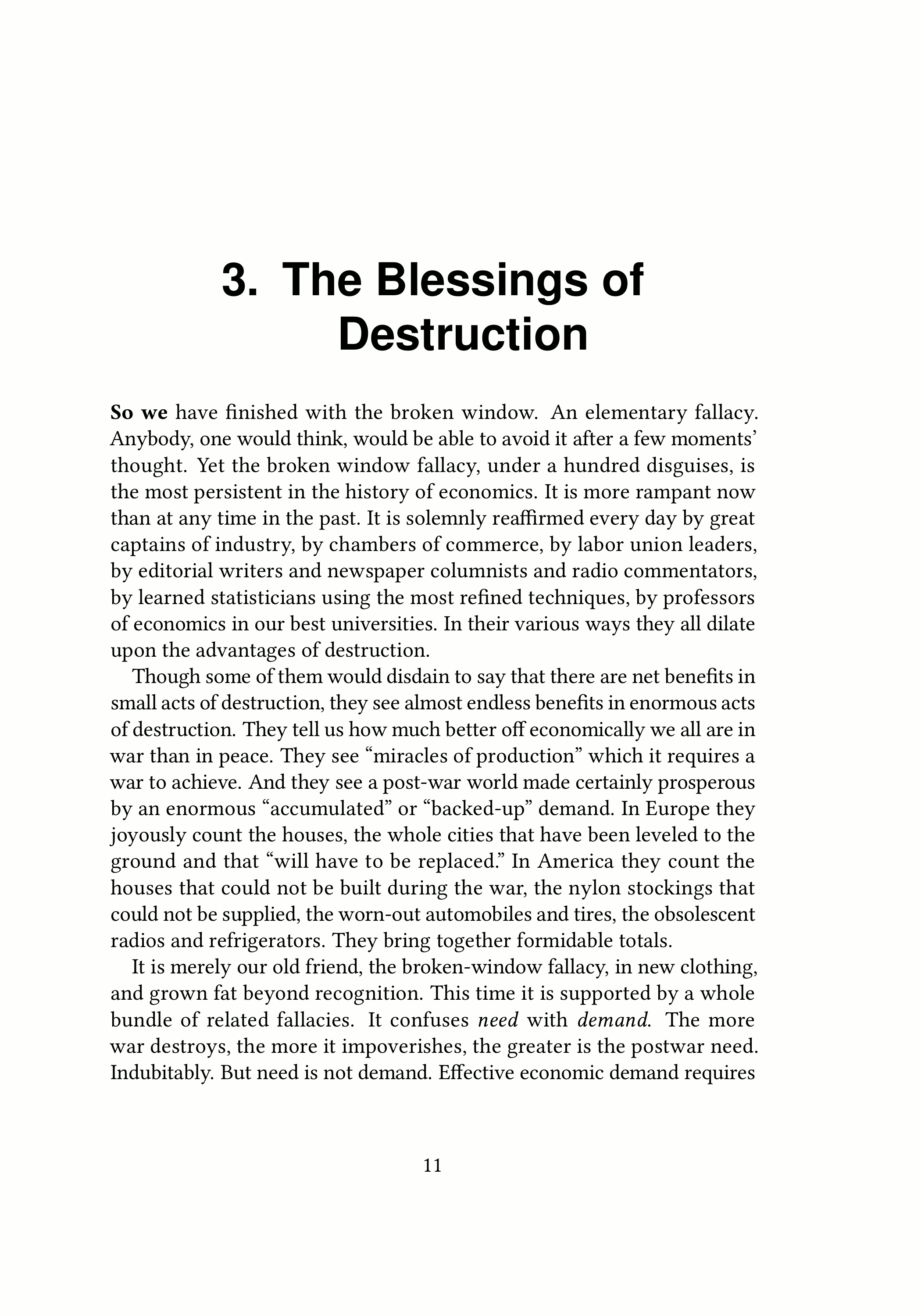

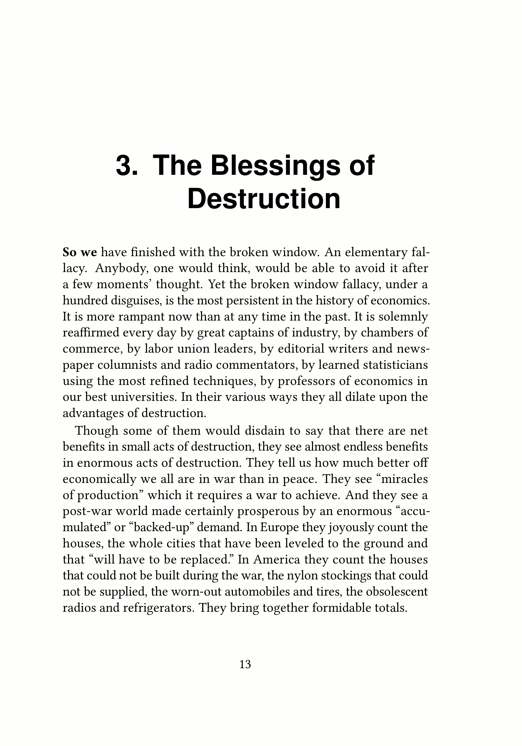

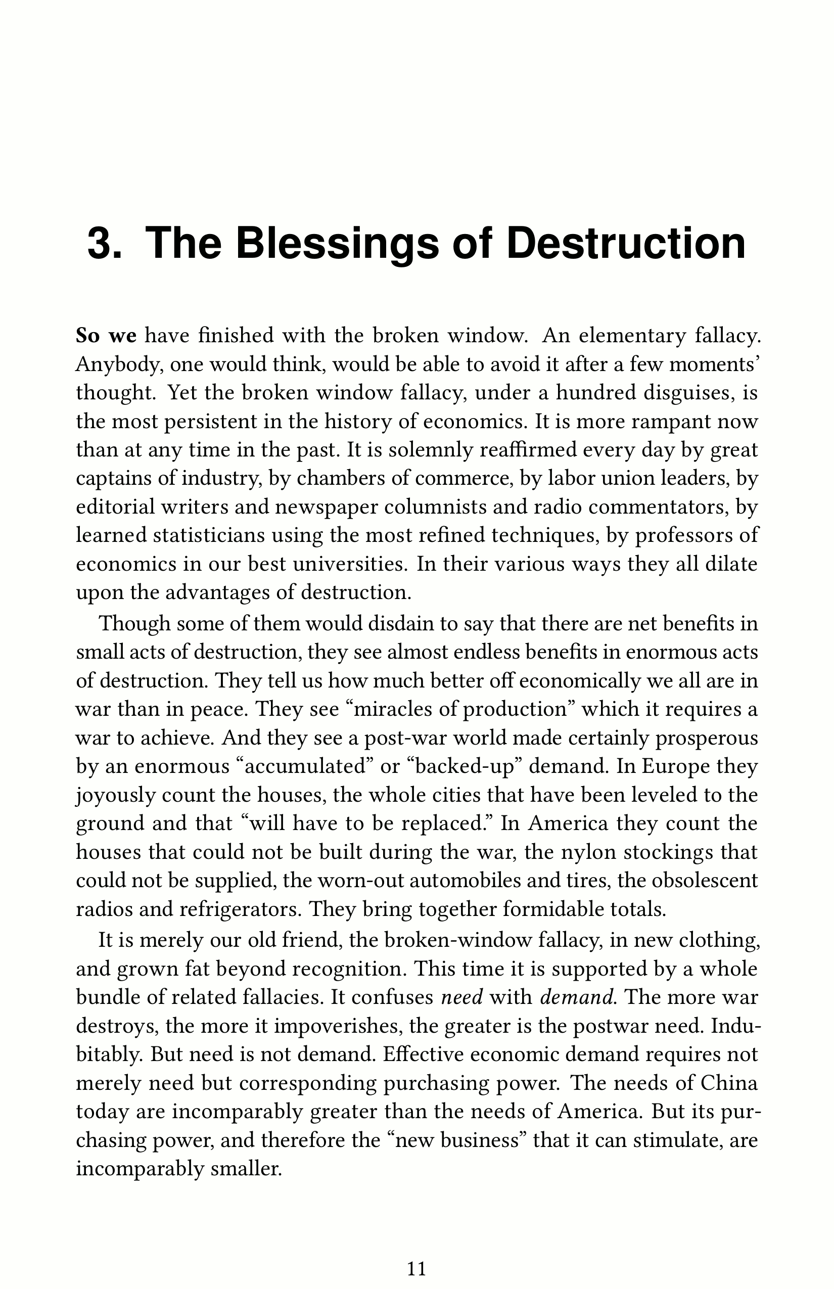

Page Size Changes (5.5"x8.5", 6"x9", 7"x10"):
ID:	131051 Click image for larger version
Note: Minor margin tweaks between them.
Font Size Change (12pt -> 13pt):
ID:	131054 Click image for larger version
Font Size Change (12pt -> 11pt):
And this is keeping nearly all variables CONSTANT, and only tweaking ONE thing at a time. This is not taking into account differences in programs (for example, Word/LibreOffice have slightly different hyphenation/justification algorithms, iBooks/Marvin will hyphenate/justify slightly differently, Nook might justify/hyphenate one way, and Kobo might justify/hyphenate a completely different way). Maybe one says "allow hyphens on every line", and another one says "only allow hyphens twice per paragraph".

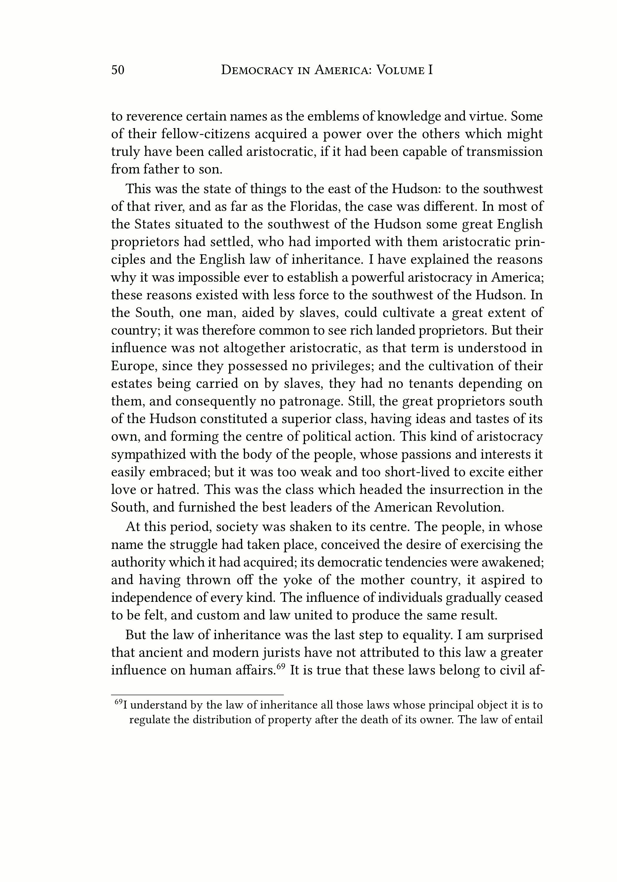

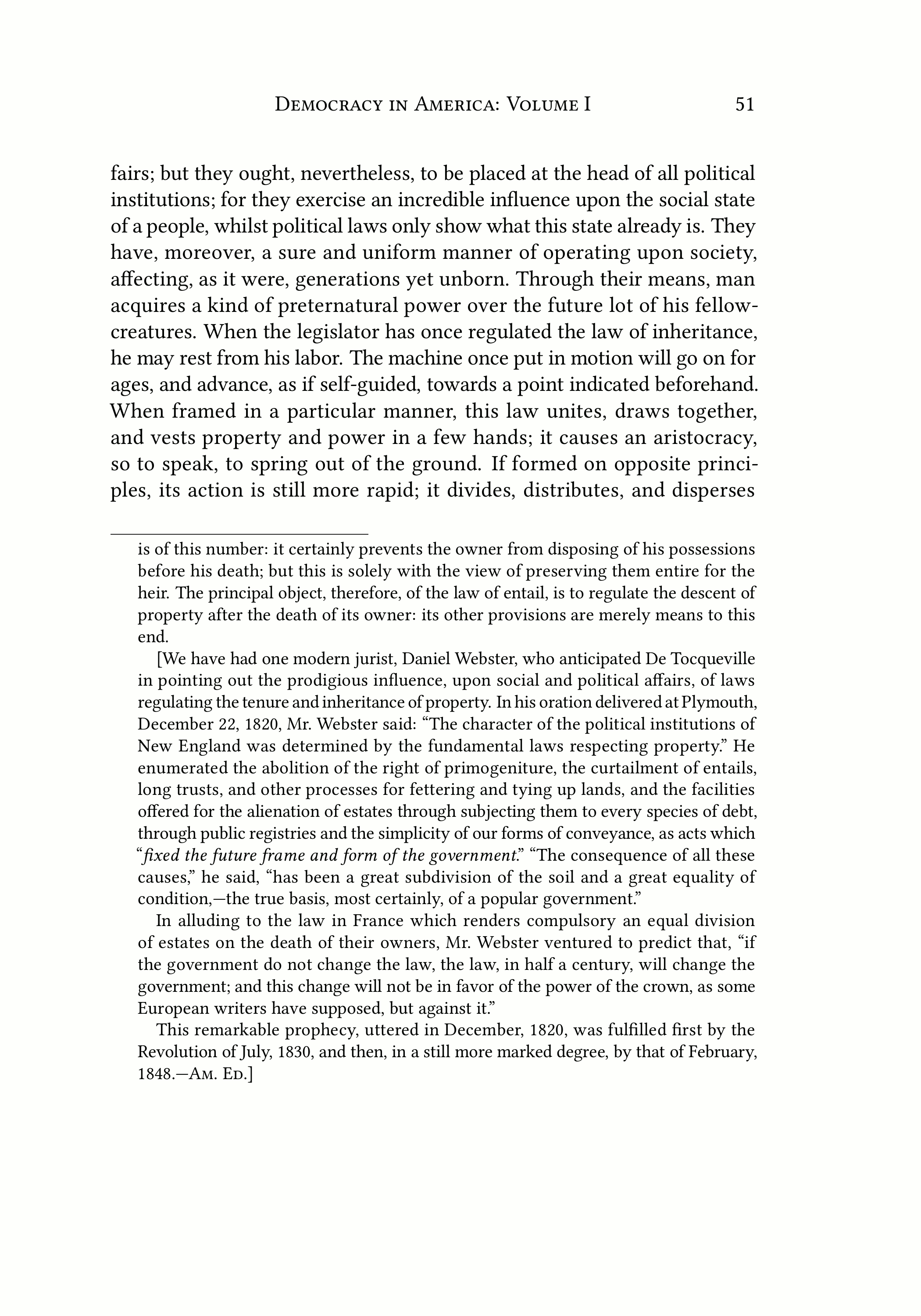

Other Edit: A lot of this is also a little tough to see, because you have to see the cascade/waterfall effect that happens due to a very minor tweak. Now, while this isn't SPECIFICALLY a "hyphenation" example. You can see what happens in this print book when I make an extremely minor adjustment to the negative indent in the footnote (if I remember correctly, I believe this was 1.2em (or 1.1?) to 1em?).
Page 50 Before/After:
ID:	131056 Click image for larger version

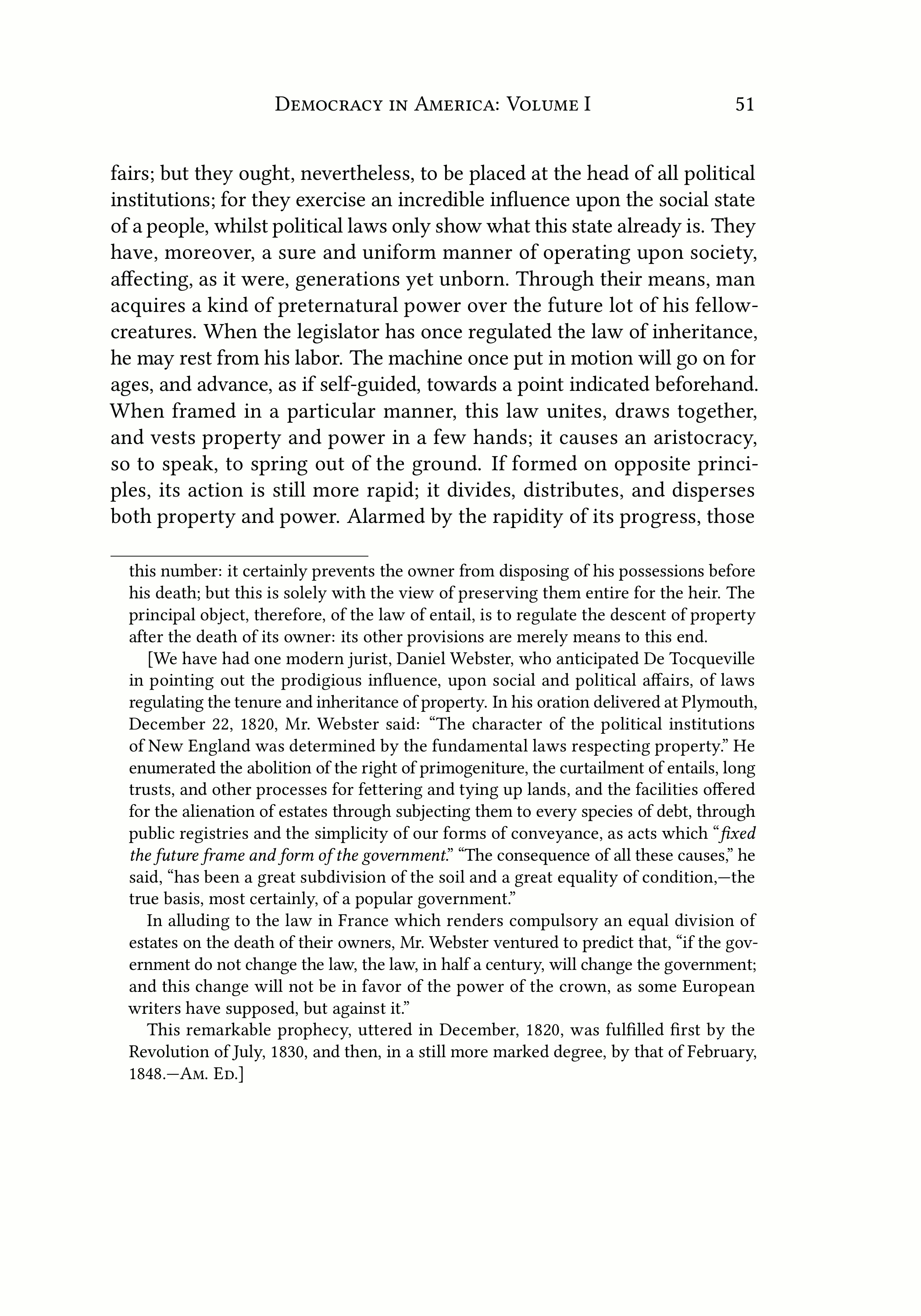

Page 51 Before/After:
ID:	131058 Click image for larger version
As you can see, just that little change on Page 50, two little words "is of", then cascaded, to effect further on in the book. Again, if you need more examples, I can then do a SPECIFIC hyphenation problem. And show what can happen when disabling hyphenation in certain words. It has the potential to completely change the look of a chapter!
And imagine, if I did all of this painstaking manual "fixes". A minor change, could cause me hours of grief in the future. Best to just keep the fixes as "broad" as possible, and stay the heck out of the way.
