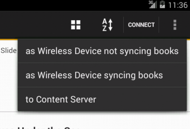

Old 10-11-2014, 11:31 AM   #26
kaufman
Calibre Companion Fanatic
kaufman ought to be getting tired of karma fortunes by now.kaufman ought to be getting tired of karma fortunes by now.kaufman ought to be getting tired of karma fortunes by now.kaufman ought to be getting tired of karma fortunes by now.kaufman ought to be getting tired of karma fortunes by now.kaufman ought to be getting tired of karma fortunes by now.kaufman ought to be getting tired of karma fortunes by now.kaufman ought to be getting tired of karma fortunes by now.kaufman ought to be getting tired of karma fortunes by now.kaufman ought to be getting tired of karma fortunes by now.kaufman ought to be getting tired of karma fortunes by now.
kaufman's Avatar
Posts: 873
Karma: 1088610
Device: Galaxy Note 4, Kindle Voyage
What I could do is add an "Ask on connect" option to CC. If set, CC would pop up a dialog when you tap "Connect as wireless device" asking you if you want to sync books during this connect.
That would be great. Thanks.

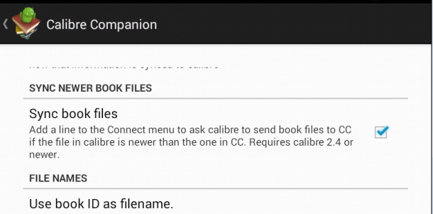

Old 10-11-2014, 12:39 PM   #28
chaley
Posts: 12,529
Karma: 8075938
Location: Notts, England
You could also make it a check box on the connect dialog.
Can't do a check box that works in a natural fashion, but I can do two menu lines.
I did it without adding an option. Instead I changed the meaning of the existing option to show another line on the connect menu. These screen captures show what it looks like.

Old 10-11-2014, 12:41 PM   #29
kaufman
kaufman's Avatar
Posts: 873
Karma: 1088610
Love it. Perfect.
