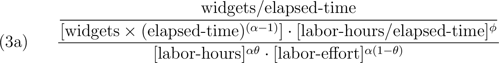

I attached a ZIP file of 81 formulas at 350dpi I just generated using LaTeX (using the CodeCogs GUI) + Imagemagick.
The same sort of thing can be accomplished using my Tutorial.... although I am now seeing the superiority of LaTeX in this case, because I can shove LaTeX right in the alt attribute.
This makes it super easy for me to plop it back into LaTeX, do any corrections, and generate a new formula if needed. Or in the future, quickly converting the image into a more PROPER formula (SVG, MathML, straight LaTeX), or being able to easily update math fonts/kerning/typography at the flip of a switch.
This is what I settled on, with the LaTeX used to get the formula in RED:
<div class="formula">
<div class="image"><img alt="\frac{\displaystyle\frac{\text{widgets} / \text{elapsed-time}}{[\text{widgets} \times (\text{elapsed-time})^{(\alpha-1)}] \cdot [\text{labor-hours} / \text{elapsed-time}]^\phi}}{[\text{labor-hours}]^{\alpha\theta} \cdot [\text{labor-effort}]^{\alpha(1-\theta)}}" src="../Images/QJAE8.4.4-pg055-Formula3a.png" /></div>
</div>

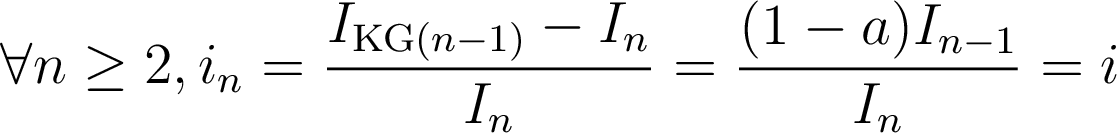

<div class="image"><img alt="\forall n \geq 2,i_n = \frac{I_{\text{KG}(n-1)}-I_n}{I_n} = \frac{(1-a)I_{n-1}}{I_n} = i" src="../Images/QJAE10.3.1-pg203-3.png" /></div>
</div>
