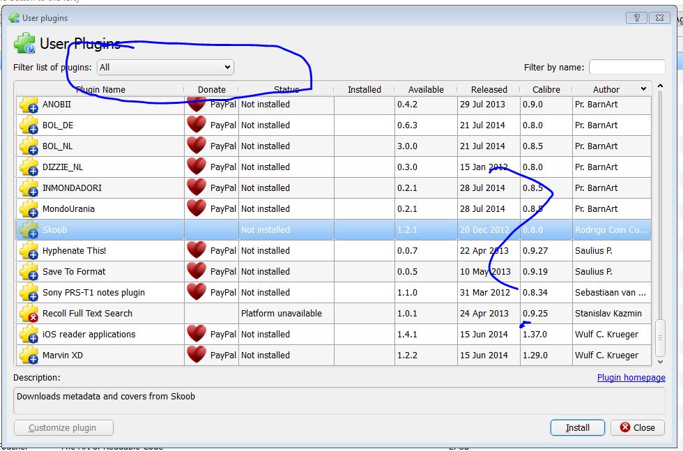

You might also check out the forked version of ePub Clean plugin for calibre that has some support for removing SPANs
I can find a Modify ePub PI, but no ePubClean PI
Modify ePub does not seem to have any options to clean unneeded tags etc.
Old 07-28-2014, 07:50 PM   #24

You need to look for the version posted by Reverend Bob.
Sorry, but I still don't see anything close to that title or by Rev Bob.
Can you point me in the right direction please?
It's not indexed -- it is in the Modify EPUB thread, and will eventually get merged back into the main PI, once Rev. Bob finishes testing it. See here for the latest beta: https://www.mobileread.com/forums/sho...78#post2880178
