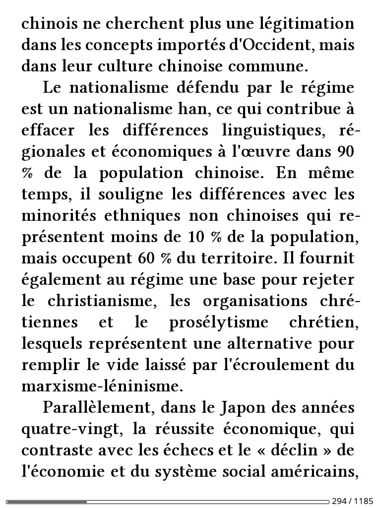

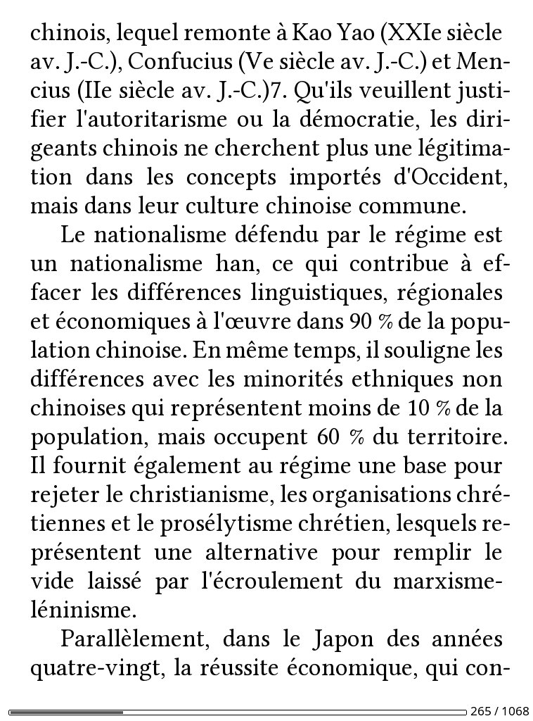

As the advised tweaking of the font.hinting.mode brought no discernible change for emboldening, I realized that there should be another reason: my mistake was that I had kept the the "embedded style" ON while I was using a side-loaded font...
Now, when I select "embedded style": OFF, I got these results for "regular" and "bold (see screenshots) using my side-loaded font. The emboldening looks a little too strong. Such a setting cannot probably be kept for a whole book.
It would be precious if the user could have some control over it (like for frontlight levels).

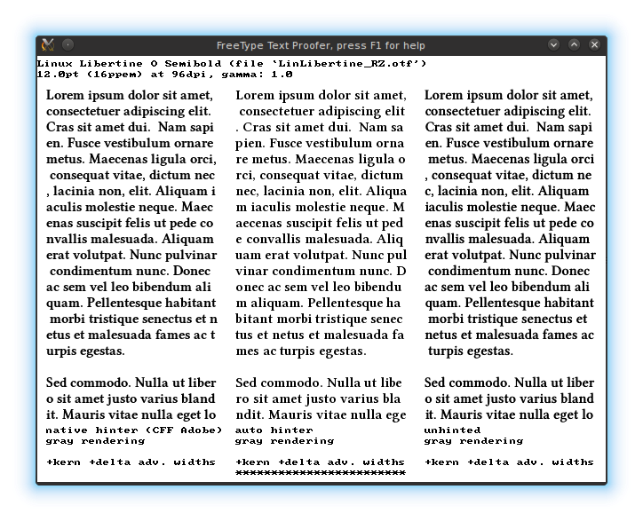

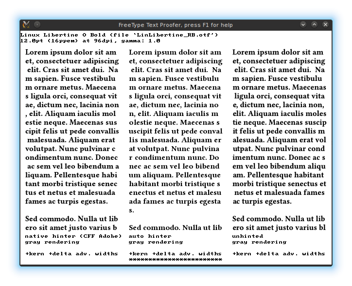

Well, apparently, it's just *that* bold, and in fact, the lightest rendering mode is the autohinter.
EDIT: Haha! It's that bold, because there's also a SemiBold weight .
Which ones are you using? (If you're *not* using any of the bold variants, the boldening will be synthetic, and that's also usually ends up being *very* bold).
