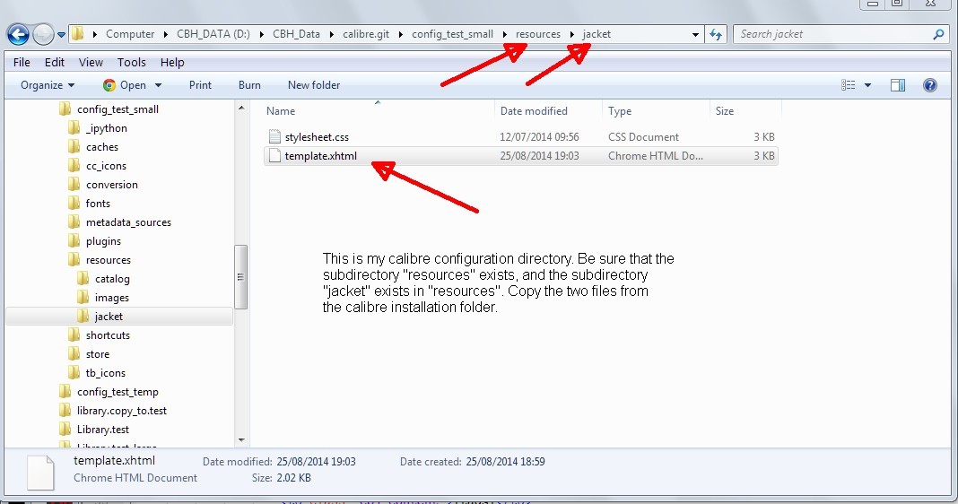

Originally Posted by GeckoFriend View Post
My series index have always shown in the jacket as decimal numbers. Two or three days ago they started showing as Roman numerals. I have confirmed there is no tick in the use Roman numerals box. What can I do?
Start with the directions in the thread https://www.mobileread.com/forums/sho...d.php?t=156634, and in particular in the second post.
Once you have the file template.xhtml in your configuration folder, open it with an editor and change "series.roman" to "series" and described by the comment in the file.

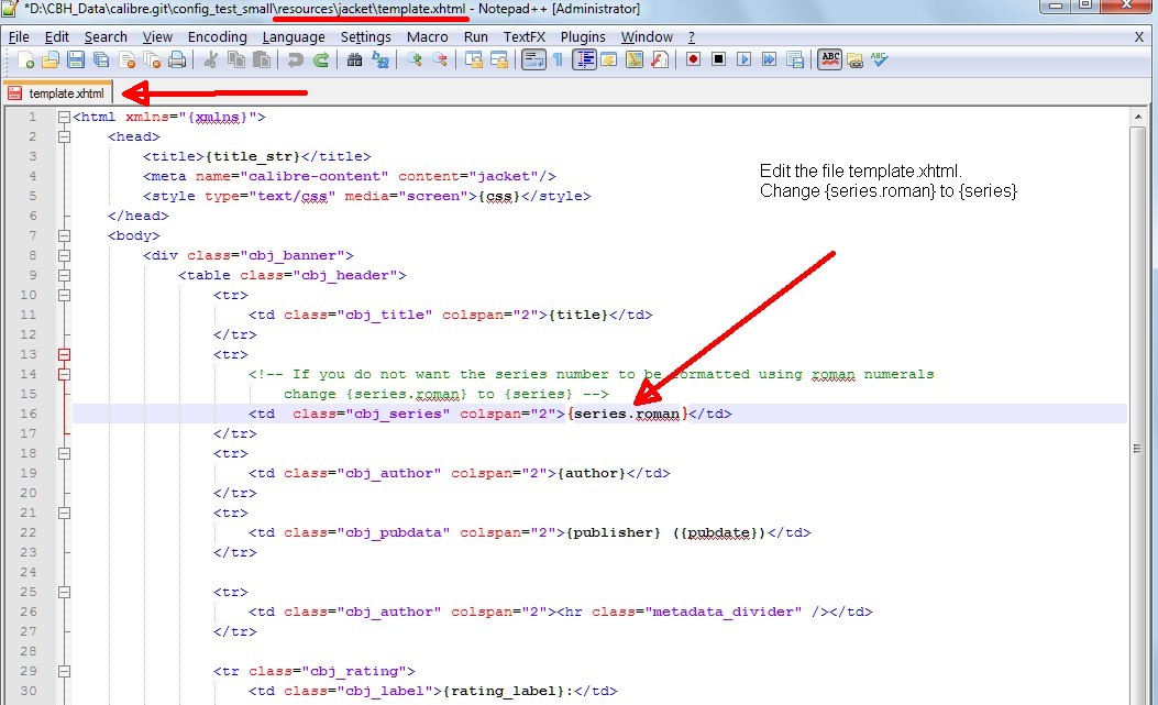

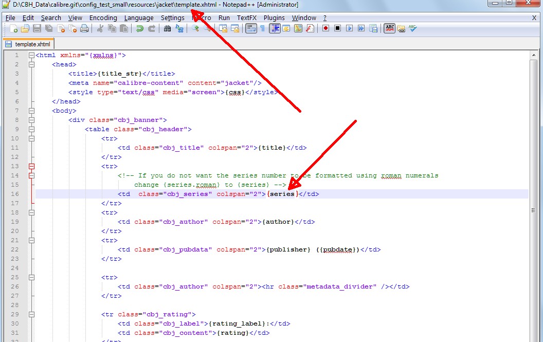

Because after some discussion with users in various threads, Kovid decided to make the change.
The change works fine for me. The screen shots show what I did.
ID:	127293   Click image for larger version
ID:	127294   Click image for larger version
ID:	127295   Click image for larger version
Last edited by chaley; 08-26-2014 at 02:28 AM. Reason: Fix first image to show how to open the calibre config directory

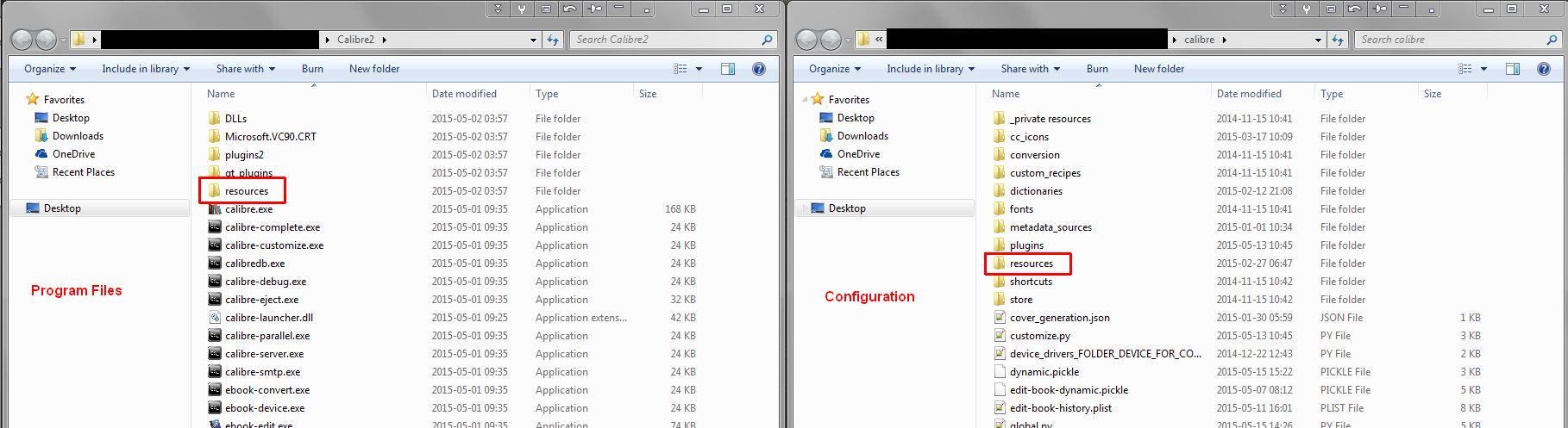

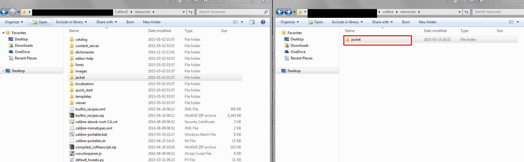

@bettyruthe - in Windows Explorer Locate the Calibre2 folder in -- Program Files (if you use 64bit calibre) or Program Files (X86) (if you use 32bit calibre) - keep the window open
In main GUI program (library manager) go to Preferences->Miscellaneous and click Open configuration directory that will open your Calibre Config folder in Windows Explore - it'll be something like c:users\<you>\appdata\roaming\calibre - keep the window open.
Close calibre. So now you will have two windows explorer windows - something like this

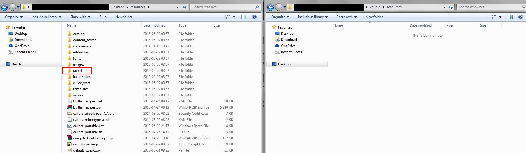

If you don't have a resources subfolder in the configuration folder create an empty one - I'll assume that you didn't have one
So open the two resources folders and you should see something like this

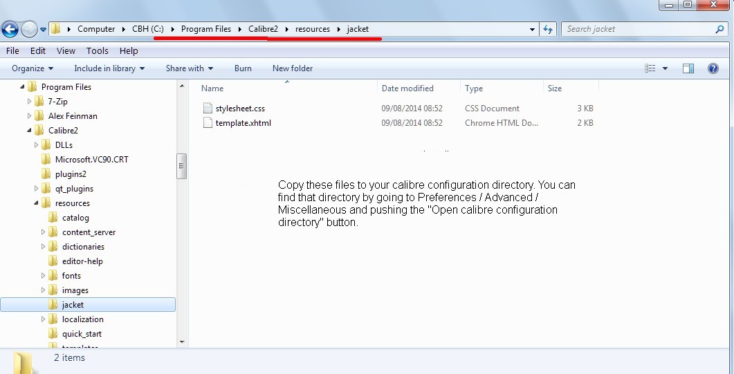

Now you need to COPY the jacket folder from the Program Files/resources (left) to the Configuration/resources (right) so you end up with this

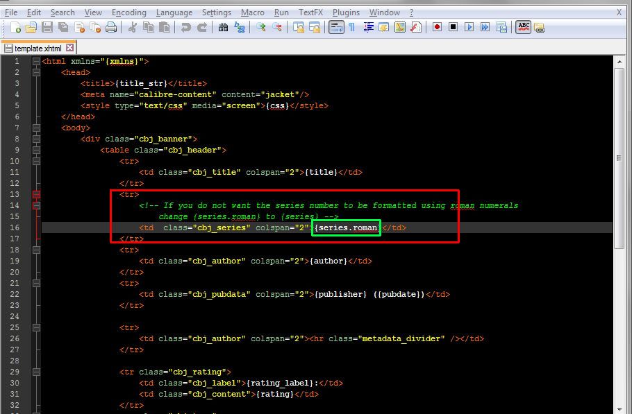

OK we've finished with Program Files so close that window and open the jacket folder in the Config Zone - there are two files
stylesheet.css
template.xhtml
You need to edit template.xhtml, but first you must remove read only, right click the file and select properties - uncheck Read Only and click OK
You need an editor other than Notepad - a lot of us use Notepad++, viz
While I was there I made the change so I've attached the template.xhtml file (it's in a zip - can't upload xhtml), try to do the change yourself - but if you get into trouble just use the one below
