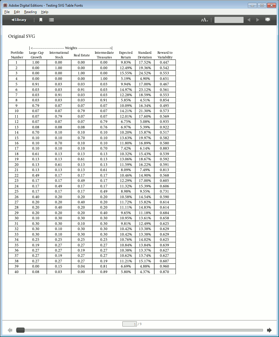

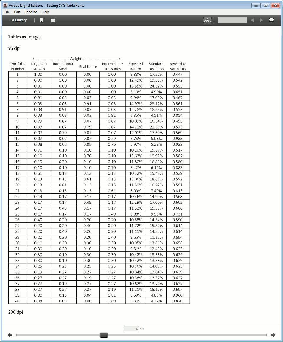

I opened up the SVG in a text editor, and spotted this:
<tspan
style="font-size:11.03999996px;font-variant:normal;font-weight:normal;writing-mode:lr-tb;fill:#000000;fill-opacity:1;fill-rule:nonzero;stroke:none;font-family:Calibri Light;-inkscape-font-specification:Calibri"
x="0 5.59728 8.3793602 14.039999"
y="0"
sodipodi:role="line"
id="tspan3148">0.00</tspan>

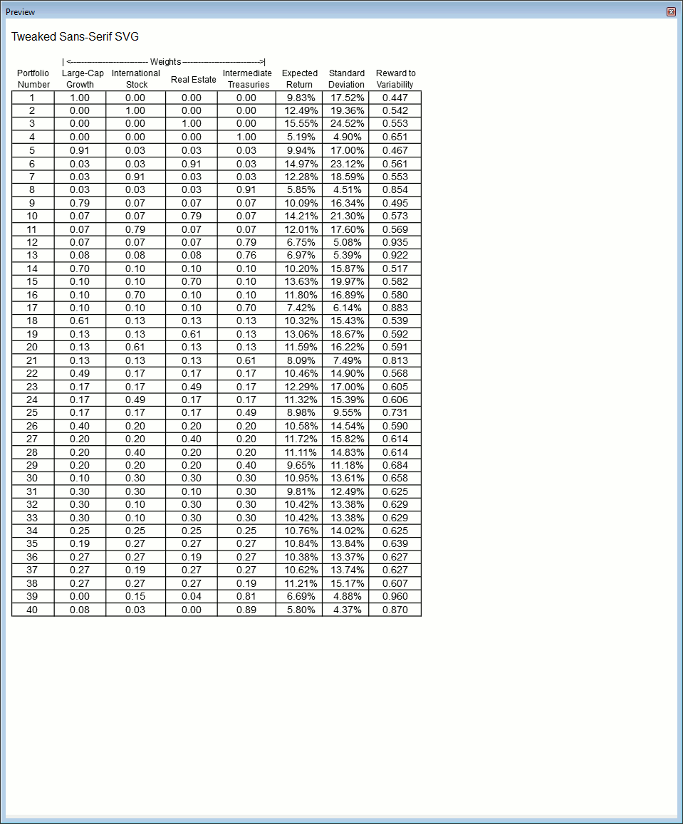

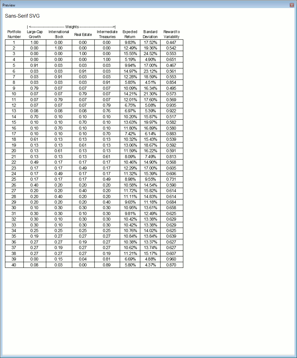

As you can see, it is specifying a font. Anything prefaced with -inkscape can be tossed in the trash, that is only for Inkscape specific stuff if you ever wanted to reimport it back in (useless if you are sticking it in an ebook).
I did a Replace All and replaced everything in RED with what DaleDe mentioned above:
<tspan
style="font-size:11.03999996px;font-variant:normal;font-weight:normal;writing-mode:lr-tb;fill:#000000;fill-opacity:1;fill-rule:nonzero;stroke:none;font-family: sans-serif"
y="0"
This made the table display using a sans-serif font (I also tested on my Nook, and the font was the sans-serif font):
Before: Click image for larger version
ID:	124132 After: Click image for larger version
When using any non-Calibri fonts, letters ran into eachother (seen in the After picture above).
I wittled the error down to the part marked in BLUE (I think this is specifying an exact location of each letter along the x-axis?):
<tspan
x="0"
y="0"
I changed them almost all to x="0" and it solved a bunch of the characters running into eachother problem:

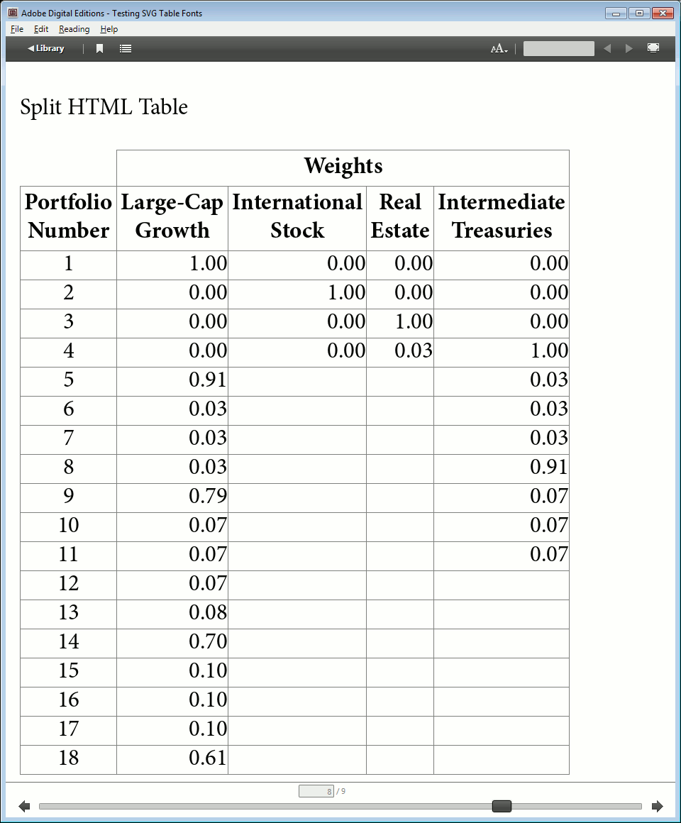

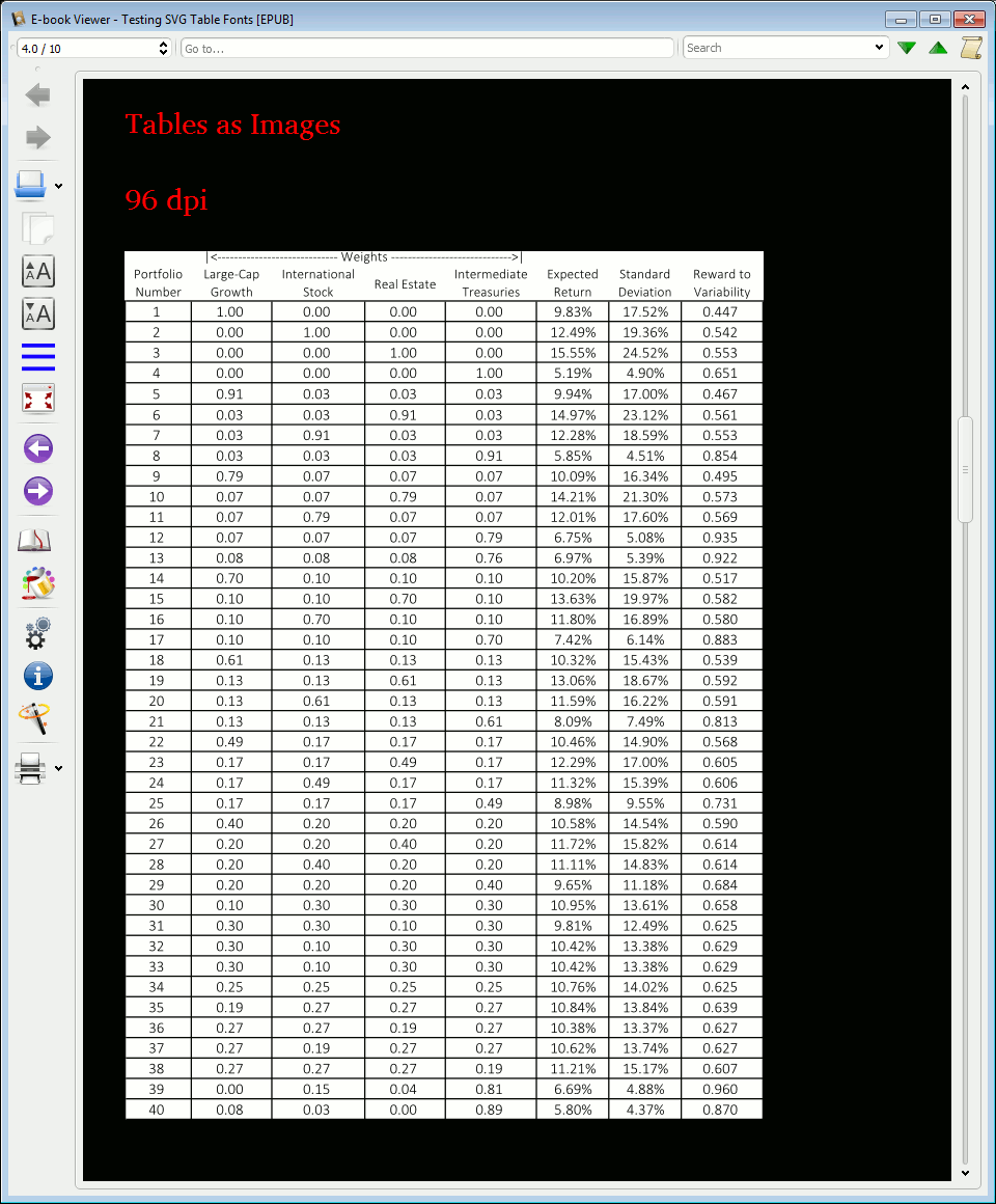

The EPUB includes:
  • Your Original SVG
  • An SVG where I implemented the RED change
  • An SVG where I implemented the BLUE change
  • 96dpi + 200dpi + 300dpi images which I generated from your SVG.
  • Original + Blue expanded to 100% width via CSS
    • It seems to overflow off the bottom of the page on thinner devices.
      • Instead of that junky CSS, it would probably be much better to just emulate something along the lines of the typical SVG Cover code, which will stretch to max width and/or max height while keeping the same aspect ratio.
  • HTML Table + a Split HTML Table (with some rough CSS to align/border cells).
    • This table CSS is junk, and doesn't work across devices, do not copy it. I just quickly put it together with no serious testing.
    • Side Note: The SVG information wasn't easily copy/pastable out. So I manually filled in a portion of the table.
      • Point proven... SVG/Images, NOT EASILY COPY/PASTABLE.
Anyway, I had a giant tome written tackling a lot of your statements/questions + a ton of screenshots... but it will take me a while to go through and edit it (and I am too tired currently). I will maybe post it tomorrow/in a few days tackling/discussing a few more of the things that were brought up.

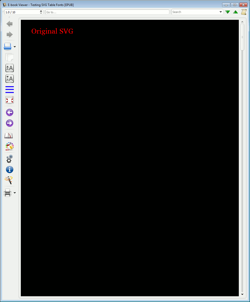

There is a serious bug with the SVG tables. If they are too long for the page, they run over to the next page and if they are still too long, you don't see all the rows.
The HTML table splits at whatever rows don't fit and moves them to the next page properly. My suggestion is to forget SVG and stick with HTML for tables.

Well, if you open up the SVG, you can see the internal measurements of your large table is:
width="577.20001"
height="789.90002"
To my knowledge, if you just plop the SVG into your ebook, the device will render it at a 1:1 ratio (~577px x ~780px).
If your device does not have enough pixels for that width/height, the image can flow off the edges of the device (just like your typical too large image, that isn't resized via CSS).
I attached a new EPUB with the typical "Cover" SVG Wrapper that many use.
I wrapped it around the table + tweaked the width/height, so now it should resize to fill the entire width/height of the device, while maintaining a proper ratio. (Tested it on my Nook, it works perfect).
<svg xmlns="http://www.w3.org/2000/svg" height="100%" preserveAspectRatio="xMidYMid meet" version="1.1" viewBox="0 0 577 789" width="100%" xmlns:xlink="http://www.w3.org/1999/xlink">
<image height="789" width="577" xlink:href="../Images/13t04_table4_r2v_mat_full.svg"></image>
</svg>
Again, I haven't done extensive testing, and from a quick feed into Kindle Previewer, it did not look like the Kindles liked the code. (Some of the text got mangled).

After viewing the new test ePub from tex2002ans, I issues with both SVG and HTMLbtables.
I made the size of my ADE window smaller.
The SVG table in the SVG wrapper did work as expected, but because it fit the entire table on screen at once, it was too small to read.
The HTML table was good to read until I increased the font size to be too large to fit width wise without going past the edge of the window. But if the font size was not too large, it displayed best because it was more readable and the rows that didn't fit dropped to the next page (and so on).
So in either case, there are issues. If it's a small enough and simple enough table, SVG could work. HTML could work as well.
The font size did not change with the SVG table in the SVG wrapper. I could change the font size with the HTML table.
Given that you don;t know the font size nor the screen size, the HTML table is a better option. Especially when reading on a cell phone screen such as an iPhone. As for a 6" eInk screen, I would say again, the HTML table is better. given how many rows are in the SVG table, it would come out smaller and harder for to read. The HTML table as long as the font size is not too large to go off the side of the screen, it's the winner.
Indeed, this goes back to my first post where I mentioned it is just physically "impossible" for a very large table to fit on a very small device. The text just becomes impossibly small to read.
And while you would HOPE that your readers would choose a more suitable device for non-fiction, technical works (tablets, PCs, etc. etc.), you can't guarantee that...
Potential pro for bitmap image: Now, depending on your device, SOME of them allow you to click on a JPG/GIF/PNG, and get a full-scale version of the image, which you can then scroll around. This might be a case where a large table might MIGHT beat out a comparable SVG. I do not believe these devices can allow you to do the same thing via SVG (expand + scroll).
Pro for SVG: On devices that do not have such capabilities, the legibility of the text in the SVG image would DESTROY the shrunken JPG/GIF/PNG (image resizing algorithms on typically do HORRENDOUSLY on text).
Yep, that specific Split Table broke the ol' "4-column rule" (it was 5 columns). This is something where you have to logically break up the tables on a case-by-case basis depending on what data is inside, while still maintaining comprehension.
For that specific table, there was the "Weights" spanning 4 columns + the "Portfolio Number"... it would be QUITE odd having Portfolio Number + 3 of the 4 "Weight"s. And then the 2nd Table with "Portofolio Number" + 1 "Weight" + the rest of the data.
This again goes back to the pro/con balancing scale... Coming up with the best way to transfer a table to be readable on a smaller device.... sometimes it is just not possible to logically split the data while maintaining comprehension.
Side Note: And here we come back to the balancing scale. Most just settle on making a bitmap image of the table, and screw the disadvantages, it works "good enough" It takes about two seconds to generate an image (and IS compatible with nearly every device).... but it takes a lot more hard work trying to make books more accessible/user/reader friendly!

Also, you have to keep in mind the other advantages of the HTML table. For example, I would say THIS:
ID:	124231 Click image for larger version
is better than this:
ID:	124233 Click image for larger version
(Notice the SVG text is specified as black... Black on black, no good!).
and here is a screenshot of the 96dpi image of the table:
ID:	124235 Click image for larger version
This is an example of the disadvantage of going the image route... while it looks fine on white background + black text, it begins to fall apart when the user decides to use anything else as their background colors.
And sure, sure, the HTML table I made isn't as pretty... but it follows user preferences. The HTML table can change font size/color, and scale to quite a large font size on the same size screen (comparable to the image/SVG).
Also, your book will become much more accessible to a person with poor eyesight (this is one of the FANTASTIC advantages of ebooks compared to their (crappy) physical counterparts!).
You could also do something like split your really large tables into smaller SVG files. Maybe 15/20 rows each. This would allow the entire SVG to expand slightly larger, potentially giving slightly bigger text.
