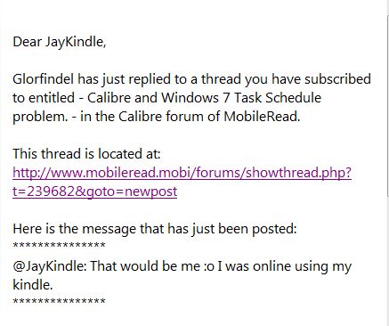

Originally Posted by Glorfindel View Post
@JayKindle: That would be me I was online using my kindle.
Yes, it was you. The last post you made in this thread caused me to get a link to the *.mobi version. (see screenshot)
I still think this is a bug if the forum. It's like a language feature. The end user should receive the notification according to their setting.
