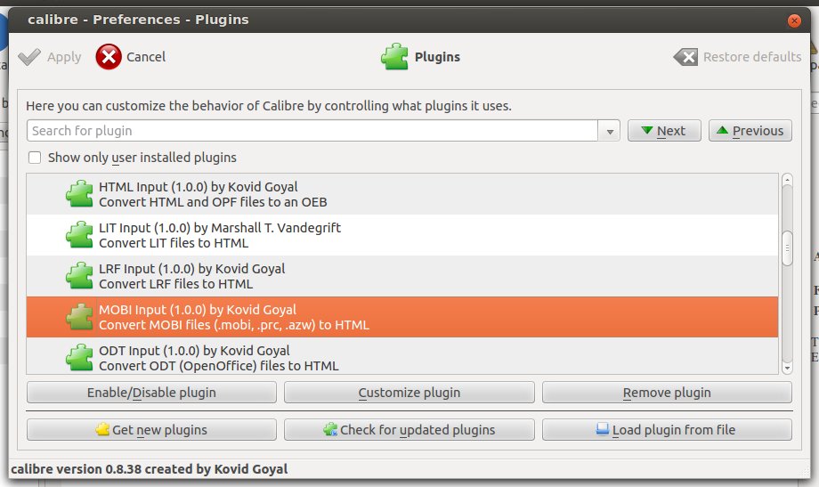

Actually I did took a look at Calibre, attracted by see picture... but I'm not on (sucking )python trip at the moment: I'm on c++/qt thing now.
Quite understandable.
