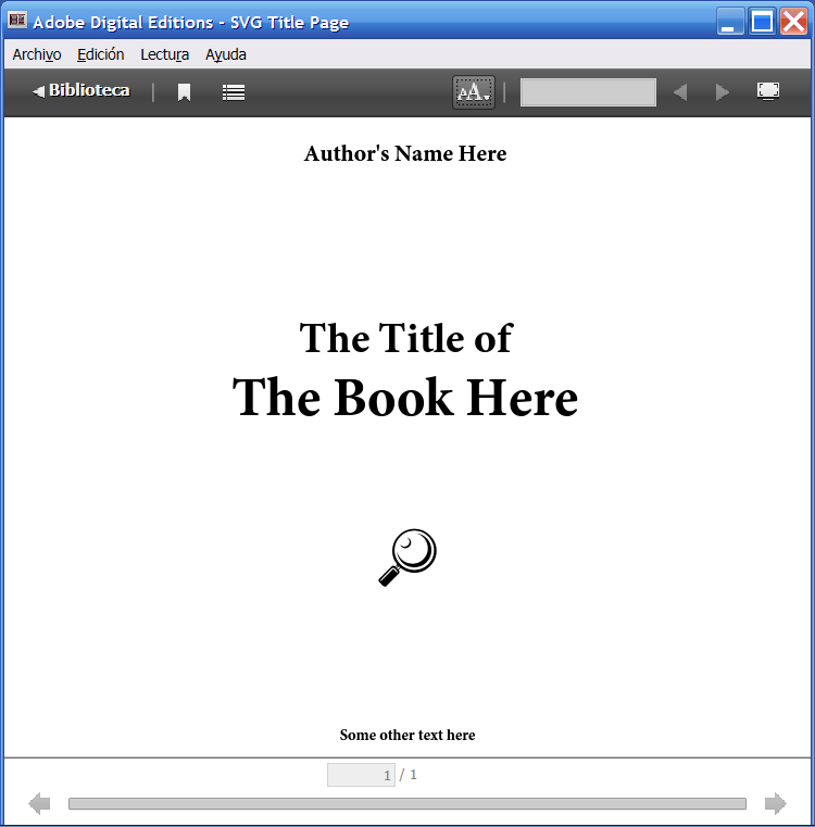

No, no, no... You don't understand me. I don't mean a svg image based on a traced bitmap, but TEXT INSIDE A SVG WRAPPER. It's text, but its behaviours is like an image (with the advantage of a svg image). It's very light (because is only text but with the format you want). If I have a bit of time, I will post an example so all of you will be able to understand better what I want to say.
EDIT: This is what I want to say. Open the epub below in ADE; you will see something like:
Try to change the ADE font size; what happens? Nothing (because the title page is an image). And now try to change the size of the ADE windows; what happens? The title page adapts to its new windows size As you can see, you have the advantage of working with text and the advantage of working with images, all in one thing. And with only 4.2Kb (the whole epub).
Of course, I'm working with a "viewBox" for the svg wrapper of 800x600; you can change that as you wish. But in that case, you'll have to set new values for the "x" and "y" variables to position the text.

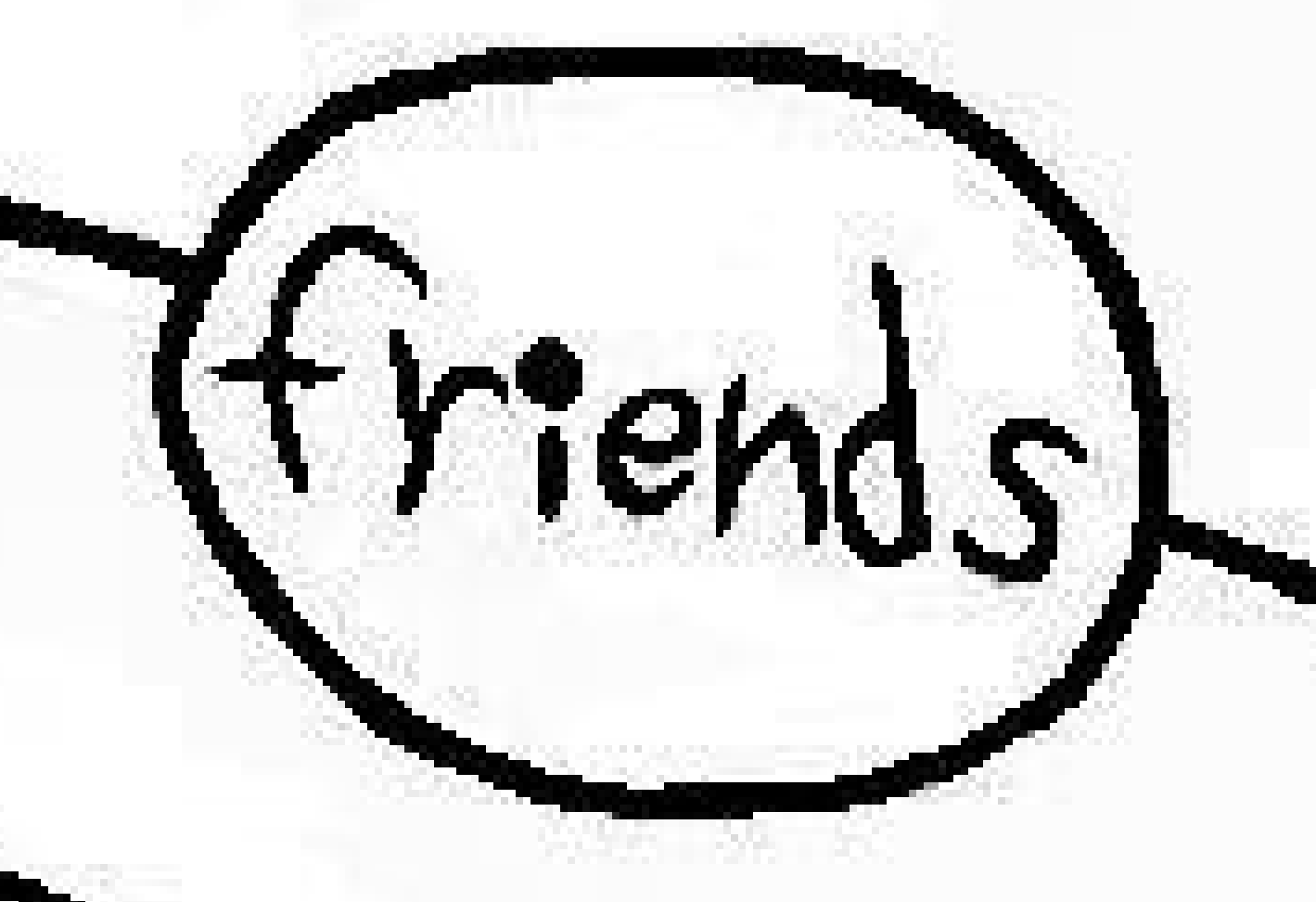

Originally Posted by JLius View Post
And what's the benefit of png/gif images? The titlepages are black&white, only one letter has a color. No images, only text.
Long story short,
JPG = Lossy format
GIF/PNG = Lossless format
JPG compression was designed for "natural" images (photographs). It does HORRIBLY on "artificial" images (charts, graphs, text).
Here is a tiny portion of a real-life book I just worked on. (This is an extremely good example to show off just how much better PNG is in these cases).
You can clearly see the JPG Haloing which occurs around the text/lines:
Because of the JPG algorithm, instead of being Black + White, you get Black + White + various shades of gray speckles buffering the lines.

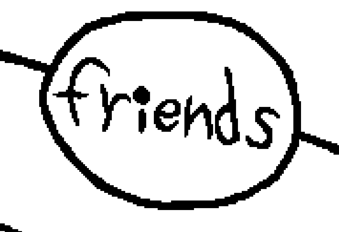

Here is the same image saved as PNG:
As you can see, there is actually only Black + White, and NOTHING else. Zero loss/deterioration from the original.
