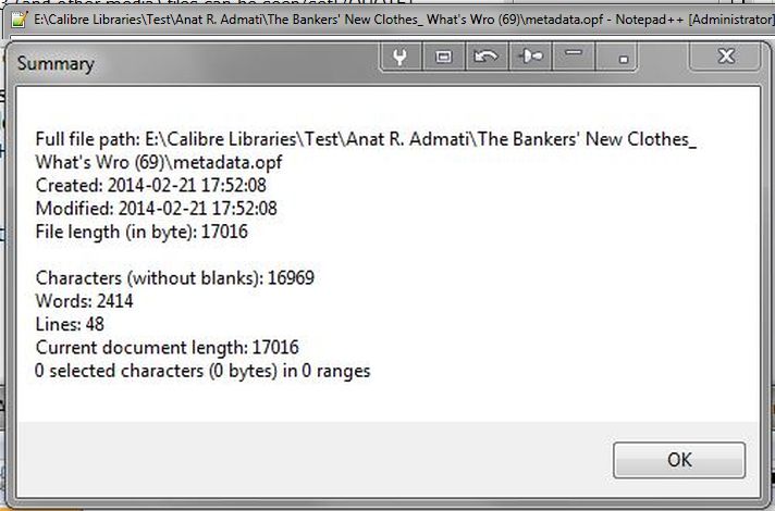

One of the things I've noticed about the editor is that I can't easily determine the path of the file that its editing - a Properties/Summary option in File would be nice. Sigil doesn't have it either, however it's Save As option assumes same location as the file under edit.
Having a 'Properties' under File would be the place that was consistent with Windows . BTW THis also is the place where metadata for MP3 (and other media) files can be seen/set
Old 02-22-2014, 06:52 PM   #17
Posts: 22,870
Karma: 34252730
Hmmmm, maybe I'd settle for something similar to np++, put path in Title bar and/or in a simple popup a'la it's View->Summary option.
Having File->Properties might make people think its yet another metadata editor, a'la Word & PDF XChange.
