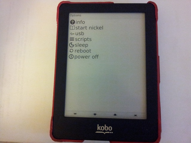

Ciao Tshering, Thank you for your work,not solved the problem with the microSD , even trying with another one. 've Read your last post, the start menu on my Glo look different, as you can see in the picture.Maybe should I reinstall KoboStartMenù?

@Cesco: I think your start menu looks different, because you have not installed koreader or vlasovsoftlauncher. If you do, the menu will automagically add them to the menu.
Another trick might help with the microSD. After my microSD had mounted several times without problems, suddenly it seemed not to work anymore. So I startet nickel, then closed nickel with the exit_nickel symbol in the library and tried again. This time the micro SD would mount without problems.
Maybe it works for you too. Good Luck!

@Cesco,
As already said by trekk (thank you again), the exact look of the main menu depends on whether you have installed Koreader, a version of KoboLauncher, or whether an update file is waiting in .kobo. Your installation seems to be ok.
As for the problem with the external sd, I don't know why it is not being recognized. Actually, I don't know much about linux, and even less about the auto plug system. Until now, I did not get to the point that my external SD was not recognized, so it is difficult for me to search for the failure. You can find some system information on "scripts>show info>show mount.sh" and "scripts>show info>show fdisk.sh." If you run these scripts, once with removed sd and once with inserted sd, maybe you can detect something.

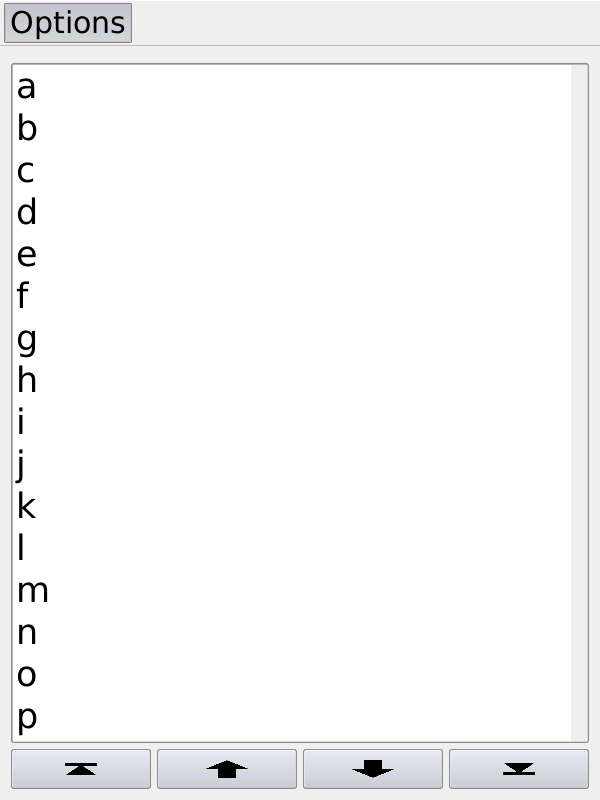

I would like to see the Start Menu work on the Aura HD too. Unfortunately, I cannot do any testing myself. So if anybody would like to help, I have prepared a small update file for testing purposes. It requires that the Start Menu package (see post #1) is already installed on the device. Maybe Ken is currently the only one who is running the Start Menu on an Aura HD. I can also provide a new package that already contains the updated files, if anybody wishes so.
Based on the observations of trekk and Ken, I am entertaining the maybe childish idea, that, on the Aura HD, the first call of the menu application results in a disoriented display, and with any further call the orientation is correct. I guess, it took trekk and Ken some time to poke the right place on the bottom-up display in order to trigger a second call to the application. Therefore, time might also have an impact.
I order to verify this idea and see whether we can use it, I would like to invite you to conduct the following experiment.
  • download TestForAuraHD.zip
  • extract KoboRoot.tgz and copy it to .kobo of the device
  • if you see the "handle update" entry in the main menu, select it and choose "install update"
After the automatic reboot, you should see something like the image below, however flipped by 180°. Don't try to select an entry. Wait 10 seconds until the application exits by itself. Next appears the main menu. This time with correctly oriented display, or so I hope.
A) If up to this point things went according to wish, you can try to decrease the waiting time.
In the file .kobo\kbmemu\usersettings.txt change
firstautoselectafter=10
to
firstautoselectafter=0
and reboot.
If next you see the main menu with correct orientation, we can rejoice. If not, you might try some other values between 0 and 10.
B) If however things did not go according to wish, we might try to increase the waiting time in .kobo\kbmemu\usersettings.txt
If this also does not yield the wished for result, we could try another thing. Maybe user interaction is needed, after all.
C) After reboot, select any item of the a b c d ... menu before timeout. This should not be too difficult, since anywhere you poke on the screen, apart from the small top and bottom area, should be a good place.
Please report your results here.

OK; I'll give it a try. [I'll edit-in my results.]
Everything went as expected, will try A) next.
Tried "0", and for two "Reboot"s from the menu and a powercycle with the switch it works, with the display correct.

I tried A) with "0" and it seemed to work. A reboot gave me the start menu with correct orientation, so I can confirm Ken's results.
But, if I start nickel and exit nickel with nickel_exit from the library, the orientation of the start menu is flipped again! Powering off from the menu again changes the orientation to the correct position.
C) Tapping anywhere flips the screen and shows the start menu in correct orientation.
Thank you for testing. Maybe we should also insert a warm up phase after returning from nickel.
