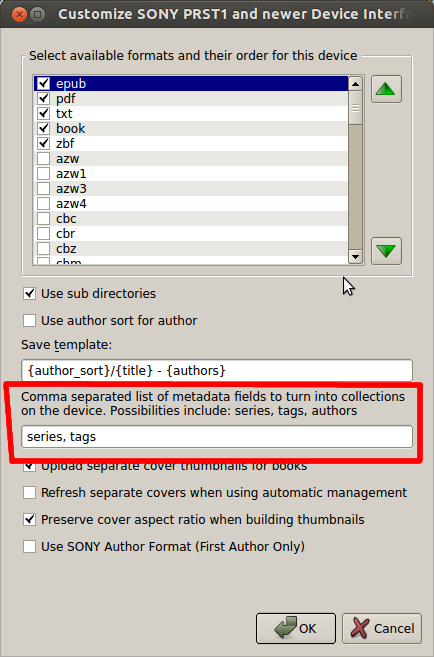

Just edit the Device Interface plugin for the Sony. While the device is connected to calibre, click the dropdown under the Device Icon, and select to customize the device. You will get the popup according to the screenshot I attached. Take note of the bit in red -- clear that field, and it should no longer create collections.
I cheated to get this popup, as I don't have a Sony -- I went to Preferences ==> Advanced => Plugins. The Sony plugin is under Device Interface plugins ==> "Sony PRST1 and newer Device Interface", or "Sony Device Interface" for devices older than the PRST1. Or just search "sony" in the plugin search bar.

@ eschwartz - many thanks. I've done as you suggested, so will continue to use Calibre to transfer my books to my Sony
As ever, I am continually amazed by how brilliant Calibre is, even if I have to rely on you to tell me how to get it to do what I want it to do at times!
