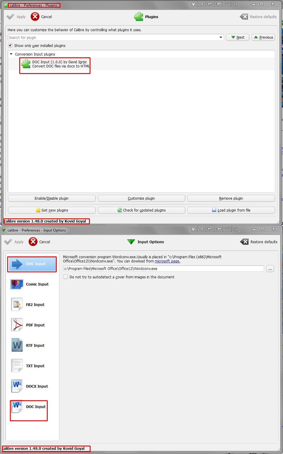

Originally Posted by rebl View Post
But a problem still persists- the usefulness of the select location / browse for file dialogue.
I've manally copied the wordconv.exe to a different path, just to test, and the behavior is the same as noticed yesterday with the older version of the plugin: the dialogue allows me to select a different location, it correctly lists the location in the textbox (and also allows me to manually edit/input the path) but after applying it actually does not save the change and the default path is still there.
That behaviour is in the Preferences / input / doc dialogue and not in the Settings of the Conversion dialogue. The two dialogues are very similar, but one is in the Preferences and should set the .. well.. preference forever, while the other one is in the convert dialoge and I suppose is a temporary setting valid for the active conversion.
I've had another look at this. For some reason, in the preferences dialog, the "DOC Input" is listed twice as the first and last items. If I try to change path using the first one, I see what you describe. But, if I use the second one, it works correctly. I don't know if this is something others are seeing, or just something weird on my system.
I also found an issue with the file selection in calibre v2. There was an error when you cancelled the file selection. And possibly when selecting the file. This version will work with both v1.48 and v2.

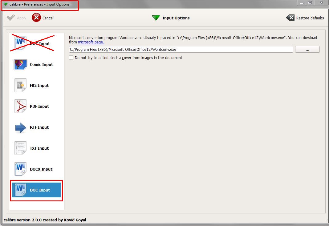

L.E. On my 64 bit win7 system I can't change the path in the preferences/input.
I've even installed fileformatconverters, and now I have two wordconv.exe files (they have same size).
Since this is a 64 bit sytem, the location for 32-bit programs is Program Files (x86) and the location of wordconv.exe is:
C:\Program Files (x86)\Microsoft Office\Office12\wordconv.exe
But the plugin keeps changing it to C:\Program Files\Microsoft Office\Office12\wordconv.exe
Does it matter I'm running calibre64 but the wordconv is 32bit?

Update:
I've tried performing the conversion for a single file, this time modifying the path to any of the two locations of wordconv.exe in Program Files x86:
C:\Program Files (x86)\Microsoft Office\Office14\wordconv.exe
and
Both of them worked.
Maybe wordconv.exe requires some kind of registration like when registering controls or dlls? Anyway it doesn't seem to like being run from a different location that the one it was installed to.
So I guess the solution would be to be able indeed to specify a different path in Preferences/Input. Currently, after browsing to the new location, the path appears in the filed but after applying changes it is not saved.

David,
The version I installed was the one in post #20
I just double checked, I changed it in Preferences to "...Program Files (86)\Microsoft Office\..." I then went to another book and it was showing "...Program Files\Microsoft Office\... Just to be sure I clicked Restore Defaults, nothing changed. So I went to Preferences and it was the same there - "...Program Files\Microsoft Office\..."
Where is the default setting saved ? As far as I see when I change the default nothing is written in the %CALIBRE_CONFIG_DATA%\calibre\plugins, the %CALIBRE_CONFIG_DATA%\calibre directories, nor in the relevant metadata.db.
If I change the path on an individual book then then metadata.db is updated and when I go back to that book the correct path is there.
Bottom line - the path sticks if its changed at the book level, it doesn't stick if the default is changed
I see it twice, I didn't notice the one at the bottom of the list (it was out of sight because of window size), but when I change it there it seems to stick.
It would be good to get rid of that extra item in Preferences, especially as the spurious item is the one at the top of the list.
And where are the PI's preferences written - should there not be a DOCX Input.json file in the plugins folder?
@David - I'm going to install the version from post#1 into portable 1.48, I'll let you know what happens. I have a 'gut' feeling this might be an old problem.
@rebl - see first screen shot, when I changed the one at the bottom, the path to wordconv.exe seemed to persist.
Added - @David - I see DOC Input twice with original PI on 1.48 - same problems too. See 2nd attachment.

@rebl - see screen shot, when I changed the one at the bottom, it seems to persist.
It's good to hear that the duplicate entry problem isn't just me. When I noticed it the other day, I couldn't see why. I'll have another look.
